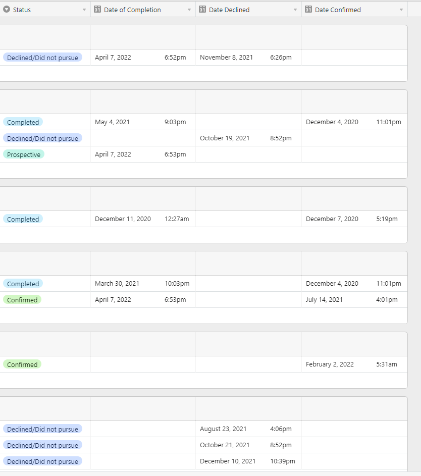

I have a Projects table and the following fields:
Status: a single select field that is either Confirmed, Completed, Prospective, or Declined/Did not pursue
3 Date fields for recording when the single select field changes to Confirmed, Completed, or Declined/Did not Pursue. Each with historical data I don’t want to lose.
