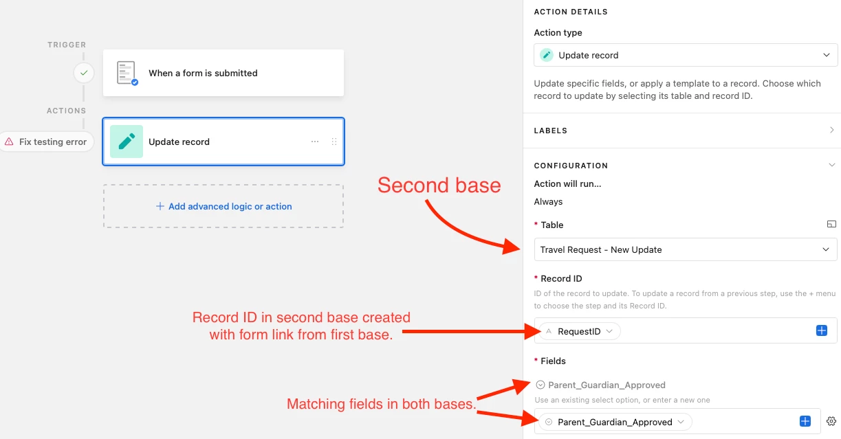

I need external parties to update existing records. I have successfully created a second base that serves as the receiver of the updated fields. I accomplished that by creating a form in the second base and using the URL from the form to create a formula field in the first base that will pass a record identifier to the second base. The URL works well and the record identifier from the first base shows up in the new record (RequestID) in the second base to match the record being updated from the first base.
My problem seems to be with the automation. I am using when the form, from the second base, is submitted to trigger the automation. I then added update record to the automation. Based on a video covering the topic by Julian Post, I list the second table called New Update as the Table in the configuration. I list RequestID from the second table as the Record ID. For testing purposes, I add just one field in the Field section. I set it to dynamic and map the corresponding field with the same name and parameters. (I started by duplicating the first base, so I know the fields are exactly the same.)
When I test the automation, I get "Received invalid inputs". Data exists in the second table and the Input data listed at the bottom of the automation page shows correct information to be replicated to the first base.  I have read articles and watched a few videos yet I remain stumped. Any guidance someone can provide would be appreciated.

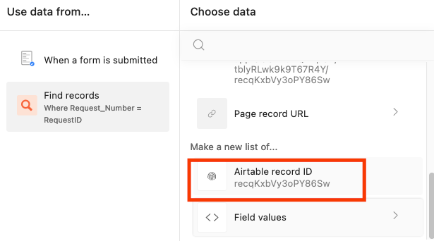

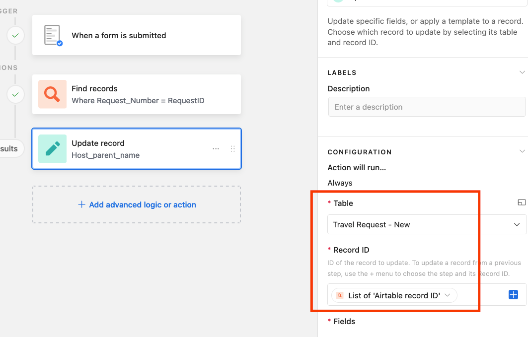

Thanks for the link!  I can see you're experimenting with the Find Record action and you're actually really close!   You just need to change the table you're updating to be "New" instead of "New Update" and update the "Record ID" to look like this:
To do that, select it here:
Should do what you need
I've also set it up here for you to try out

It's difficult to help you with this without seeing the base itself I'm afraid, so if you could provide a read-only invite link to a duplicated copy of your base with some example data or no data in it that would be very helpful.  You mention "a second base" as well and I'm not sure how that fits in to this, could I confirm you're using a single base?
There are two tables, not two bases. I apologize for the incorrect representation.

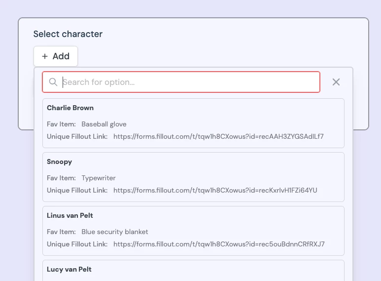

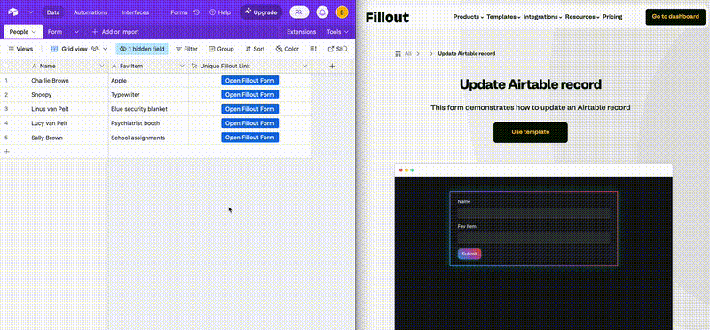

Hey!
Just wanted to expand on Scott’s answer with a Fillout example:
In the example above, I am able to quickly update Charlie Brown’s favorite item by clicking on a unique Fillout link and editing the the item from “Apple” to “Baseball glove”.
In Fillout, it’s easy to create a form that updates existing records in your table. There’s no need to create a separate table to collect form responses.
If you hate the idea of having to use unique Fillout links for each record, you can always create a separate form that allows users to select a record first, then connect the 2 forms together! They come together very well and works like magic. (Note: connecting 2 forms together is a paid feature.)
