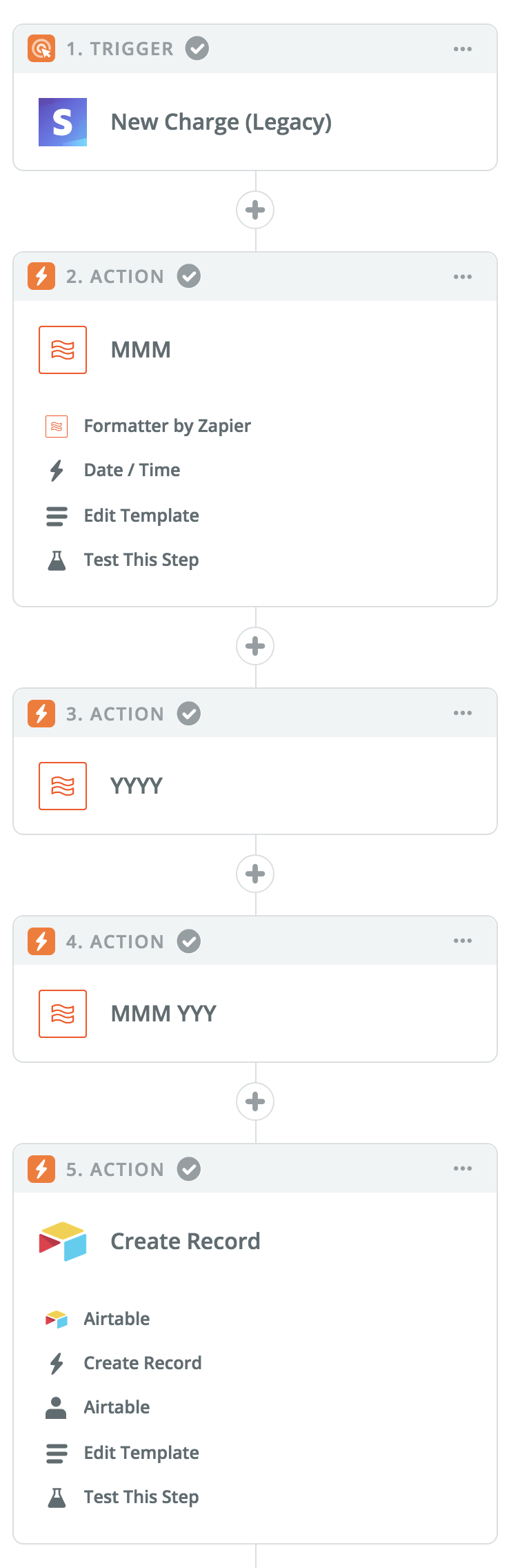

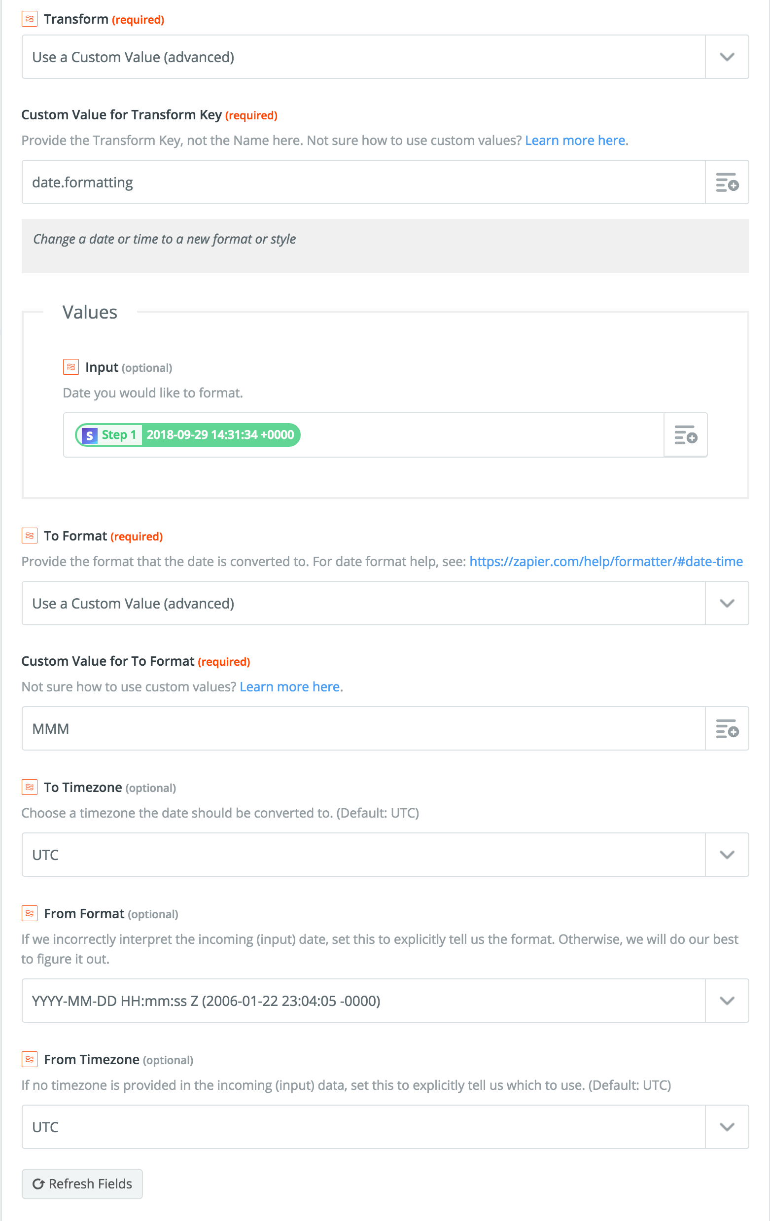

For anyone following along at home, I figured out the Zap and wanted to share it with you.
This is a 5 step sequence (which means you need a paid Zapier account, apparently) and it looks like this…
And then each date formatting template looks like this…
I’ve tested it and it works. Formats the dates perfectly.
Hope this helps.

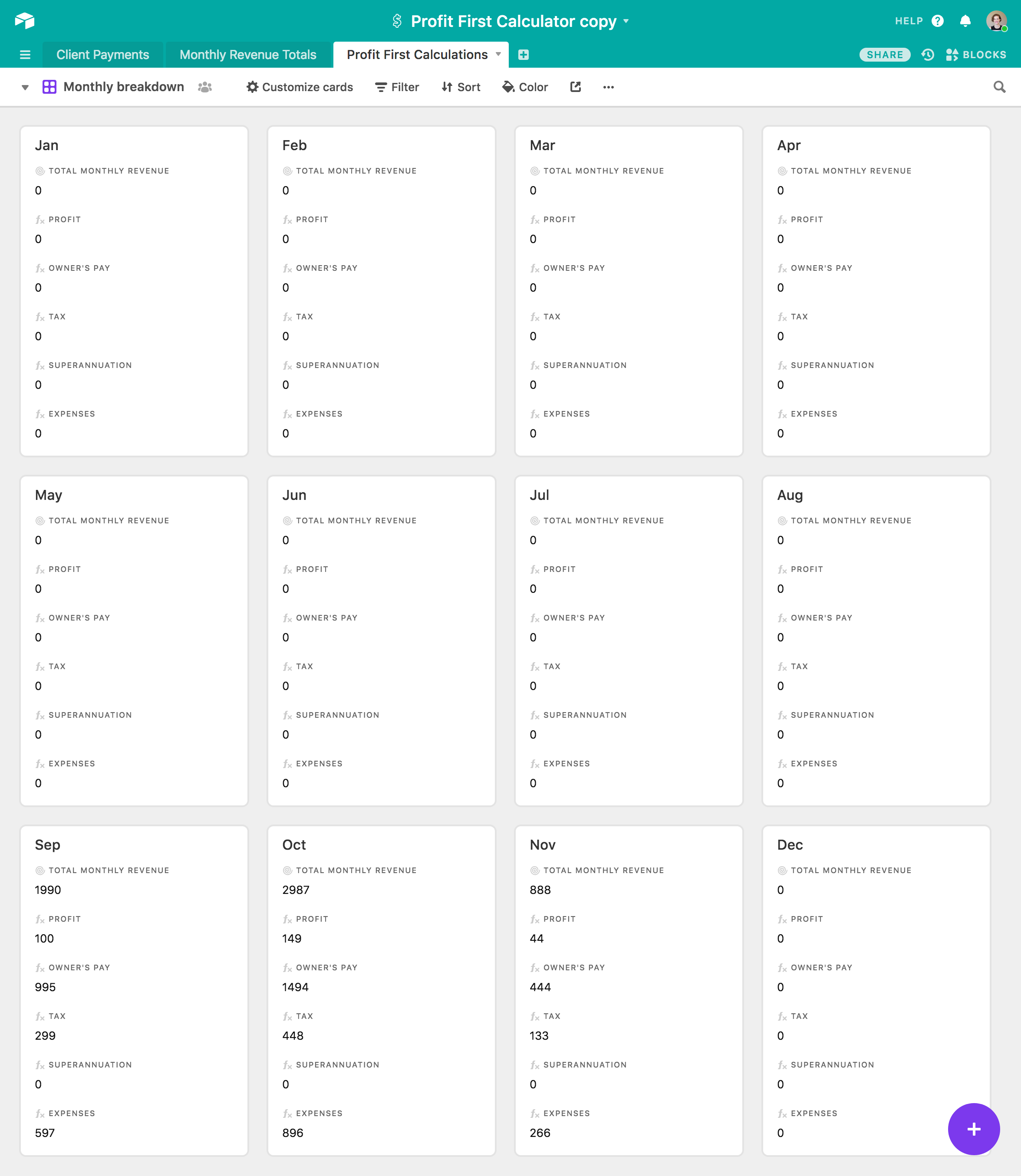

Hi Alyssa (another Alyssa here),
I originally came to this thread looking to answer the question about how to label by month, but in looking at your base, I’m now curious how you formatted the cards in your gallery view. How did you get them to show up as month by month, and to tally your metrics for each month?
Thanks!
A
Thanks!
A
I’m honestly not sure I remember, because I’ve tried and failed to duplicate it in other bases. But what I think I did is…
I created the Profit First Calculations tab and had to make sure the first column was “month, year.” (Then I could use that to link to other records too.)
But in the Profit First Calculations tab, I also had to create a column that I labelled “Year.” Finally, I created a Gallery view for 2019 and filtered by the “year.”
