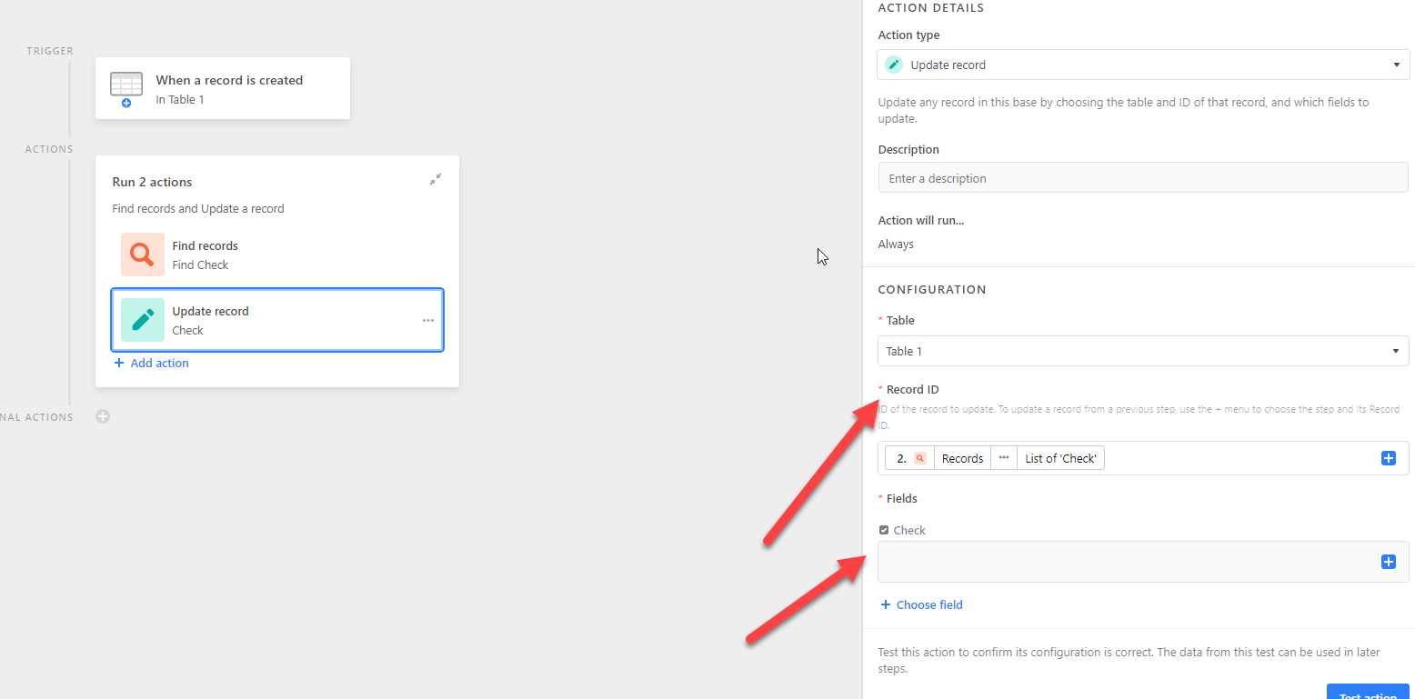

I’m stuck on the Automation. Where do I tell it I want to uncheck the check? In the attached image I’ve tried entering false and 0 in the “Fields” field.

Have you tried with FALSE, FALSE(), or just leaving it blank?

I’ve tested it and worked with false.
