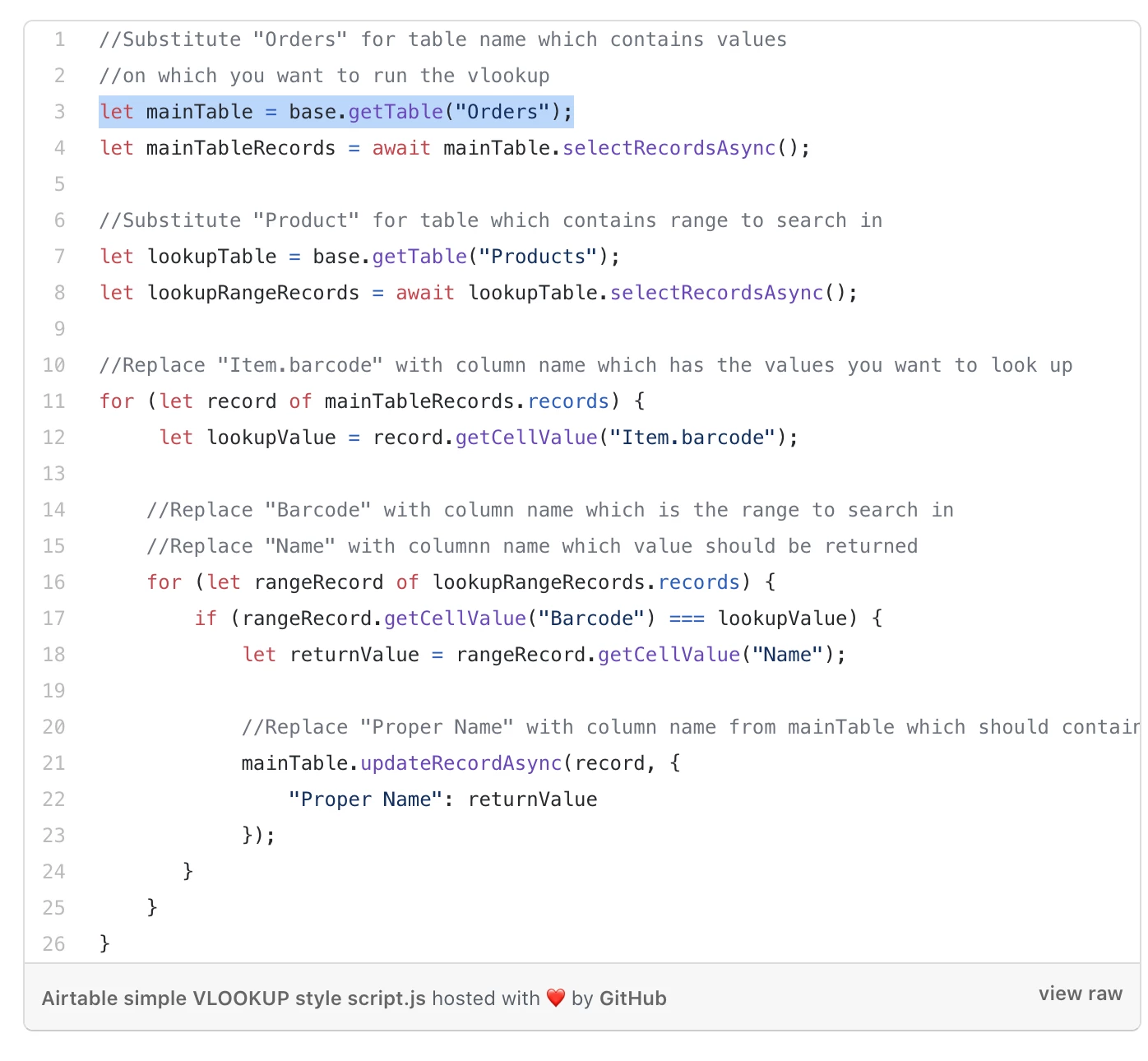

This was something that I was looking for as well as I needed to do quite a bit of matching between my tables - that were previously using VLOOKUP in Excel. This did not seem to be possible with regular Airtable functions (and I tried a lot of crazy stuff), so I started looking into the Scripting block.
This actually allowed me to make a perfect solution. OK, almost perfect, you still need to change the name of tables and columns manually in the code, but with comments below this should be fairly straight forward.
I have also made a quick video about it:
I hope that helps!

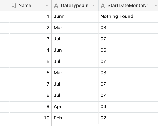

Another question: how could you define a fallback value (could be a static one “not matched!”) in case that there was no match with the values in the lookup table?

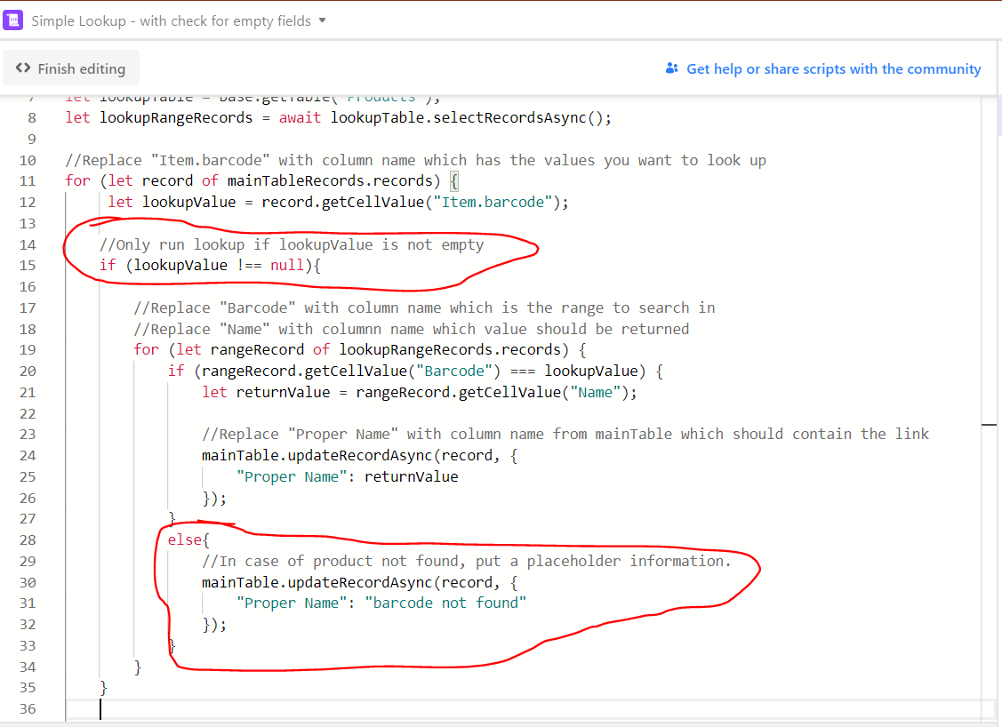

I think both cases can be solved with help of "if"conditions. First one checking if the original column/field is empty (in case you have many empty values there). Second case already has a condition that executed when value is found, so it needs to be completed with else statement to execute action if case of not matching values.
Something like this:

Hi, - this is great & solves the setting of the “else” value!
The first check if not empty => basically does only what is says (gatekeeper for valid values) - but it does not solve the target:
use the value in the fields to look up.
Or maybe its me having a bug?:
=> Use outcome in formula field in another formula field

I think it is defined at lines 3. 7, 12, and 17.

Thanks, this is great! I think you need to add await to the
await mainTable.updateRecordAsync(record, {
line, I was having trouble in a slightly larger table of it just updating some records.
Yes! Thank you for noticing that! I have corrected the gist.
