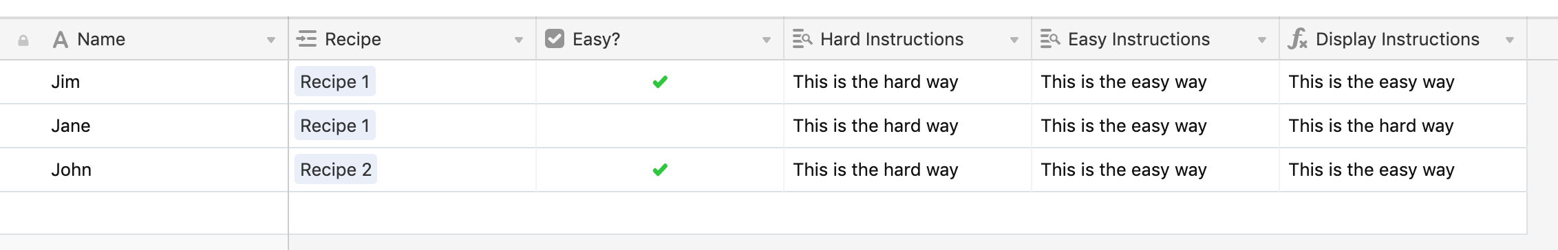

Hi @Airtabling - this is the way I would do this:
So Recipe is a linked records to your recipes table. And Easy is a checkbox, as you describe. Then have two lookup fields - one for the hard instructions and one for the easy instructions. Finally, you have a formula field for your display instructions with formula:
IF({Easy?}, {Easy Instructions}, {Hard Instructions})

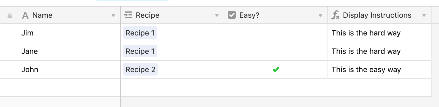

The finishing touch is to hide the two instruction lookup fields:

Absolutely perfect. Thanks for taking the time to help, JB!
