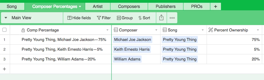

I suspect that one answer to your question is to treat the intersection of composers and percentages as line items. (If you read our guide to many-to-many relationships, it can give you a better idea of how to use line items in Airtable.)
My suggestion would be to create another table for “Composer percentages,” so that each composer’s percentage of a given song is itself a record. So, setting up something like this (and using a formula in the primary field to automate record name creation):

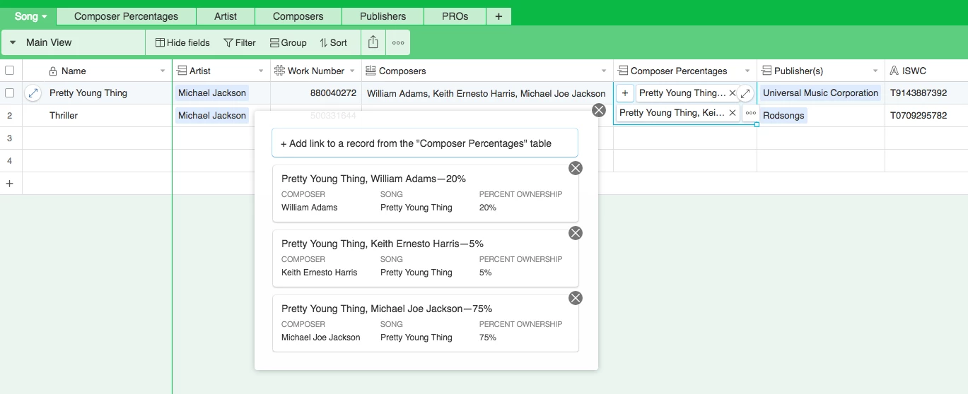

Then, in the song table, you have linked records representing each of the composer-percentages for each song.

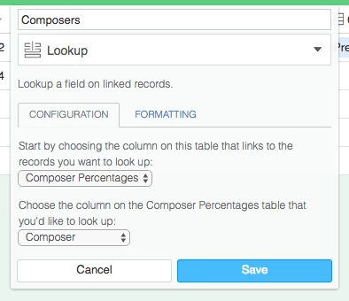

You can also put in a lookup field to pull just the vanilla information about the composers’ names, without any percentage information:
A potential drawback of this setup is that it takes two clicks through linked record fields to get to the composer data, rather than one (you need to click on the linked record line item, then on the composer link in the composer percentage line item). The upside of this is that you would have somewhere to put information on each composer’s contribution to a particular song.
Let me know if you need more explanation, or if you have any other questions.
  • October 6, 2016
Thank you! This does a pretty good job of laying out the data how I’d like. The majority of people will only be looking at a small selection of the data pool, and I will be one of the few using the junction table, so this could be a relatively practical solution.
