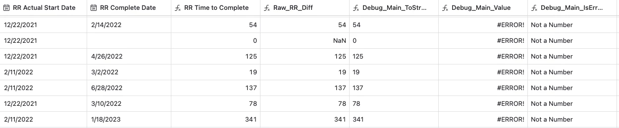

I then created a FORMULA field called {Debug_Main_Value} that contains this formula:
VALUE({RR Time to Complete}).
This is (or should be) converting the output from {RR Time to Complete} to a number. The output for all values (whether number or NaN) is #ERROR
Lastly, I created a FORMULA field called {Debug_Main_IsError_Value} that contains this formula:
IF(ISERROR(VALUE({RR Time to Complete})), “Not a Number”, “Is a Number”)
The outputs for this field are “Not a Number” no matter what the output is for {RR Time to Complete}.
I am at a loss for how to get Airtable to recognize the difference between the two dates as a number, and the issue does not seem specific to the blank cells, or zero, because Airtable is not recognizing ANY output in the {RR Time to Complete} field as a number.

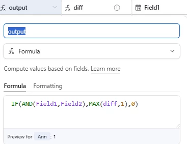

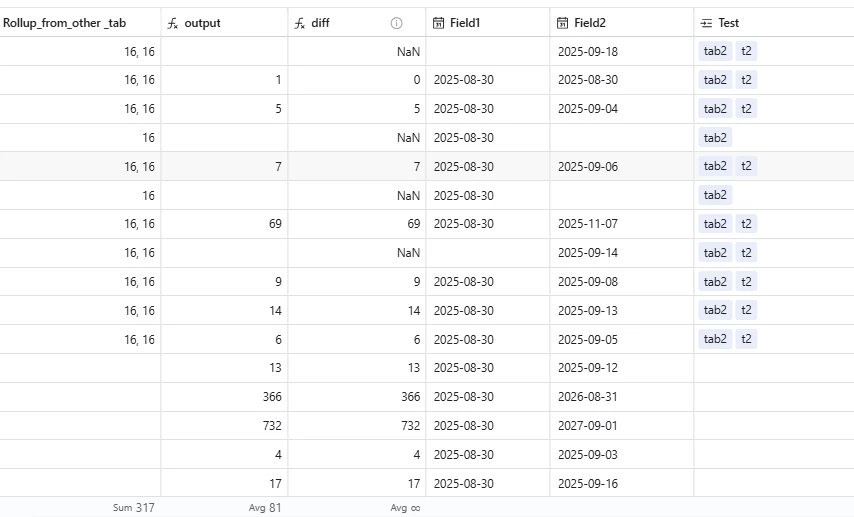

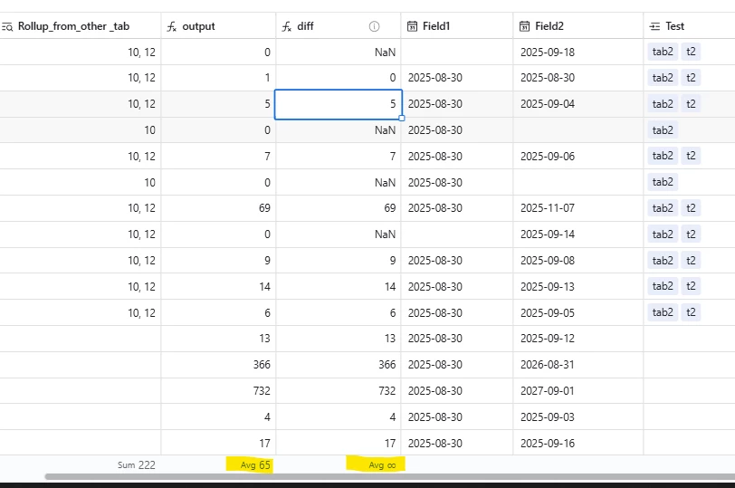

You have error because you are trying to convert Number to Number. VALUE requires String.
Btw, “The outputs for {Debug_Main_toString} are identical to {RR Time to Complete}.” - not exactly,  strings are left aligned.
I hope this helps you.
Check Average of the whole  {RR Time to Complete} column in the bottom totals line.
Your rollup should work, check if you are have correct field in Rollup settings. Maybe you put wrong column there.
Note you can put 0 or you can put nothing, both works, but nothing ignored when count average
I’ve shorten formula.
THIS IS ANOTHER WAY, PUT NOTHING IN OUTPUT where date(s) absent . I’m not sure which is correct for you

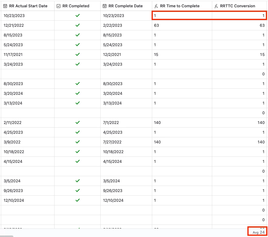

First, I added a “helper” column to my base called RR Completed. This is checking that RR Actual Start Date and RR Complete Date are both populated.
I placed this formula in RR Time to Complete: IF({RR Completed}=0, "", IF(DATETIME_DIFF({RR Complete Date}, {RR Actual Start Date}, 'days')<1, 1, DATETIME_DIFF({RR Complete Date}, {RR Actual Start Date}, 'days')))
This solves two problems for me. First, it got rid of the NaN values when either RR Actual Start Date or RR Complete Date are blank. Second, it gave me a value of 1 whenever RR Actual Start Date and RR Complete Date are the same date (otherwise, it was left blank, because the result is technically less than a day).

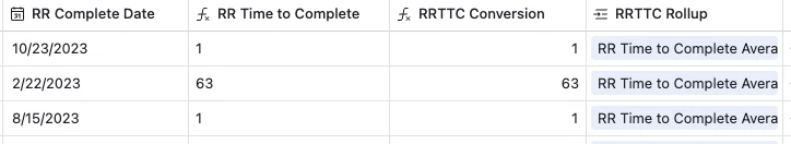

However, your tip about the left-aligned result was HUGE, because - viola - the result is definitely a string and not a number. So, I added another “helper” column called RRTC Conversion with the formula: VALUE({RR Time to Complete}), and I get a beautiful column of right-aligned, error-free numbers that I can average at the bottom:
One important thing to note, though, is that the RRTTC Conversion interprets the blanks in RR Time to Complete as zeroes, which is artificially depressing the average. The true average is 29 days.
Now … the rollup.
I added a Lookup column called RRTTC Rollup that links to a separate base called Summary
On the Summary base, I created a Rollup field, allowed linking to multiple records and added a filter to exclude any rows where RR Completed was not checked:
So my last question is this: do I have to manually add new rows to the RRTTC Rollup as their values become >0, or can that be done by a workflow?

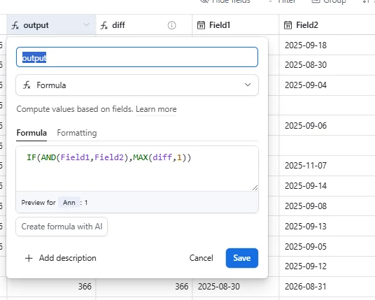

That’s exactly the reason why I described how to output empty values, which will be ignored when count Average. In previous comment, after
“THIS IS ANOTHER WAY, PUT NOTHING IN OUTPUT where date(s) absent”
You don’t need all this ‘over-engineering’ with helpers and conversions. Considering 2 problems above (and third with depressed average), your formula should be very simple and include only 2 fields: Start_Date and End_Date
In Airtable, you don’t need all those Excel stuff “If Field=BLANK() dispay “”, else display Output”. it’s just IF(Field,Output).
“IF x<1, display 1, else display x” is equal to MAX(x,1)
Version to copy-paste:
IF(AND({RR Actual Start Date}, {RR Complete Date}),
MAX(1,DATETIME_DIFF({RR Complete Date}, {RR Actual Start Date}, 'days')))
Note - my AVERAGE is lower because it doesn’t include data not seen on your screenshot but it’s true according to screenshot values. Depressed value (with ‘0’) is 17. In your table it will be 29.
About your last question - just include all without any filters and automations. Remove checkbox field and extra stuff. If it works in bottom line average, it will work in rollup, as planned.

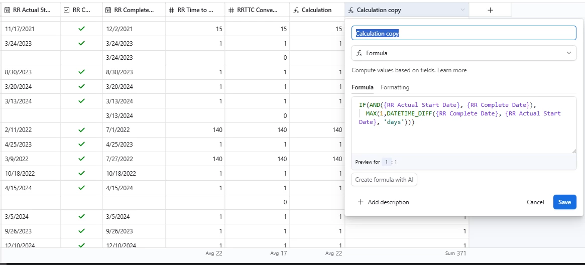

Danielle_A
  • Sep 3, 2025 2:46 PM UTC
​@Alexey_Gusev - THANK YOU AGAIN! The cut/paste worked perfect this time, the dashboard widget works, and this hugely reduces the complexity of my base. Much appreciated (and thank you for your patience and detail).
