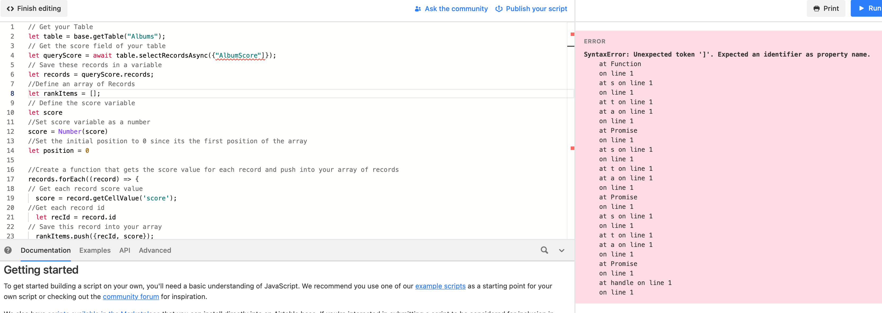

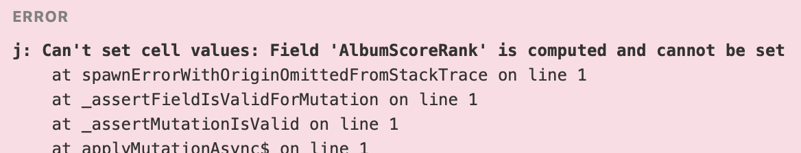

This looks awesome but I can’t get it to work. Should this basically be a cut and paste job while plugging in “table_name” and “score_field”? Or is there some other customization that needs to happen?
This is the error I’m getting:
Help?

Hi there… I’ve been trying to get this scipt to work but I am getting the following error:
Does this restrict the field type I can use?
