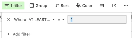

Wait a minute…“just 1 blank field”? Up until now you’ve been asking for a way to isolate records where there’s at least one blank, not just one blank. Big difference. Which do you want?
Based on the list of fields you want to check for blanks, I updated the formula. Here’s the revision.
AND(
    {SCOTT #},
    OR(
        NOT({STAMP DESCRIPTION}),
        NOT({SUBJECT}),
        NOT({DATE ISSUED}),
        NOT({STAMP FORMAT}),
        NOT({FACE VALUE}),
        NOT({KEYWORDS})
    OR(
        {LOCATION},
        {WEBSITES},
        {STAMP IMAGE},
        {MATCHED STAMPS},
        {STAMPS CHECKED}
As for the filter settings, there should only be one filter in the view:
Just be aware that this will show records with your original request of at least one blank field out of that list. If you want instead want records with just one blank, that will require a completely different formula to drive the filter.

Hi @Justin_Barrett
Sorry. My miss-type. I do want records with at least one blank field. Will your reply work for these records?
I figured out how to filter records with all blank fields.

It works in my tests, so I’m hoping it will meet your needs.
