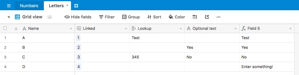

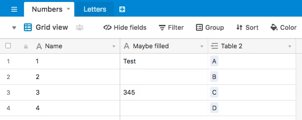

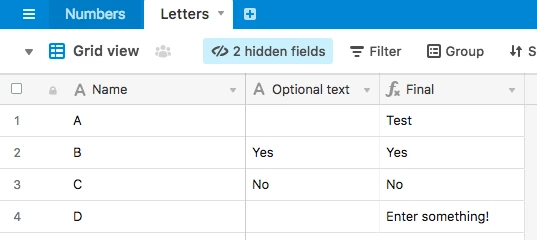

Screenshots:
Cleaner:
Formula:
IF({Optional}, {Optional}, IF(Lookup, Lookup, "Enter something!"))
