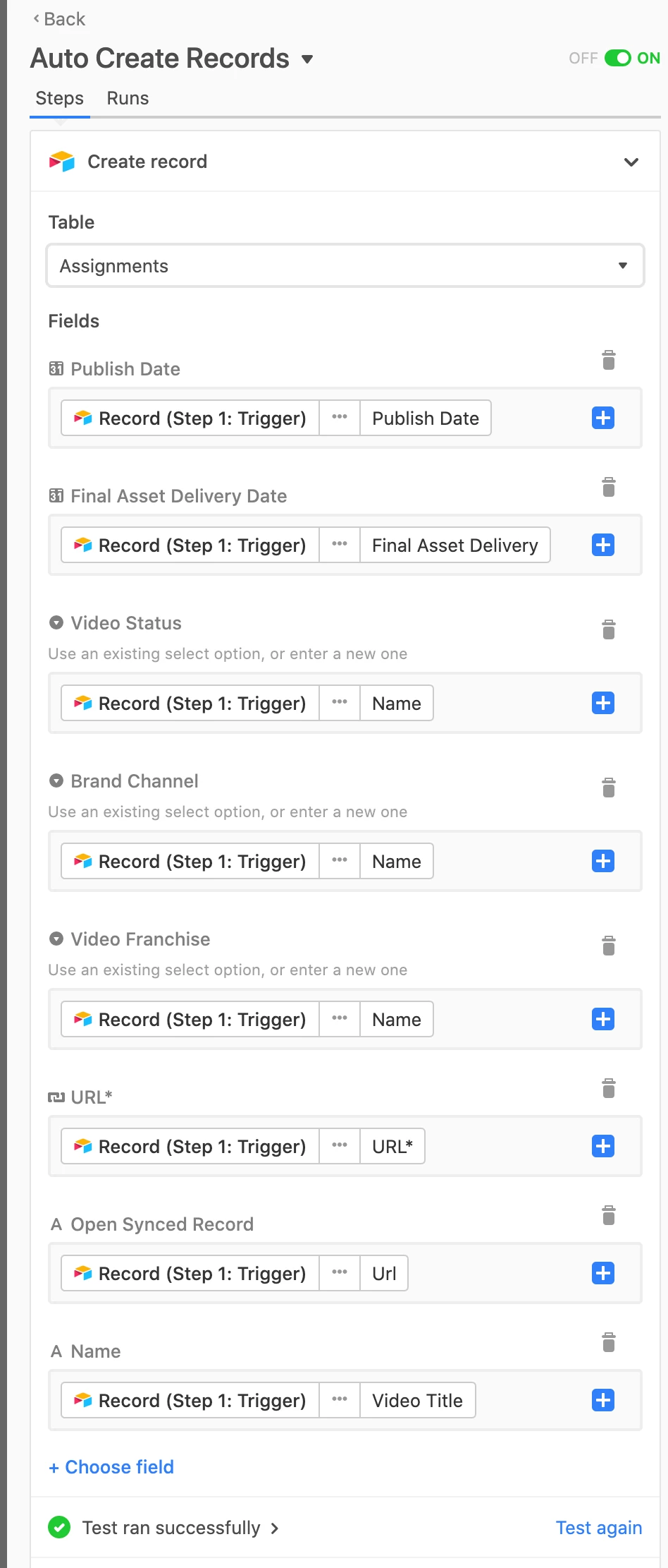

I currently have tables from multiple brands’ bases synced to my team’s base. Each sync table has the same 9 fields for uniformity. My ultimate goal is to consolidate the records from each of these sync tables into one table, so that I can assign date-specific tasks to my team. The easy part was getting this data into my table. I used the automation “When a record enters a view -> Create Record.”

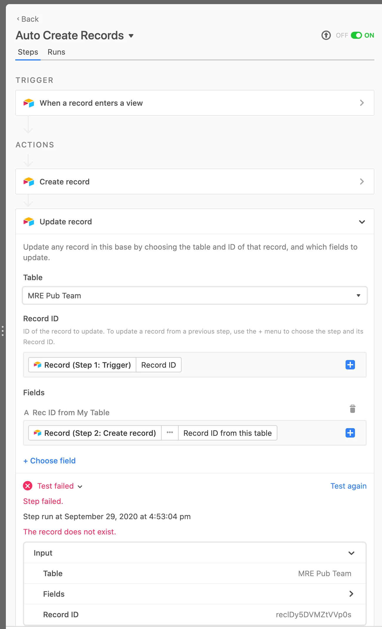

Hi Justin and Kuovonne. Thank you very much for your helpful suggestions. Both of your points make sense to me. However, I’ve hit a roadblock in that I can’t seem to get anything to work in my automation when I enter the mandatory Record ID field. I’m inputting something wrong and I’m getting a “The record doesn’t exist” reply when I test it. Here’s a screenshot of when I tried using the “update record” action as an add-on to my “create record” automation.
I’ve also tried the way I mentioned in the original post, using the following automation: “When a record is updated -> update record,” and it gives the same response. I’m not sure what my next step is, as I’ve looked up documentation about using the “update record” action and can’t find much.
My guess is that you didn’t test the “Create record” step before testing this “Update record” step. If you don’t test a step, it can’t pass data to any later step that requires it.
That said, testing each and every step isn’t required before turning on an automation. It can be beneficial because it helps you to find potential problem spots, but it’s not absolutely necessary. If you trust the logic of how you designed each step and the flow of data between the steps, you can turn it on and test the whole thing live.

Thanks for the reply, Justin.
The “Create Record” step has been working so far (see attached).
  • October 2, 2020
It looks like this is working now.
Trigger: When a Record enters a view: works
Action: Create record: works
Action: Update Record: now works
My error was that in the update record action, I was targeting Table A when I needed to Target Table B.
Also, the Record ID needed to be the record ID from step 1: the trigger (Table A). This is obvious now to me now, just took some trial and error to get there.

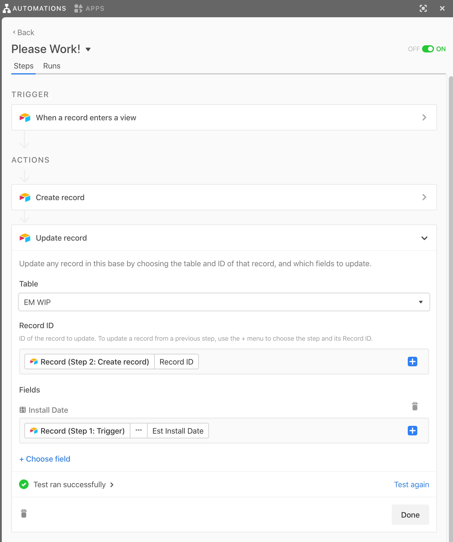

Hi All,
Thanks @Kyle_McKinnon
I am trying to do something similar. I must be missing something the obvious.
I am trying to get new records from my Synced Tables (Chris, Sam, Nick, Lucas, Etc) into the main table EM WIP. Which appears to be working in creating, however I would like it to also update in the EM WIP when any of those users update their own bases which im synced with…
