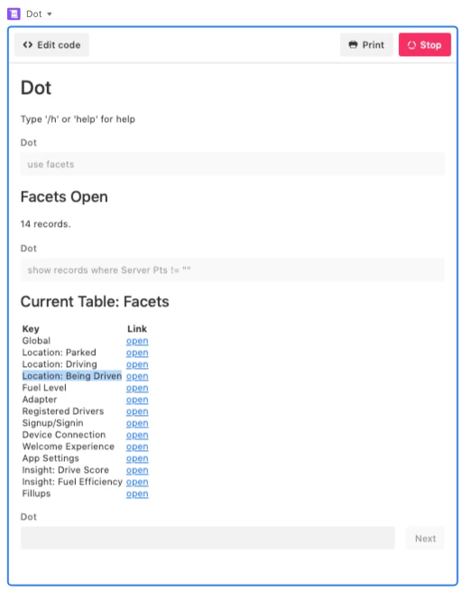

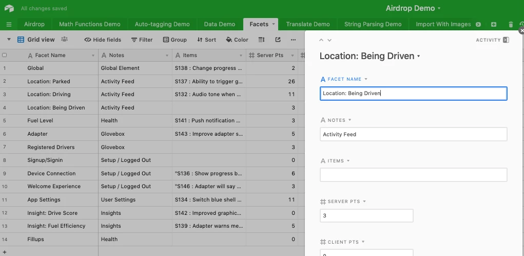

Yes, but to confirm, you want to list records in a Script Block and then access any of the records (in the record edit view) with a single click, right? If this is the requirement, I do it all the time -
One of the current drawbacks to this approach is that the markdown method in Script Blocks sanitizes all HTML (and DOM access) making it impossible to provide a clean UI that simply displays the record in context with the current browser tab. Markdown links can only open a new tab (boo…).

Okay - here’s a brief example that creates a list of records from a selected table where each item is linked to the record itself.
output.markdown('# Record Linking Example');
// select the table
let currentTable = await input.tableAsync('Select a table');
let queryResults = await currentTable.selectRecordsAsync();
let oRecords = queryResults.records;
// build the list
var recordList = "";
for (let record of oRecords)
  recordList += "- [" + record.name + "](" + currentTable.url + "/" + record.id + ")\n";
// render the list
output.markdown(recordList);
