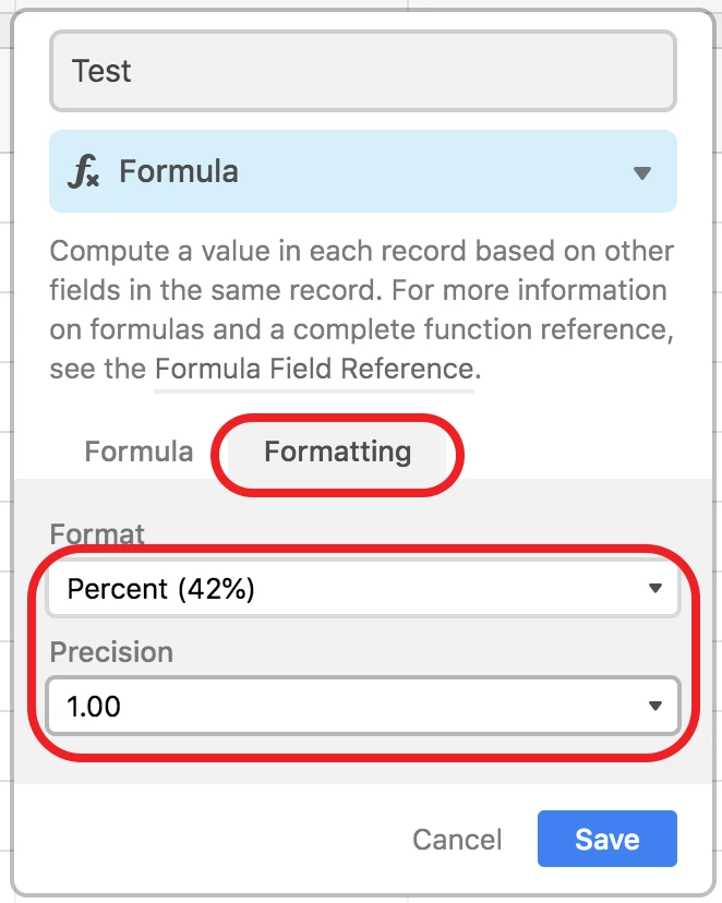

This might be due to your formatting not being set correctly. The field is displaying an integer value, so it’s rounding up to one when the true value is actually a decimal.
When editing the formula, there is another tab that a lot of people don’t see, called “Formatting”.
Set the formatting to a percentage (assuming that’s what you want for your profit margin?), and then you’ll have options to set the precision for decimal points.
One last suggestion I might make… is to add an IF() statement to your formula to catch errors. If {LIST PRICE} is empty, you’ll be dividing by 0, which will create problems.
Try this…
IF({LIST PRICE}, ({LIST PRICE} - (({PRINT} + {MOUNT} + {SHIP} + (TIME * 25))) / {LIST PRICE})
