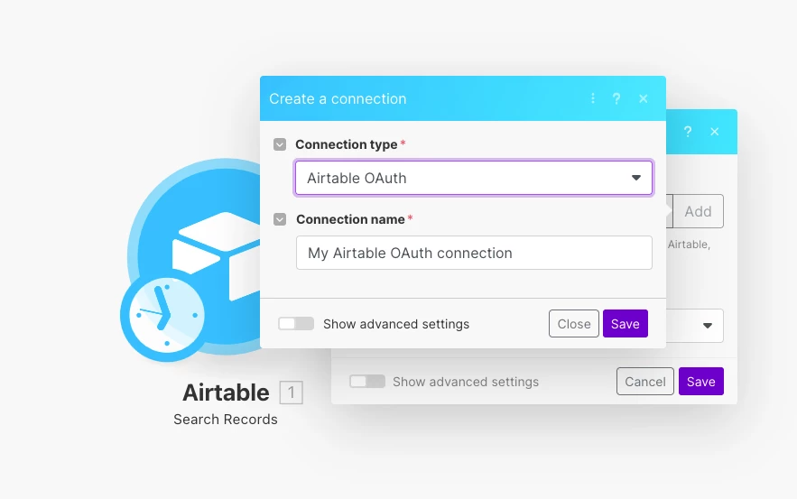

Hm, I don't think you need to do that when you're connecting Make to Airtable?  In Make, after selecting an Airtable module, you're presented with the option to add an OAuth connection, and once you click 'Add' this shows up:

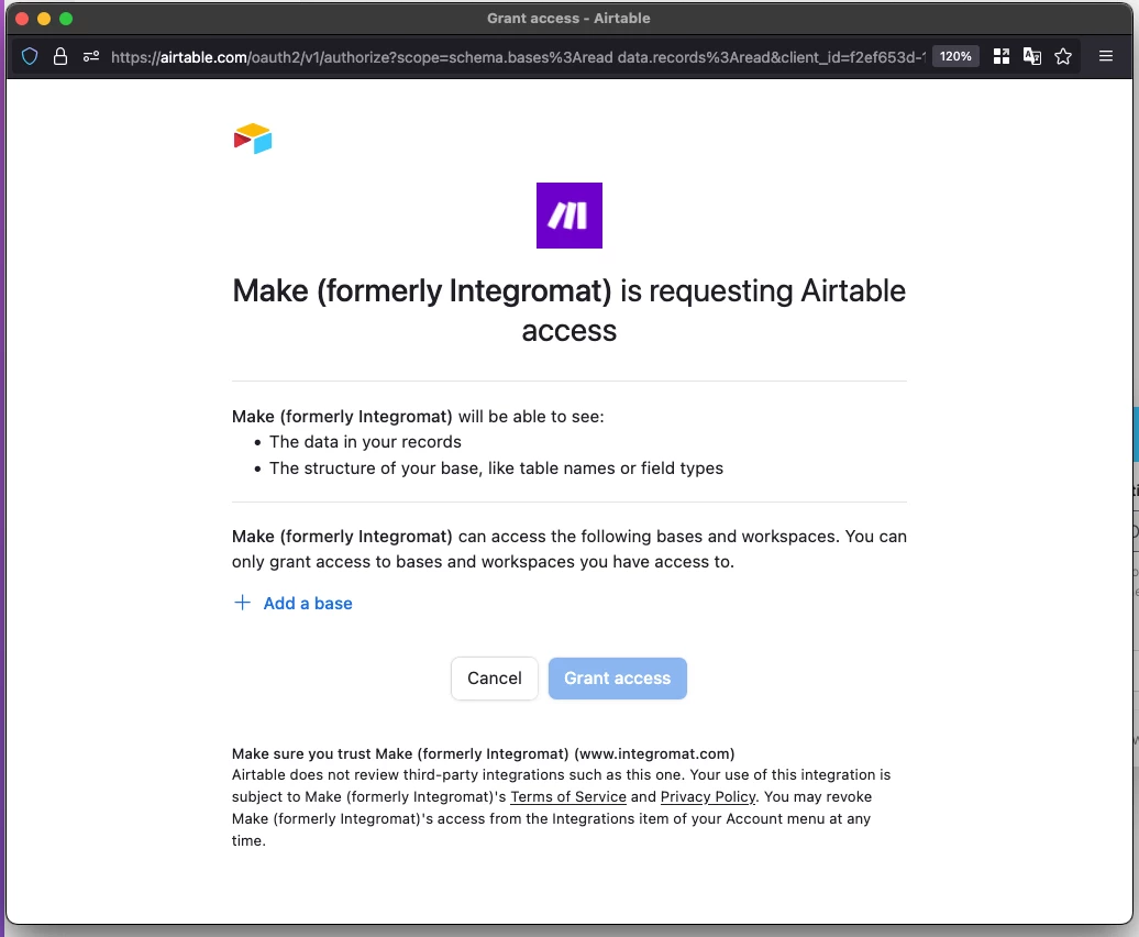

Click 'Save' then opens a popup where you're able to select which bases this OAuth connection should have access to:
And once that's done you'll be able to interact with that selected Base via Make

The URI thing actually was part of creating the connection in Airtable's builder hub. I was able to use an integromat URL, and then it worked great after that.  Thanks for the links. Though I did get some paypal data returned, it wasn't what I was hoping. I have to know the subscription id, and as part of my application, I have to get the application id's to check on their payments.  I'll see if perhaps I can use the paypal api with the airtable scripting.  Thanks Scott (and all others that replied).
