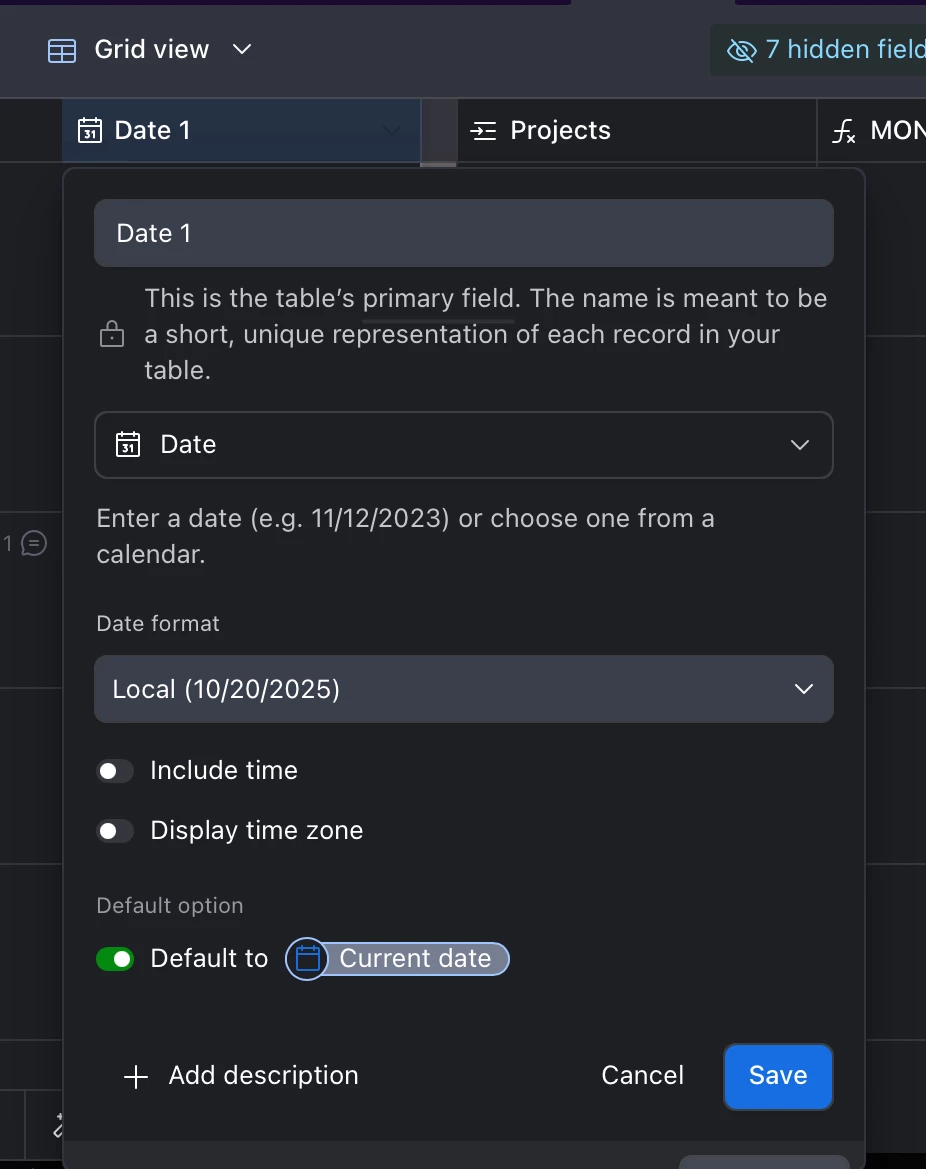

2025 Update:
For a while now — maybe the last 2 years? — Airtable has given us the ability to set the default date to TODAY directly from within the Date field’s settings.
See screenshot below.
