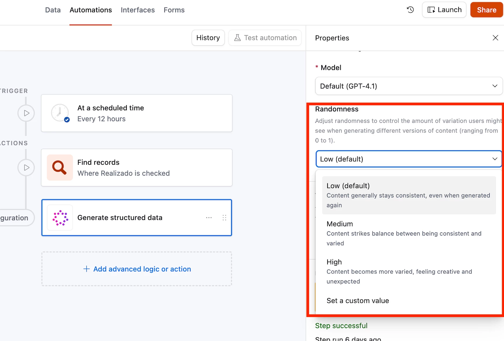

Creating a field agent to do a simple task. I want it to find some text in a document and copy it out. It’s doing great on the “finding” but being a bit too creative with the “copying”. Is there any way to set temperature for the model to 0?
Best answer by Mike_AutomaticN
Hey ​@nroshak,
I don’t see that as an option on field agents. However I guess you could still build a workaround to use both field agents and AI action blocks on automations, as the latter do allow for setting temperature. See image below.
Would that work?

Hey ​@nroshak,
Would that work?

Thanks ​@Mike_AutomaticN ! I thought I’d seen this option somewhere. I will switch to an automation to set temp to custom value of 0 and see how that goes.

​@ryanmr ​@Mike_AutomaticN  Unfortunately, turns out I can’t get an automation to work for this, since the Automations agent is not able to connect to Google Docs. Automations have a very limited ability to interact with Google Docs. The field agents can connect to Google Docs and read the file, but I can’t set the temperature directly (it seems).
I’ll mark this attempt to use Airtable AI to automate this task a failure for now. Thanks for your help!

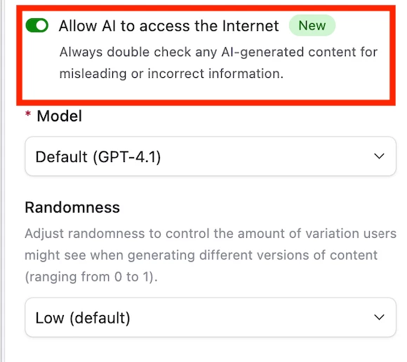

Ohhhhh ​@nroshak I’m super sorry to hear that.
I have one additional suggestion before sending the classic “you can still do this by building your own n8n/make automation” lol.
What if you enable internet access on the automation -see screenshot below, and you make sure (i) to share the drive url on the prompt, and (ii) such url is accessible publicly.
I guess it will NOT work, but it might make sense to give it a shot?

Hi Mike, that would probably work, but these particular files need to stay internal-only, not visible to the whole internet. But many thanks for your help! -Natalka
