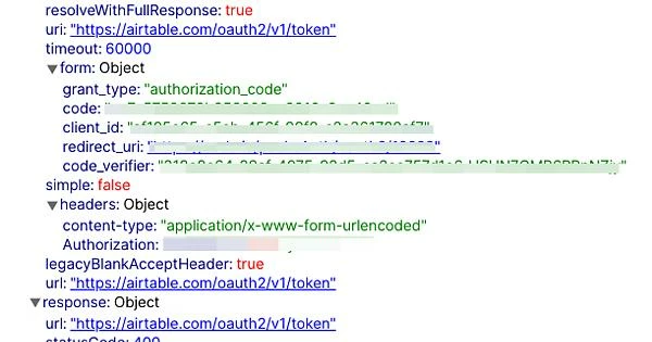

Thanks for the reply @Will_Powelson, this is the request with all the info, the only thing that comes to mind why it is failing is that code_challenge_method is required, can’t think of anything else.

Hi Lean, I can confirm that myself and other users are able to create tokens without code_challenge_method.
While I can’t diagnose your problem without access to your client_id (not that I’m asking you to post it publicly) a few possibilities come to mind:
  1. it is possible you are running into a bug I am currently chasing down.
  2. The redirect_uri you’re providing does not exactly match the one used in the authorization request
  3. Your code_verifier may be incorrect
  4. You may have accidentally altered the code you received
  5. You are waiting 10 minutes or more after authorizing to make this request

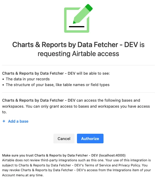

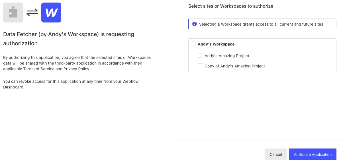

Hey,
Firstly, awesome work on all these changes, especially webhooks!
Some feedback on the OAuth consent screen: it’s very easy to miss the small ‘Add a base’ button. I feel like a lot of users will breeze past it and just click ‘Authorize’.
It that case, does the access token get access to all their workspaces or none of them? I’m assuming it’s none, in which case I think that button needs to be much more prominent.
Here’s the Webflow OAuth consent screen as a comparison - it’s not perfect but the list of workspaces is much clearer.

Thanks for confirming that it is not required Will, I have sent you a private message with the client id to see if you can verify if the problem is related with the bug, I can confirm that 2, 4 and 5 are not the problem and will double check 3, but the same logic is working fine with other services so it is probably not either.

Agree with Andy, It’s very easy to miss. and if without it there is no access it should at least be required… or way bigger :slightly_smiling_face:

(I also sent you a DM with more info) After some investigation I believe the issue is actually that our example repo had insufficient error-handling and was making requests for a token after the /authorization request had been denied.
I’ve updated the example repo and will work to improve the error handling here from our servers.
@Andy_Cloke
Noted! There is an update coming soon that will require users to add at least one base or workspace when it is required for the integration to work.

Just replied and sent a quick Loom showing the problem, I am not actually using the example code so I think there is something else going on :frowning:
