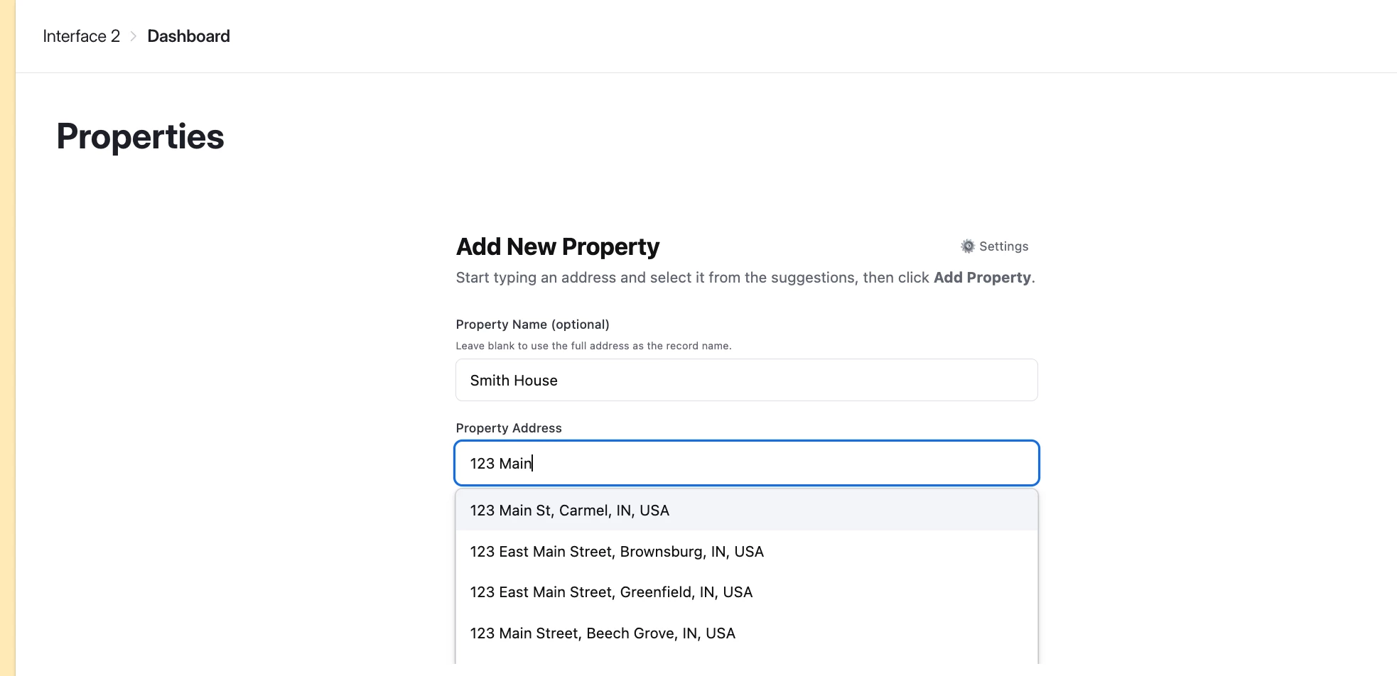

I’m curious if the interface extension are also supported on mobile devices?
After a lot of trial and error and help from Claude Code, I was able to create a custom interface extension that auto-completes an address that is being entered using Google Maps API. This is a huge win for my client, as the other options are MiniExtensions or Fillout Forms.  The Google Maps API key is saved in the Settings.
