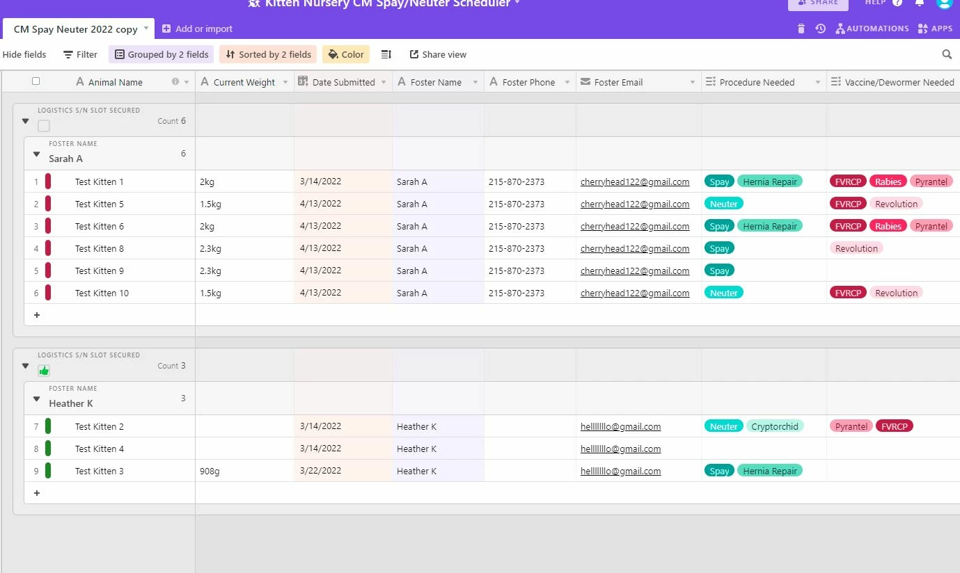

I have a table with an automation to send out an email when a record is updated. Is there a way to send only 1 email to the records updated that contain the same email address, instead of ex. 6 emails?
The client has a family of kittens that are all due at the same day for a vaccine. Is there a way that the foster can get 1 email for the whole group?

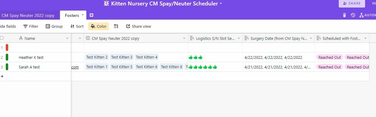

Its one table that has a foster email field. I have it setup to automatically send an email when I click on a checkbox. The problem is that if it’s a litter with multiple animals that are due for vaccines at the same day the automation triggers each time the box is click in that litter and the foster gets 6 of the same emails.

ok thanks so much. I think I got it. Im trying to also add a date field in the peoples tab that is pulled from the animals tab with the lookup function but when i test out the email automation its not pulling that date.
  • April 15, 2022
I set up a lookup that pulls the date from the linked records. Is there a way I can set it up to add just 1 date instead of the date of all the linked records? The date is always going to be the same for all linked records.
  • April 16, 2022
Use a rollup field instead of a lookup field. Use the formula MAX(values)
  • April 16, 2022
OMG you are genius! Thank you sooooo much.
