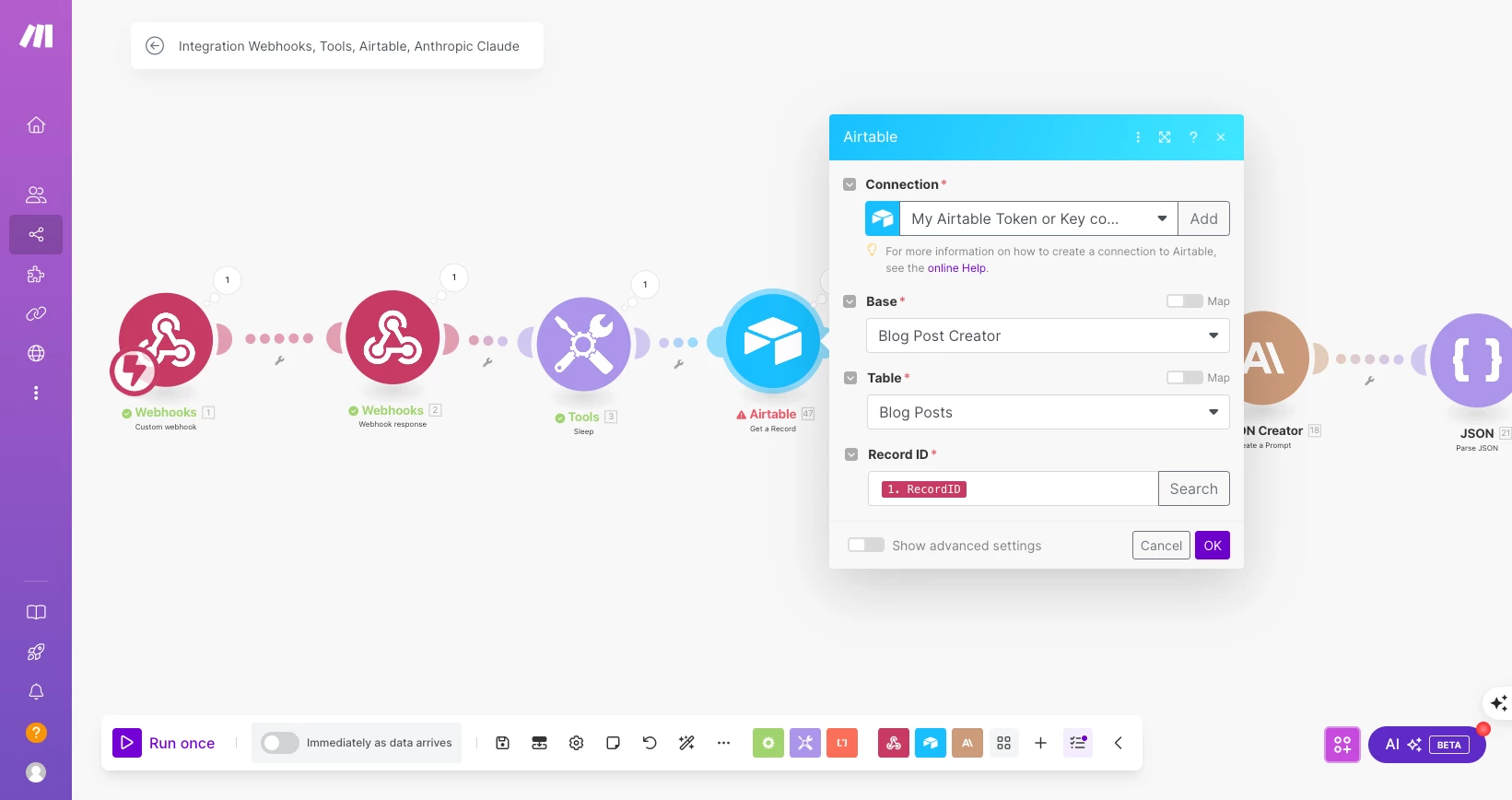

I am very new and only working on a free account and have run out of free ai chat credits.
I am trying to follow a youtubers work flow to create blog articles and post to my wp site. workflow is as follows
Webhook-->Airtable-->Claude-->claude-->JSON-->Cluade-->Tools-->OpenAI-->Openai-->markdown-->Google Doc-->Google doc-->Airtable-->wordpress.
some of the double cluade and openai were create prompt then create article/image.
Webhook
https://hook.us2.make.com/134uosndzo3nh3oq497hxq0hbjfv8js3
Airtable layout
Blogs Posts
 RecordID | Main Keyword | Generate | Outline | Complete Google Doc | Google doc image | Status
Webhook in Airtable ( generate tab )
RecordID tab
RIGHT("000000" & RECORD_ID(), 6)
nothing in Main Keyword tab.
so work flow is  click new row in airtable = generates new RecordID and a "Generate" button I add in the "Main Keyword" and then sent to Claude to create my prompt, then Claude to "JSON Create" then JSON markdown --> back to Claude to create article, then open ai to create image prompt, then open ai dalle3 to create image, -->markdown then into a google doc, and image into a google doc, to airtable and then to wordpress.
Sorry if it is drawn out but just copying from youtube.
I have reconnected my account in airtable, redetermined data structure and a few other things but cannot get past the 404 error in the airtable module.
Thank you for any help.
Dan

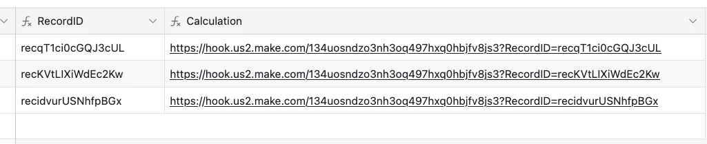

Ah sorry about that, yeap, you need to update the button formula to be the following:
'https://hook.us2.make.com/134uosndzo3nh3oq497hxq0hbjfv8js3?RecordID=' & {RecordID}
now i don't get my unique "RecordID" in the row i just get ( RECORD_ID() ) in each row and still get the 404 error.

Hmm, weird!  I tried it out and it seems to be working fine.  Could you have a look at the base and try to see what's different from your own set up?

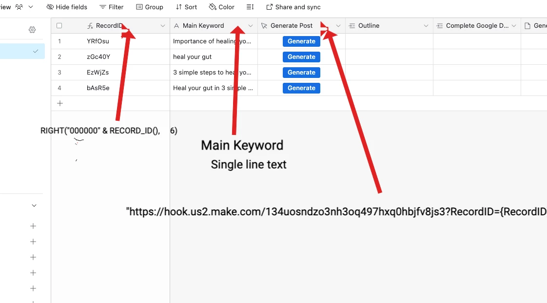

your example it's passing on the unique Record id in the webhook formula. I need it to pass on the Main Keyword.
so I must be missing something simple? So will go over what I'm trying to do again.

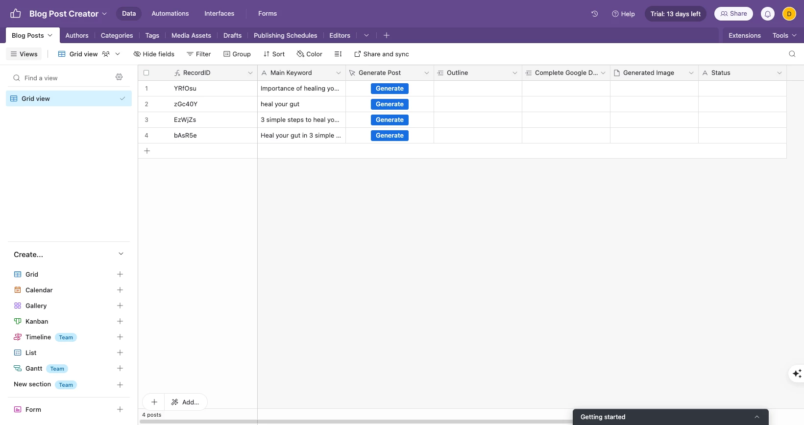

so airtable has 3 columns so far, first one is RecordID then Main keyword and the last is Generate.
When I click a new row it automatically generates a new unique RecordID of 6 characters  and the blue generate button appears. I manually add in the Keyword and hit generate and it sends the keyword to the Make.com workflow.

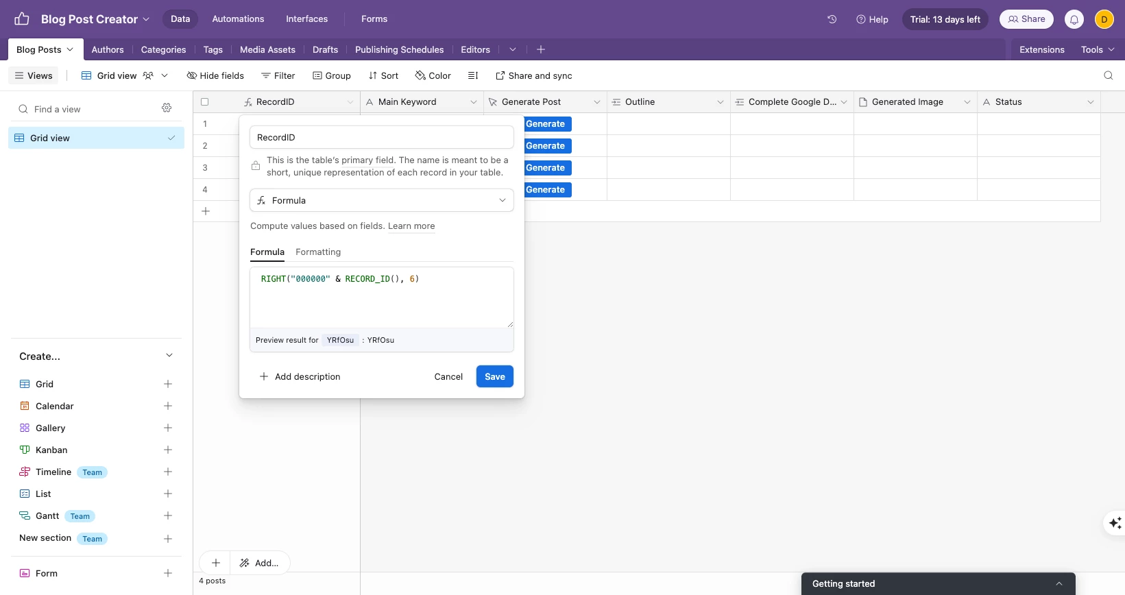

my formula in the "RecordID" looks fine it generates a unique code and the formula is

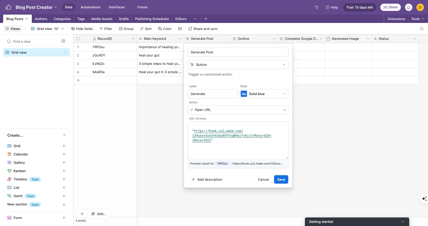

The Generate formula is

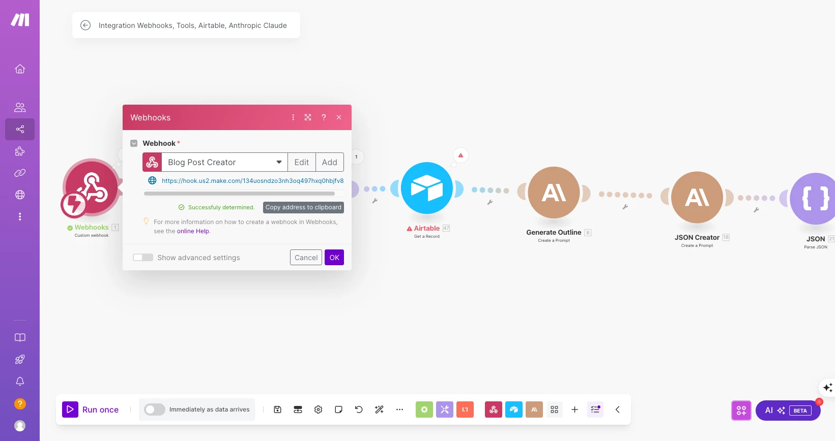

but i get the 404 error in the airtable module in Make.com, in the error code the input shows this..
Input
  • Bundle 1Collection
    • Record ID
      {RecordID}
    • Base
      appQfFK7uuDJVWEe5
    • Table
      tblzsWFSwUclJzhla
    • Use Column ID
      false
The process makes it way all the way to the air table module then stops with the error, the first webhook module runs fine. and it's webhook address is.
Input
    • Record ID
      {RecordID}
    • Base
      appQfFK7uuDJVWEe5
    • Table
      tblzsWFSwUclJzhla
    • Use Column ID
      false
