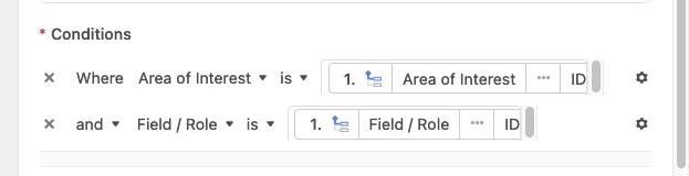

Hi Betsie, you could probably just do this with automations, yeah.
I assume there’s a table where each record represents a student, and contains the information about their area of interested and their desired field or role?
If so, the conditional automation you mentioned would work fine. You’d have to set up a formula field that would make the automation trigger once a week, and then you’d set up your conditionals like so:
After that, it’s just another action for actually sending the found records as an email and you’re sorted

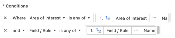

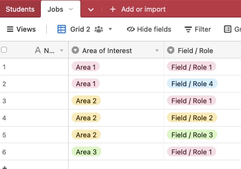

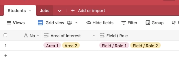

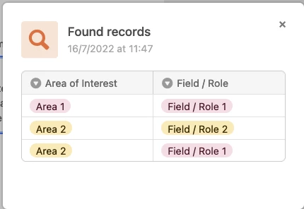

Ah, you’re right! Hmm, what if we updated the automation to be like this instead?
This…seems like it works, but honestly I’m still somewhat confused as to how it’s working as well ha
