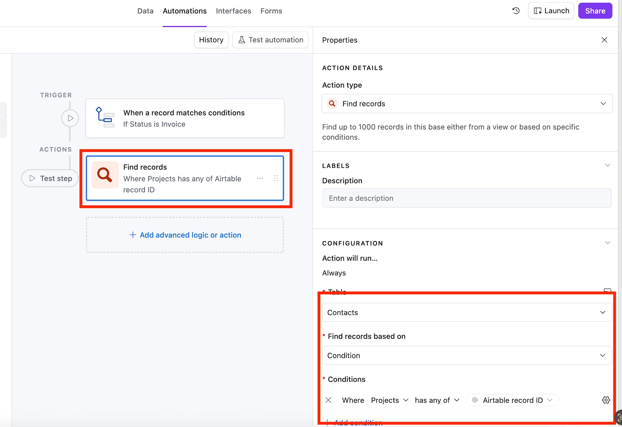

For further reference, when setting the Find Records, you’ll want to set the config as shown on the screenshot below. Table: Contacts. Find records based on: Condition. Condition, where Projects has any of Airtable Record ID of the record that triggered the automation. Meaning that of the Project!

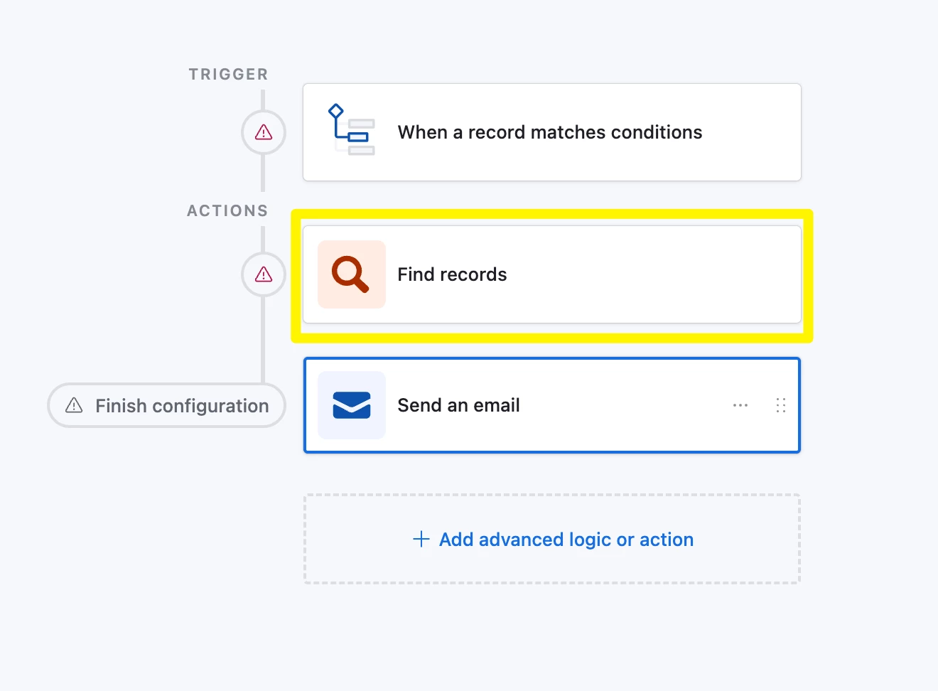

Hi Oscar,
You can add a ‘Find’ before the email block in the automation. Configure this to search your contacts table for the linked record. You can then select data fields, such as ‘Email’ from the returned contact(s) by first clicking on the Find block, which will show on the left, under “User data from...”
It is important to understand that if you are using a linked record field that can have ‘many’ contacts, the find element may return a list.

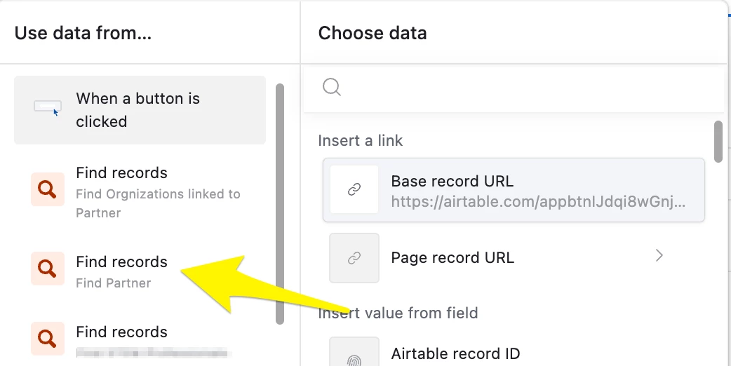

Apologies Oscar,
You need to add a Find action to the automation before the Send Email action. Once configured, you will see the option to use data from the results in your email action. Example shown in image.

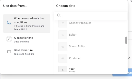

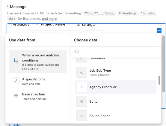

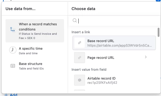

I chose “dynamic” and found the cells from the project
However, it seems like “linked records” are greyed out and can’t be selected?
Maybe I am misunderstanding the flow?
I would like to add the email of the producer
Hey ​@Oscar_Fogelstro,
​@Dominic11’s answer above is what you are looking for!
