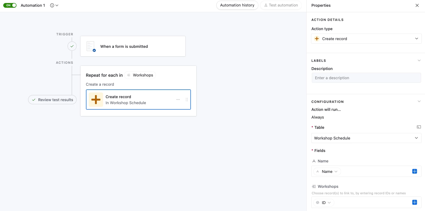

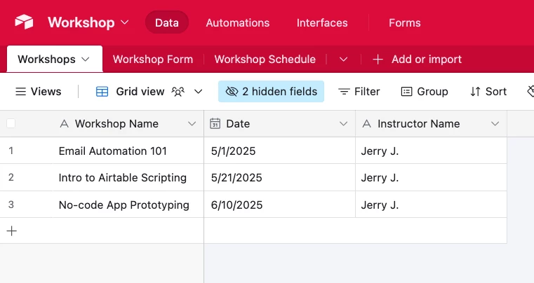

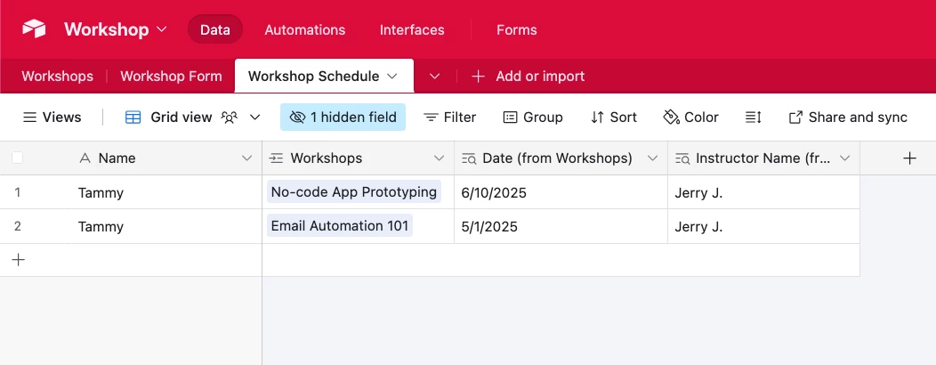

That’s a great question! I don’t think you necessarily need a script to separate registrations. Here’s my solution that makes use of Airtable’s native forms (you don’t need Fillout!)
As you can see in the gif, you will be able to select as many workshops as you want in the form. An automation runs in the background to split the form responses into multiple “registrations”.
Instead of using a script, I used an automation to to loop through the “workshops” response in the form to create new records:
Here’s my example base, feel free to have a look and reference the automation and form included:
