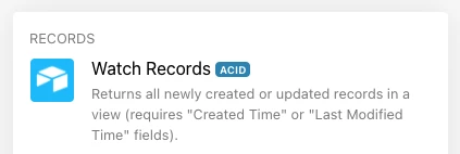

Hi @Gavin_Fudge1 - can you control this from Integromat? There is a trigger on the Airtable component to check for new or updated records:

Hi @JonathanBowen - we can use the record watch, but it is a time based rather than event based trigger (as far as I can see?). Ideally, we need a solution that triggers whenever an update is made either way, which is the crux of the problem with keeping an accurate ‘live’ stock update at both ends. At the moment, we may get away with something time based due to the frequency/volume of current updates, but ideally looking to build something that can scale up.
