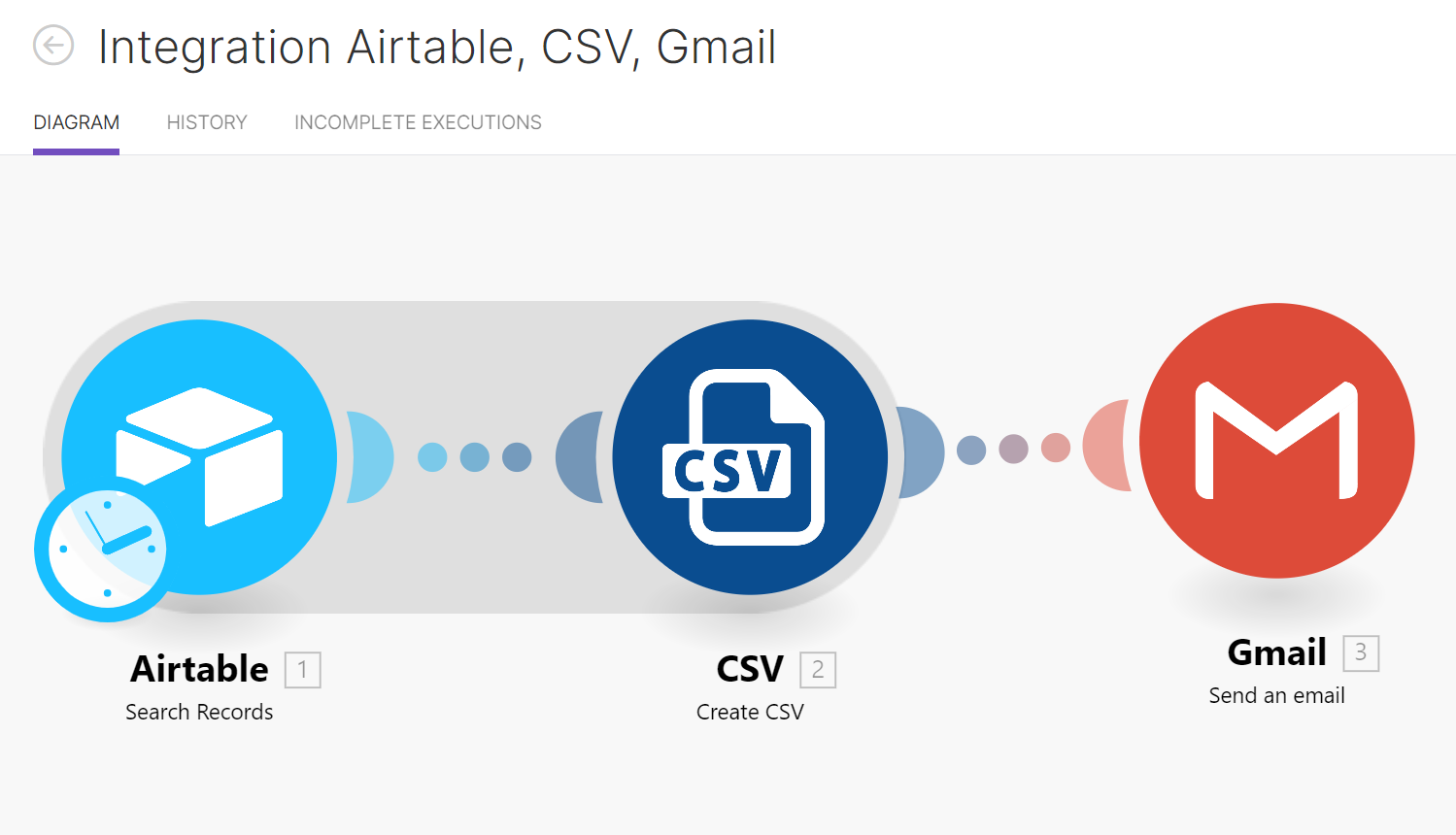

I  do not think the attachment functionality could be used this way. You would need to have existing file first to attach it.

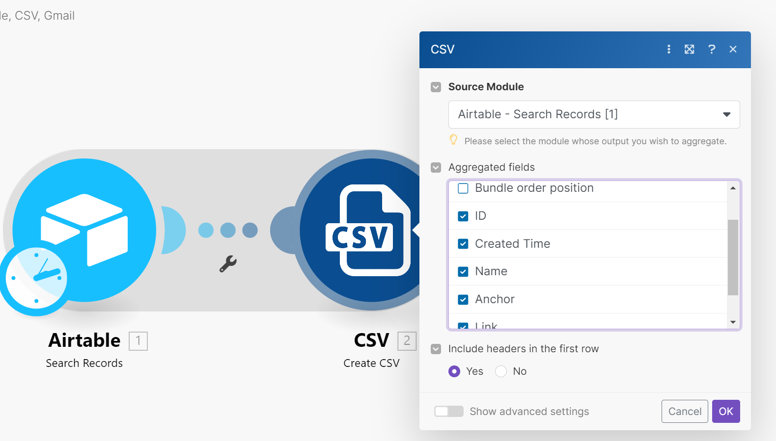

To  create CSV file from an Airtable view, I would just use Make.com - it has a handy CSV module.
In  the Airtable module you specify the view to take data from.
In the CSV you select what data  should be included:

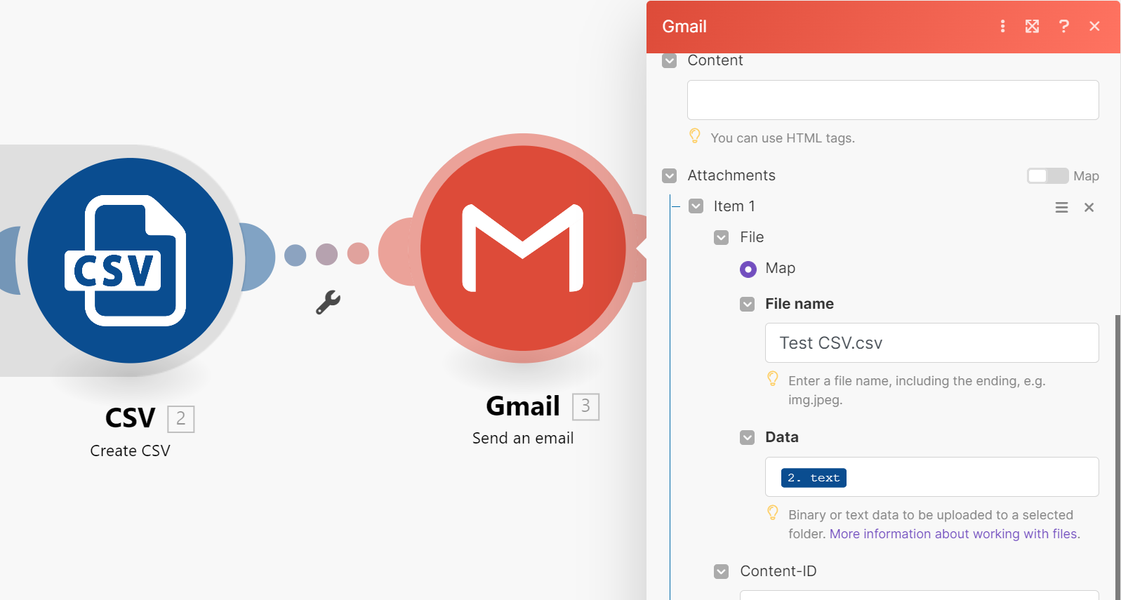

In the Gmail you use the output text as data and name the  file the way you want.csv
You could  use automation to  trigger this scenario (instead of time scheduler I am using above).
Let me know if that helps?
