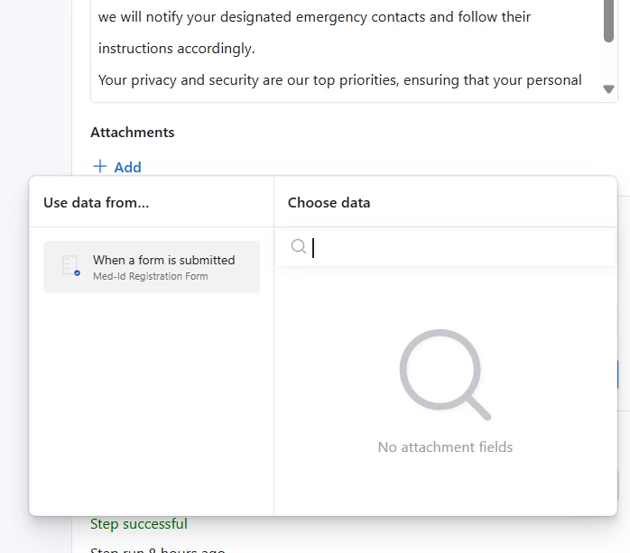

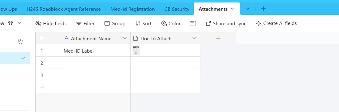

I have created a Separate table  where the attachment is
 I then go to the automation and try to add it   but I cant choose the attachment
I am not sure where I am going wrong

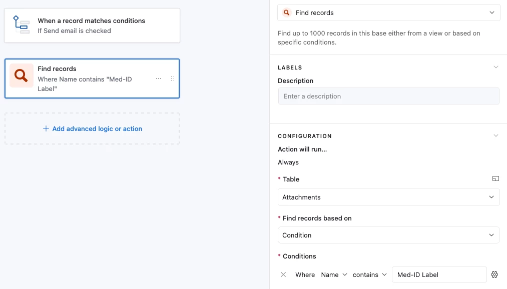

  • June 19, 2025
If the PDF file lives in a different Airtable table/record than the table/record that is triggering your automation, then you will need to perform a “Find Records” action to find the record that contains the PDF file, and then you can insert the results of the “Find Records” action into your send email step. You would need to choose the “flatten” option after you choose the attachment field from the “Find Records” action.
For further reference re: Find Records action block on automations.
I’ve set it up here for you as a reference.  Use the ‘Find Record’ step to find your ‘Med-ID Label’ record:

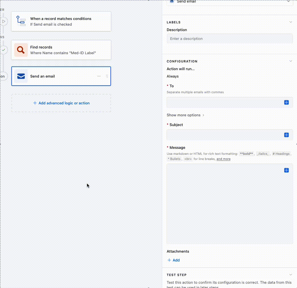

Then add your attachment like this:
