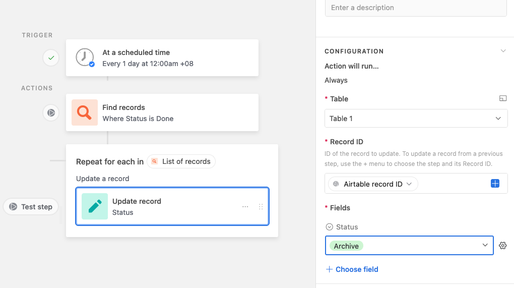

How can I set up an automation in Airtable that will update records in the status column once a week, but only if they meet a certain status type, such as changing records with the status 'DONE' to 'Archive'?
I'm grateful for your reply, but I'm still confused about the 'update record' step and the available options for 'Record ID'. I appreciate that you chose 'Airtable record ID', but I'm having trouble understanding the other options.
Ah, I would suggest checking out the documentation to familiarize yourself with the functionality available
Set up an automation that runs once a week with a "Find Records" action that will look for all records with the status "Done"
Then, add a repeating group with an "Update Record" action that will update each found record as needed
