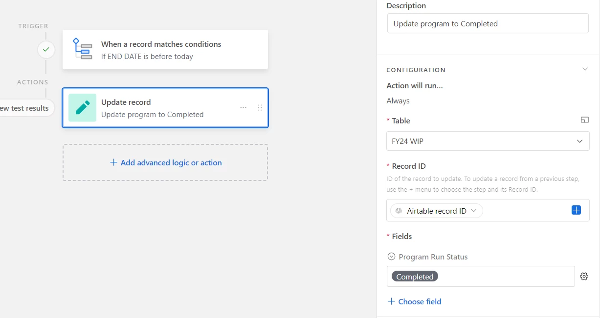

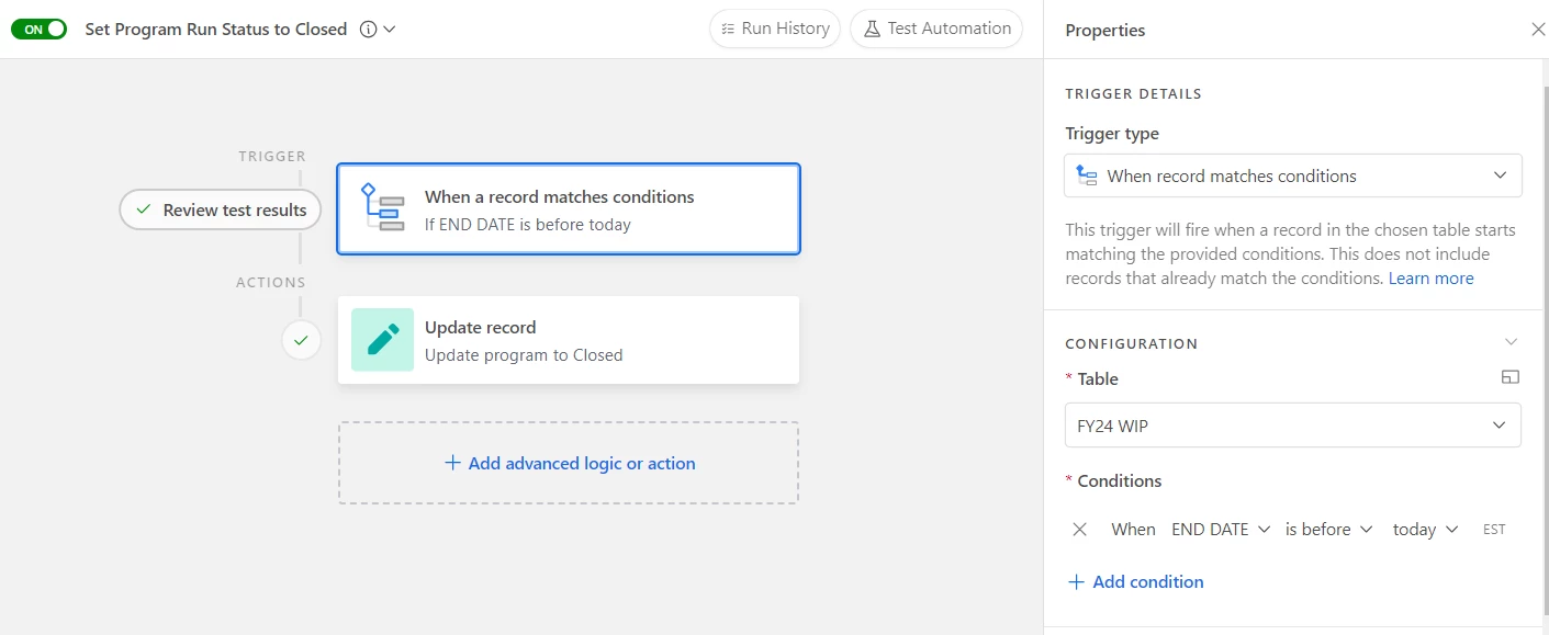

Hi there - I am having trouble creating automations to change the status of a single select field based on start and end dates.
Example 1 - I need the status to change from "Scheduled" to "Live" once a start date has passed. As in, if a class has a start date of 1/5/24, then this record would switch from "Scheduled" to "Live" once 1/5/24 begins.
Example 2 - I need the status to change from "Live" to "Completed" once the end date of the class has passed. I set the automation trigger for "When a record matches conditions" If END DATE is before today. The action step is "Update record" but this is where I believe I'm having trouble getting the automation to read the entire table and make all applicable changes.
Attaching screenshots of what I tried based on END Date, but it did not work. Any help is appreciated.

When you test the steps in the automation, do they show that they're working?
If the automation is working on new records, but not past records, I would select the entire END DATE row, delete all the data... then CTRL + Z... that should cause the automation to check every row.
