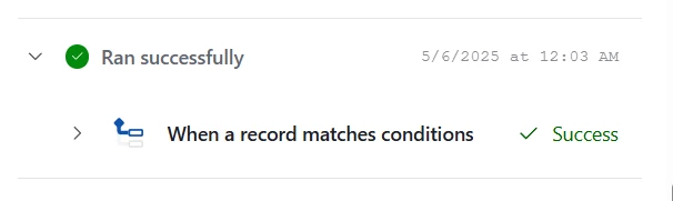

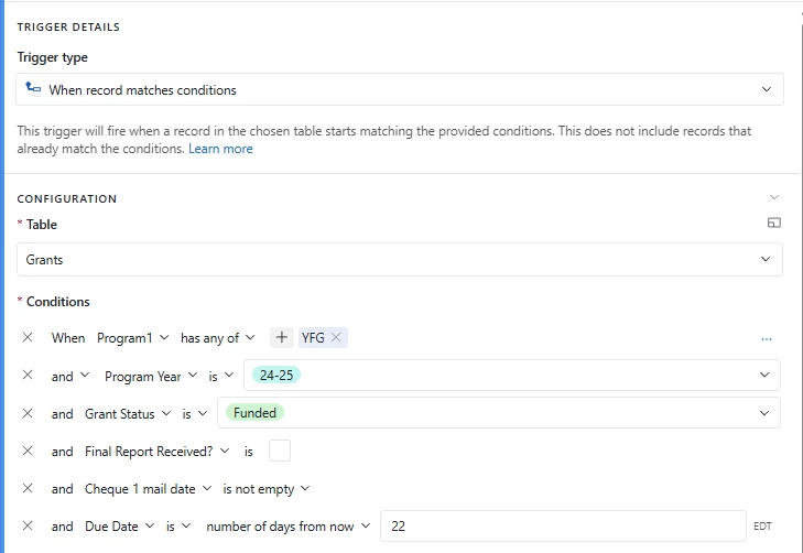

Here are the triggers for Sam’s emails:
I can’t seem to find anything wrong with these filters - when I set up a view based on these exact filters, I get all 180 in the filter.

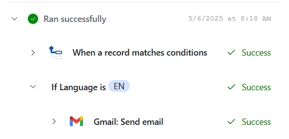

The automation history shows success for the 5 or 6
But the rest seem to be successful for the trigger only

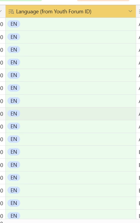

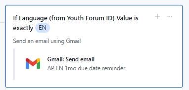

But all 180 have that additional filter of If Language is EN
When I test the automation using a random selection from the 180, it works.

The conditionals in your screenshots don’t seem to match, in one of them it’s ‘Language’, and in the other it’s ‘Language (from Youth Forum ID)’.  Not sure if that’s related?
If you could DM me a link to your base I’d be happy to see what I could figure out; there seems to be a lot of variables at play here and it’s difficult to troubleshoot from the screenshots
