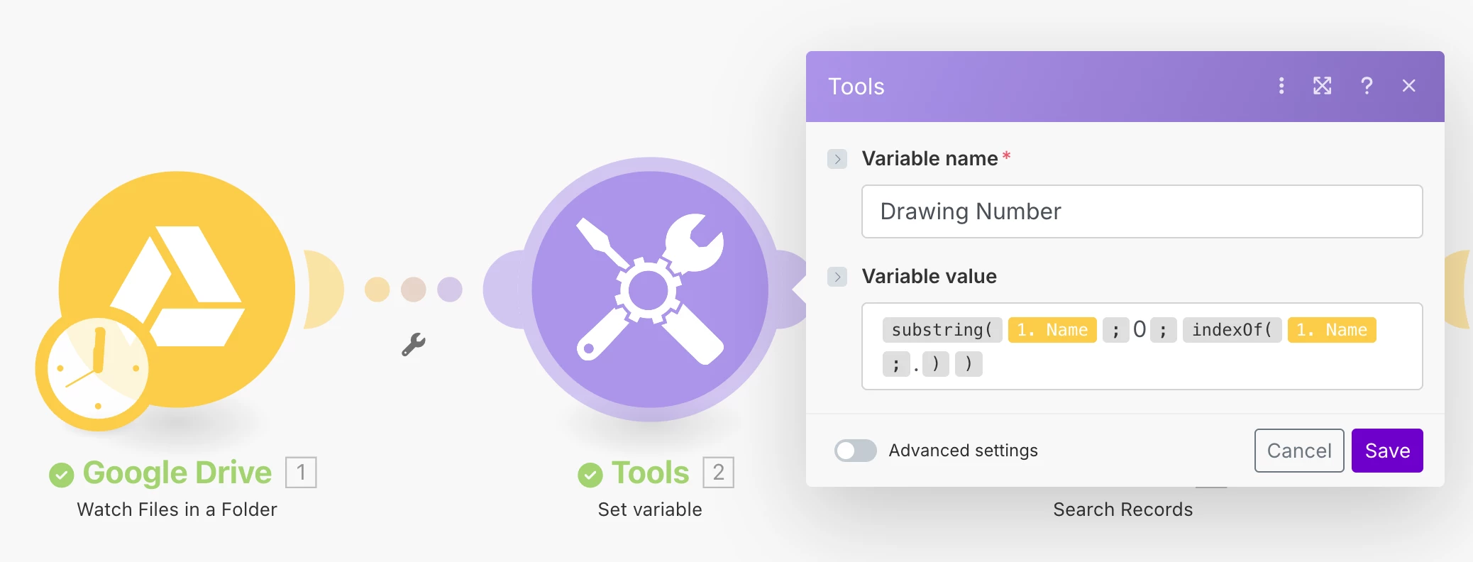

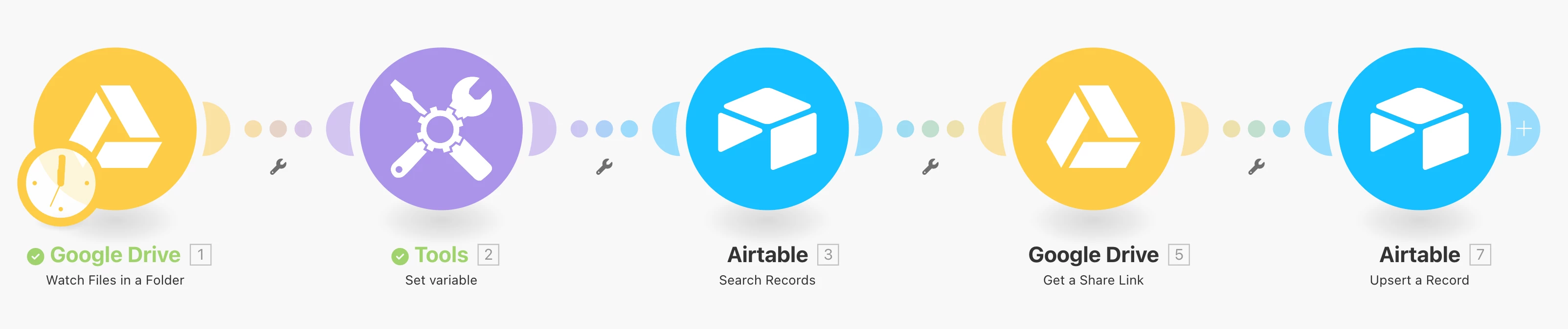

But I can give you a few tips to get started by showing you 2 screenshots below.
You would simply need to monitor your Google Drive folder for all the new files that you add to it. (If you right-click on the module, you can go back in time to capture all the files that you have previously placed in that folder.)
Then, you would parse out the drawing number from each filename, and set the drawing number to a variable. I show how to do this in the 2nd screenshot below.
Then, you would search for that drawing number in Airtable to find the record that needs updating. If it can’t find a pre-existing record in Airtable, that’s why you will use the “Upsert Record”  module as the last module. “Upsert” means that it will create a brand new record if the record doesn’t previously exist, or it will update the existing record if it does exist.
Airtable will ONLY accept public URLs to add a file to an attachment field, which is why you need to use the “Get A Share Link” module which will give you the “web content link” of the file. Send that “web content link” to Airtable.

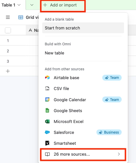

Airtable offers a Google Drive integration that does what you need I think, syncs up as one record per file in Drive:
https://www.airtable.com/integrations/google-drive
And to use it you’d add a new import source:

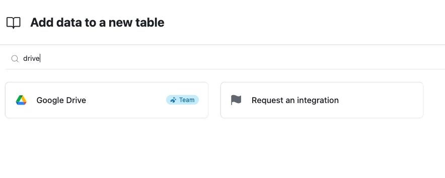

And then look for Drive:
Assuming your file names include the drawing number it’ll be pretty easy for you to map them to your Airtable records!
