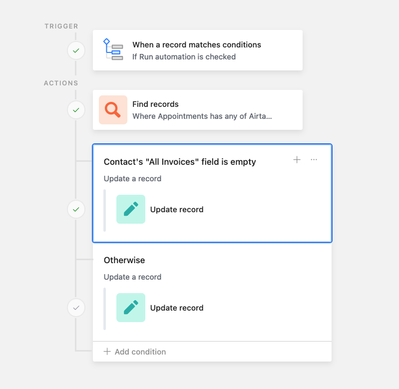

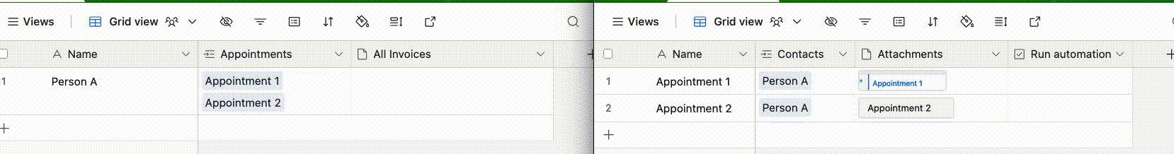

Hmm, you don't need a script for this and can just do it with automations:
Link to base
If the contact has no existing invoices, we just update it with the attachment from "Appointments":
If they do have existing invoices, we append:
Link to base
Link to base

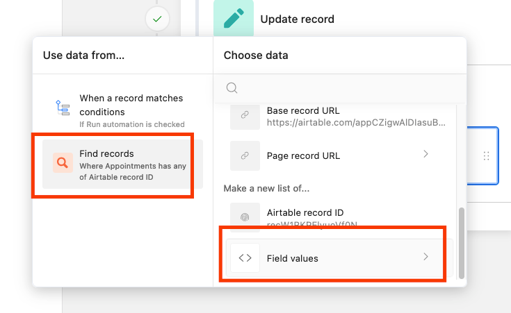

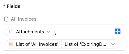

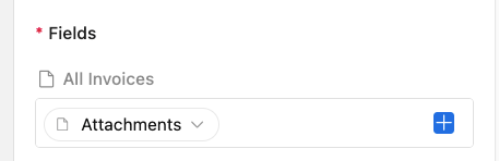

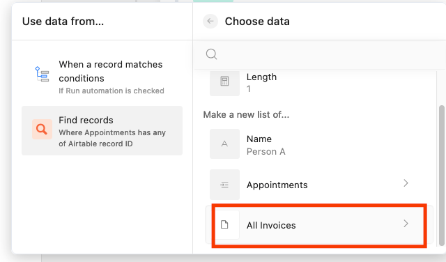

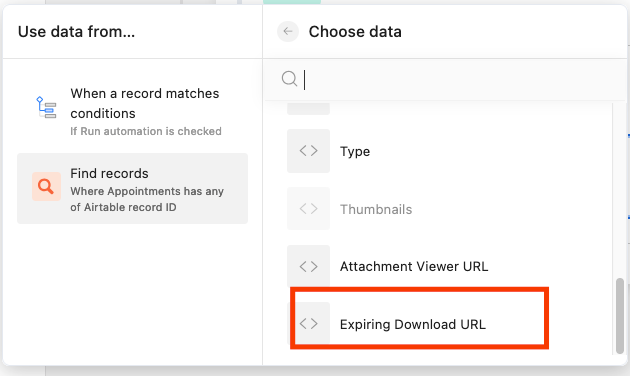

Hello and thank You for Your help, I managed to recreate all the steps that You showed, except for the last one, Otherwise Update Record in the section fields. See the screenshot please. So, my Attachments field is called "DC" and I inserted it into the "Fields". I was not able to recreate you last one which says "List of All Invoices'List of ExpiringD...", can you please specify the path how to select this option.
I tried the automation, it works (thanks to You), but  what happened is: if the field "All Invoices" is empty, it copies the invoice without any problem, but if there is already an old invoice, it replaces it with the new one. But I need to keep both. Thanks again for your help
Yeap, sure!  Here are some screenshots:
If you're still facing issues just DM me an invite link to your base and I can sort it for you real quick
