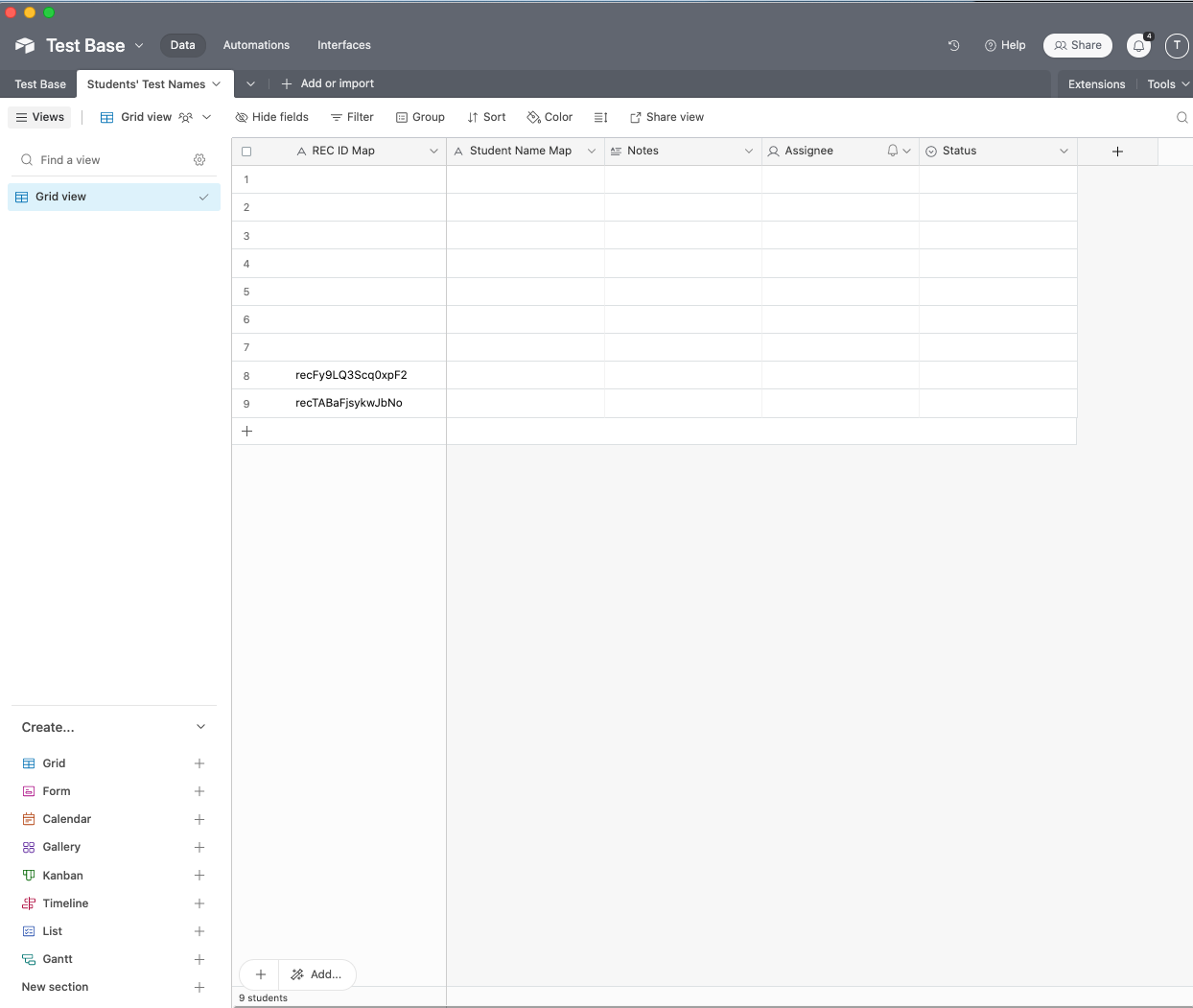

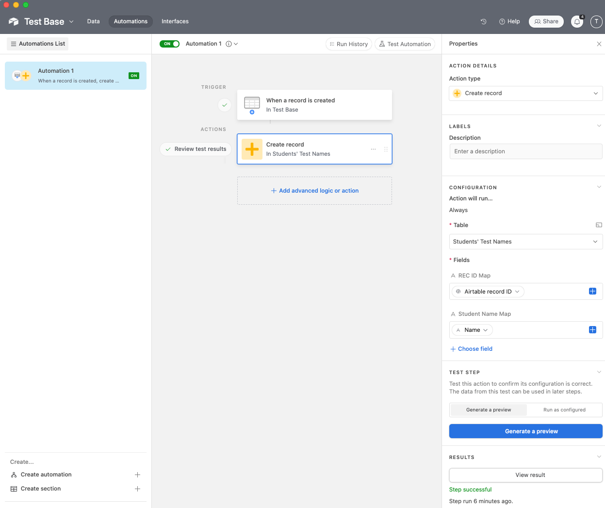

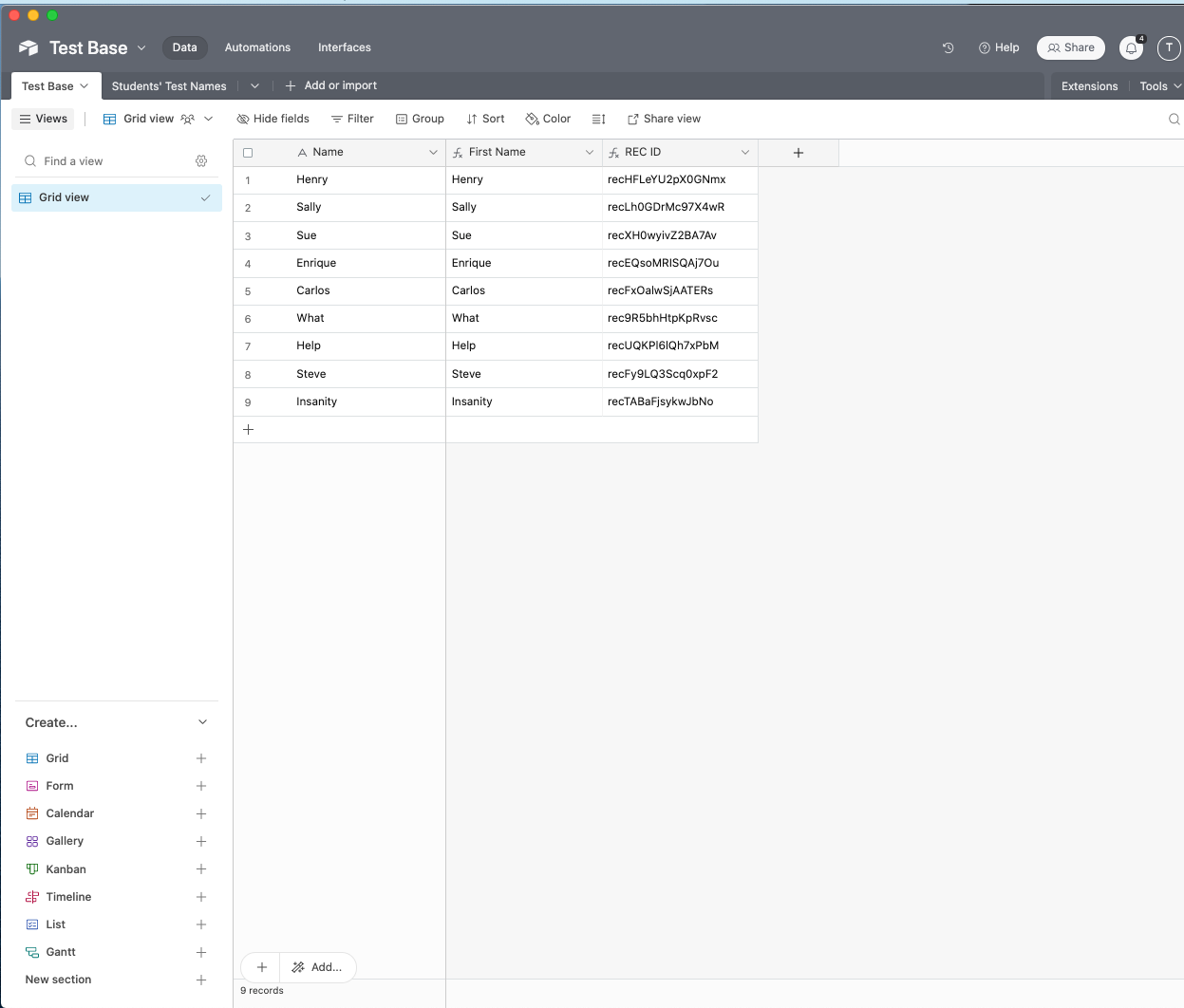

To replicate the same problem I'm having, I'm creating an automation in which I would like to make it so when a record is created in the Test Base table, it automatically ports that name over to the Students' Test Names table.

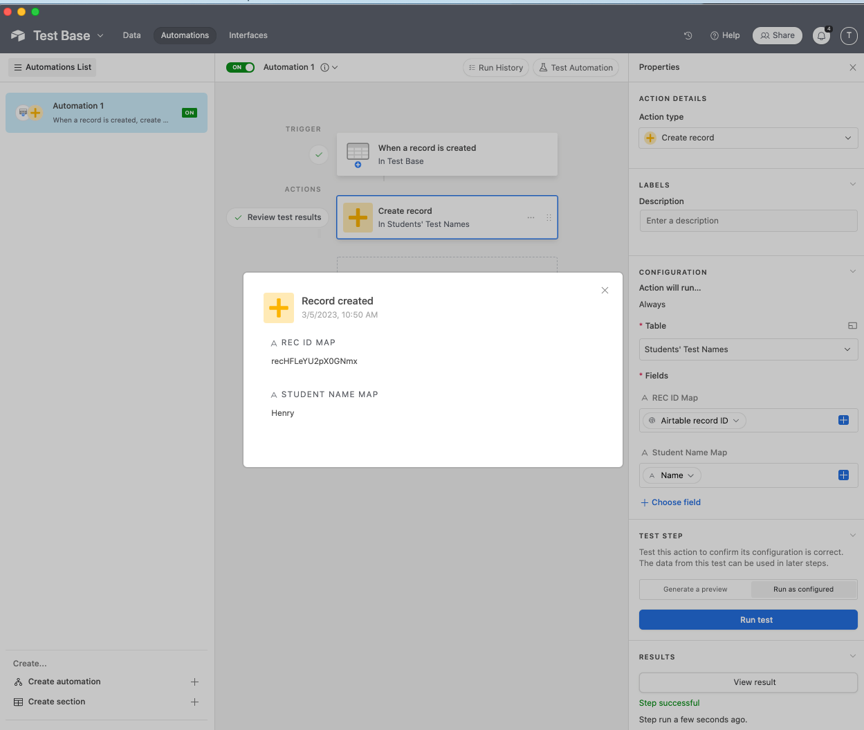

As you'll see, Airtable says the automation ran, but it only pulls in the new REC ID of the record that's been created and not the Student's Name, despite the fact that I think I mapped both, and the "result" shows that it has added the associated student's name, as well as the REC ID. Any thoughts? Thanks.

Yah, that's because at the point of manual record creation via a View Grid, a record is empty at its point of creation - triggering the automation whilst in its empty state, resulting in empty data.
There's been much discussion around this problem, so it's worth searching the forums and reading up on the various methods that you may use to address this.
If your users are entering in data via a View Form or an Interface Form, then your automation will work as expected on that form entered data.
Or if users are using the Grid View to enter data, then you're going to need a different trigger mechanism to use so that your automation only triggers on existing data (rather than data that's about to exist, but as it doesn't, results in an empty data payload).
Feel free to ask questions if you need further help finding a more specific solution.
