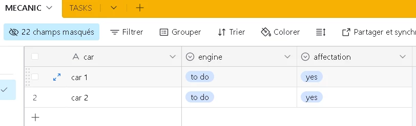

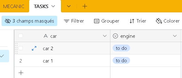

my 2 tables, MECANIC and TASKS
when ENGINE is TO DO and AFFECTATION is YES=> line is created in TASK table
what I need to do : in TASKS table if ENGINE is DONE I need that MECANIC table update ENGINE to DONE related to the CAR

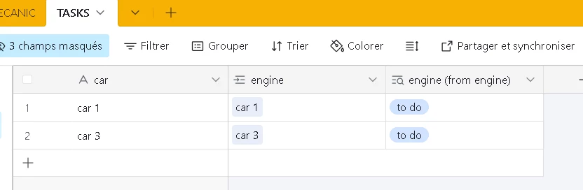

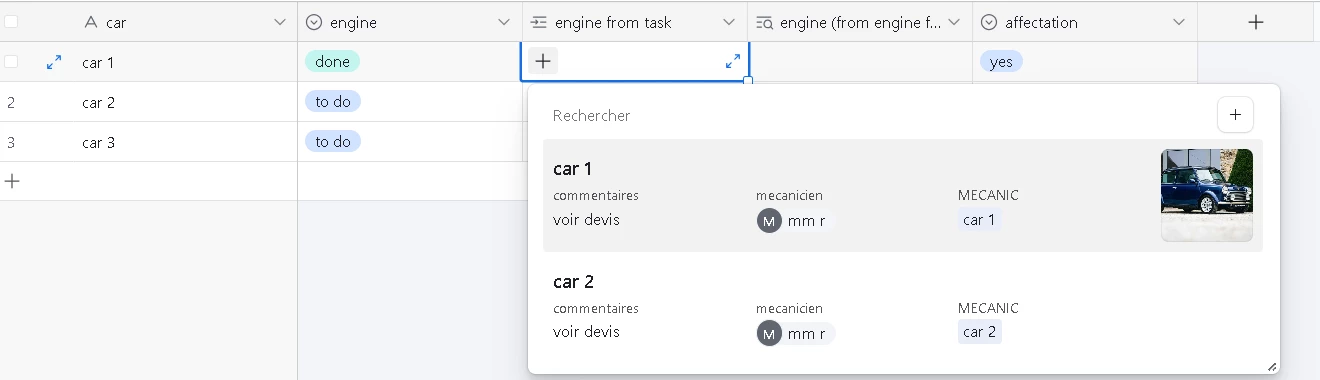

I’m at this step below, now how to modify en engine status to DONE and how the MECANIC table could be updated ? because in TASKS table I can’t have the choice to put the ENGINE at DONE to update the MECANIC table, hope I’m clear 😄
  • May 22, 2025
Take a look at my setup—you should be able to change the Engine field in the Tasks table.
Basically, include the Engine field in your Tasks table, and then use a lookup field in your Mechanic table to reference it.
Taha, Airtable Advisor

In TASK table I linked CAR and ENGINE from MECANIC table, this line is created by automation.
Then, in MECANIC table I link ENGINE STATUS (new column) and CAR from TASKS table.
And by automation I can update the ENGINE column with ENGINE STATUS.
