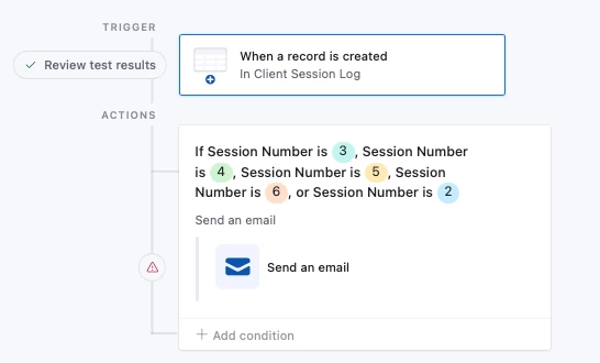

I’m creating an automation, where a forms is emailed out to the client after Session 2, 3, 4, 5, and 6.
It works up until the email part.

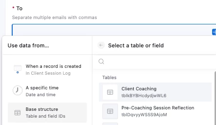

The email address for the client is in the Client Coaching table:

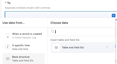

This is how I set up the email section:
1.
2.
3.
4.

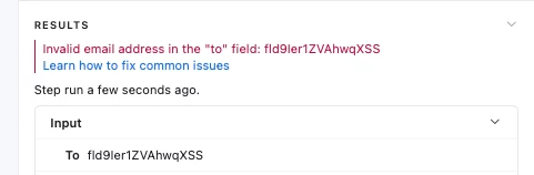

I am getting the following error message:
I would really appreciate some advice here.

On the left, don’t choose “Base Structure”. Instead, you want to choose the email address from the trigger step, which is “when a record is created”.

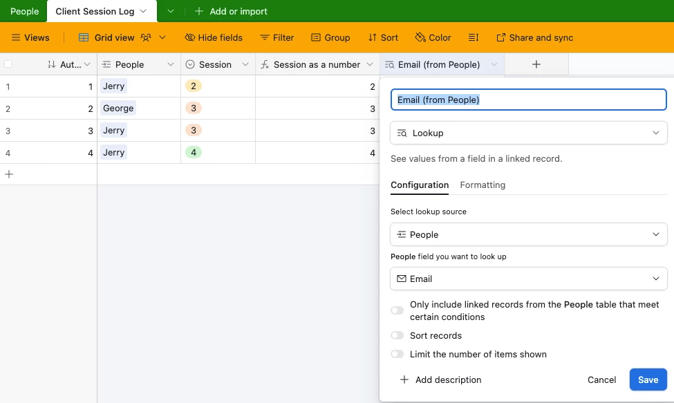

I assume you have your Client Coaching table linked with the Client Session table. In your Client Session table, add a lookup field for the email.
You want to select the email address from the trigger step, which is "When a record is created."

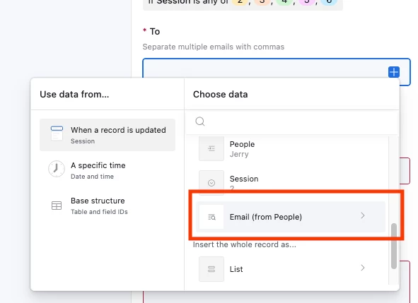

I’ve set up a base here for you to check out that should do what you need!
It assumes you have a lookup field in your main table to display their email addresses, like so:
If not, you’d need to add one as a lookup field (https://support.airtable.com/docs/lookup-field-overview), and then you can set up your automation like this:
And that’ll use the email value from the linked ‘People’ record
As an aside, I’m kind of curious about your automation set up; I’m thinking we could set it up like this instead?

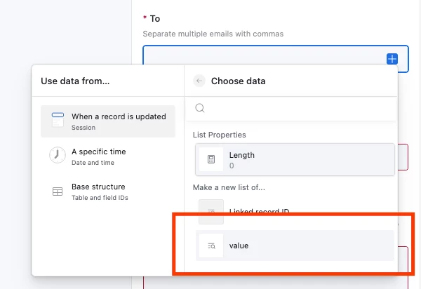

Hey ​@Siobhan B!

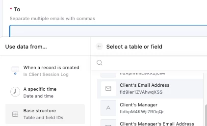

Just for further context, when you select “Base Structure” as the description mentions on your own screenshot, it is only returning “table and field IDs”. This means that when you are selecting “Client’s Email Address” you are actually retrieving the field id of field “Client’s Email Address” (fld….).
You can follow Adam’s step by step above go make it work!

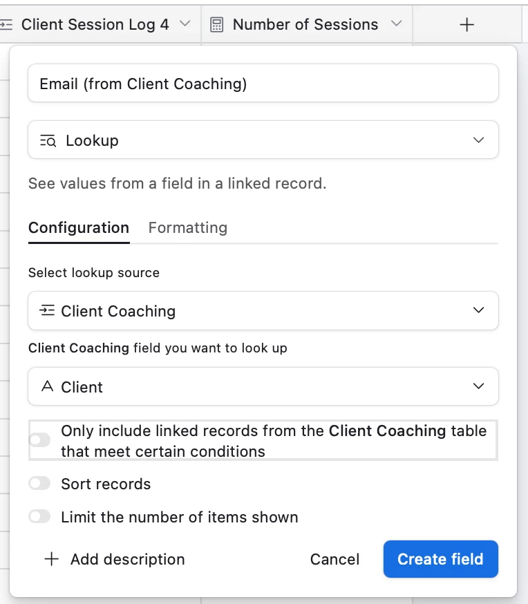

I don’t currently have a Lookup field. Thanks for sharing the article link.
The tables are linked and the Client Coaching table is the main one. I‘m assuming from the article that the Lookup field is created in the main Client Coaching table.
Do I link the Lookup to the Client field rather than the Client Email Address?
This is how I’m interpreting the Lookup setup:

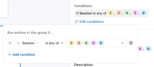

In regards to my interesting use of the session numbers, thanks for the suggestion to streamline the Conditions section. That makes a lot of sense! It was a newbie error! I have basic database knowledge but am trying to learn a lot as I go. I will try and combine them all into one Condition.

re: The tables are linked and the Client Coaching table is the main one. I‘m assuming from the article that the Lookup field is created in the main Client Coaching table.
Hm, you’d want to put the lookup field into the table where each record represents a single session and has the session number, and so for me that was Client Session Log:
If that doesn’t help, could you provide some screenshots of your two tables?
