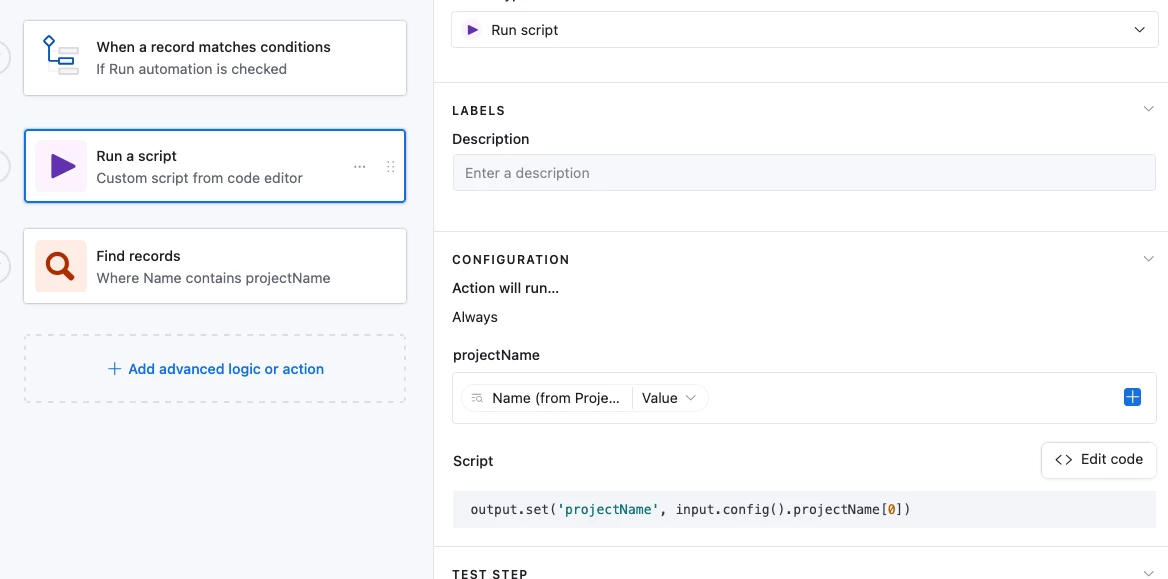

Could you provide some screenshots of your table and automation setup please?
The issue is probably due to the value you’re using being an array and you need it to be a string.  As a quick workaround, you could try either of these and I’ve set up an example base here for you to check out
  1. Using a Run a Script action to convert from an array into a string
    output.set('projectName', input.config().projectName[0])
  2. Using a Generate Text step.  This’ll cost AI credits tho, so if you’re worried about that you’ll want to use a script instead
