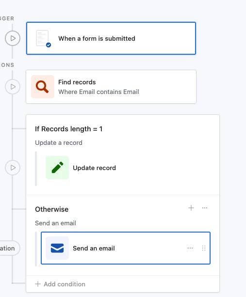

Assuming the tables are in the same base and that there’s a unique identifier between the two records (e.g. the email would be a good one), then you could create an automation that’ll trigger when the form is submitted, it’d look for a record in ‘Referred’ with the same email and then update the appropriate fields.  You could also make the record delete itself via a Run a Script action too

Hmm, so your workflow currently is:
  1. Person gets referred
  2. You create a record manually in the ‘Referred’ or some such table
  3. You send the person the form link
  4. They submit the form
  5. New record gets created from the form submission
And now you want the data from the form submission to go into the record you created in step 2, is that right?
Third party app solution
Try using Fillout (https://www.fillout.com/), free up to 1k submissions a month and would be the fastest way for you to deal with this I reckon.  In step 3, instead of sending the form link, you’d send them a specific link that’s tied to their ‘Referred’ record, and then when they submitted that it’d update your form directly
Airtable solution

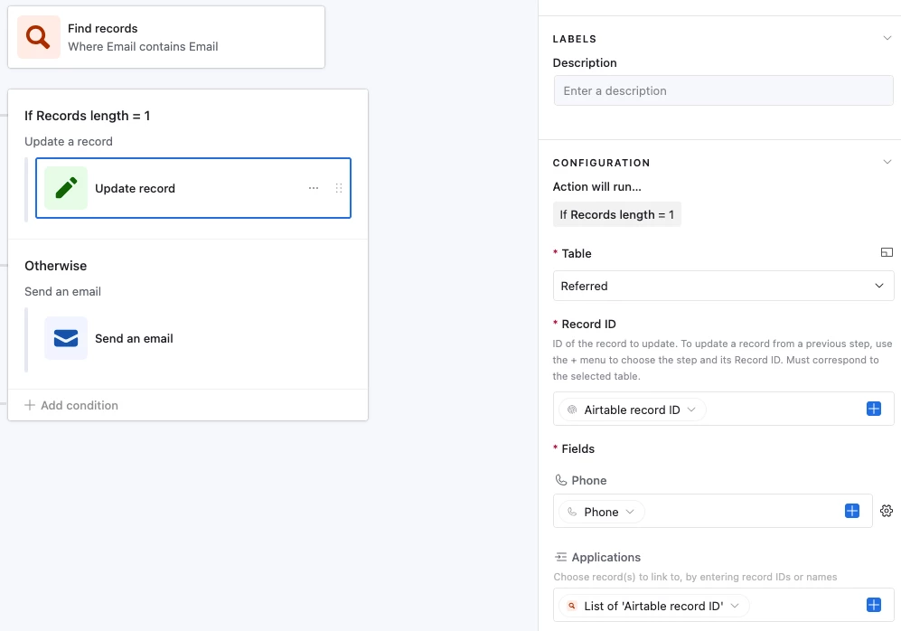

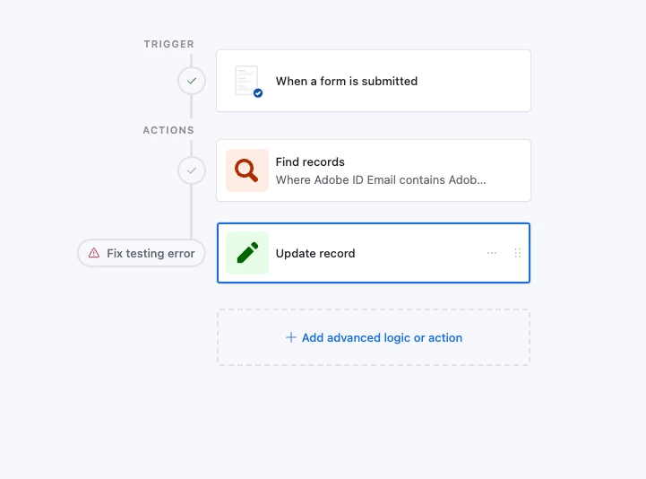

​@TheTimeSavingCo I’ve tried doing what you suggest, but my last step is failing “Received invalid inputs.”. Any idea of what I’m missing? Thank you!
DisraeliGears01
Forum|alt.badge.img+22

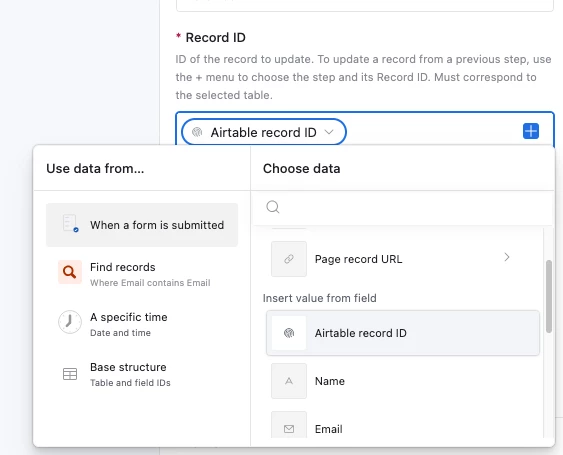

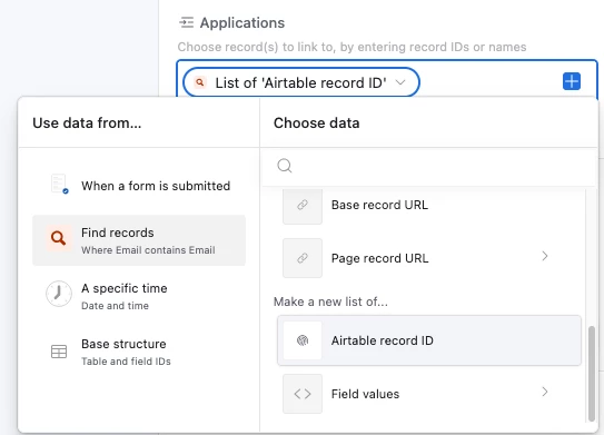

Screenshot of the automation details may help if you have something misconfigured with the RecordIDs, but a common error with automations is to make sure you’ve rerun testing the initial steps (and that you have a valid record for the test to find)
Here are a couple of screenshots of the setup:
Record to update:
Record to link (optional)
You can also DM me an invite link to your base and I can check it out directly for you if you want

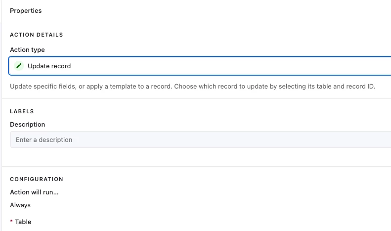

SilC
  • Jun 24, 2025 10:49 AM UTC
​@TheTimeSavingCo I think I know what the issue is. In the Action will run configuration I don’t have an option to change it to anything. It’s stuck in Always:
I changed the Record ID as per your screenshots and it now let me turn it on, so we’ll see if it works.
