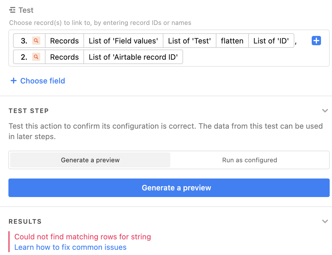

You’re close! You definitely need to separate with commas (no quotes necessary). I would also change the value you’re pulling from the find records steps to be the record IDs instead of the names. Using the names can fail for a number of reasons (for example if you have a leading or trailing space in one of the names, this could cause an error).
Forum|alt.badge.img+7
Unfortunately, if I add a comma, I get an error.
I don’t know what I’m missing…

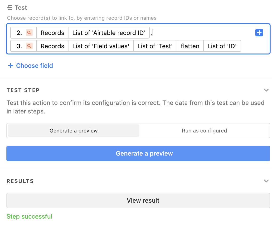

Ah! Super helpful video - thank you!
This is quite interesting. I believe the issue is that the contributor you’re trying to update doesn’t yet have anything in the field, {Liked}.
I just did a little test on my end and confirmed that if the first list of record IDs is empty, the automation fails.
The good news is, if you flip the order around, it works. :thumbs_up:
It worked! Thanks a lot!
