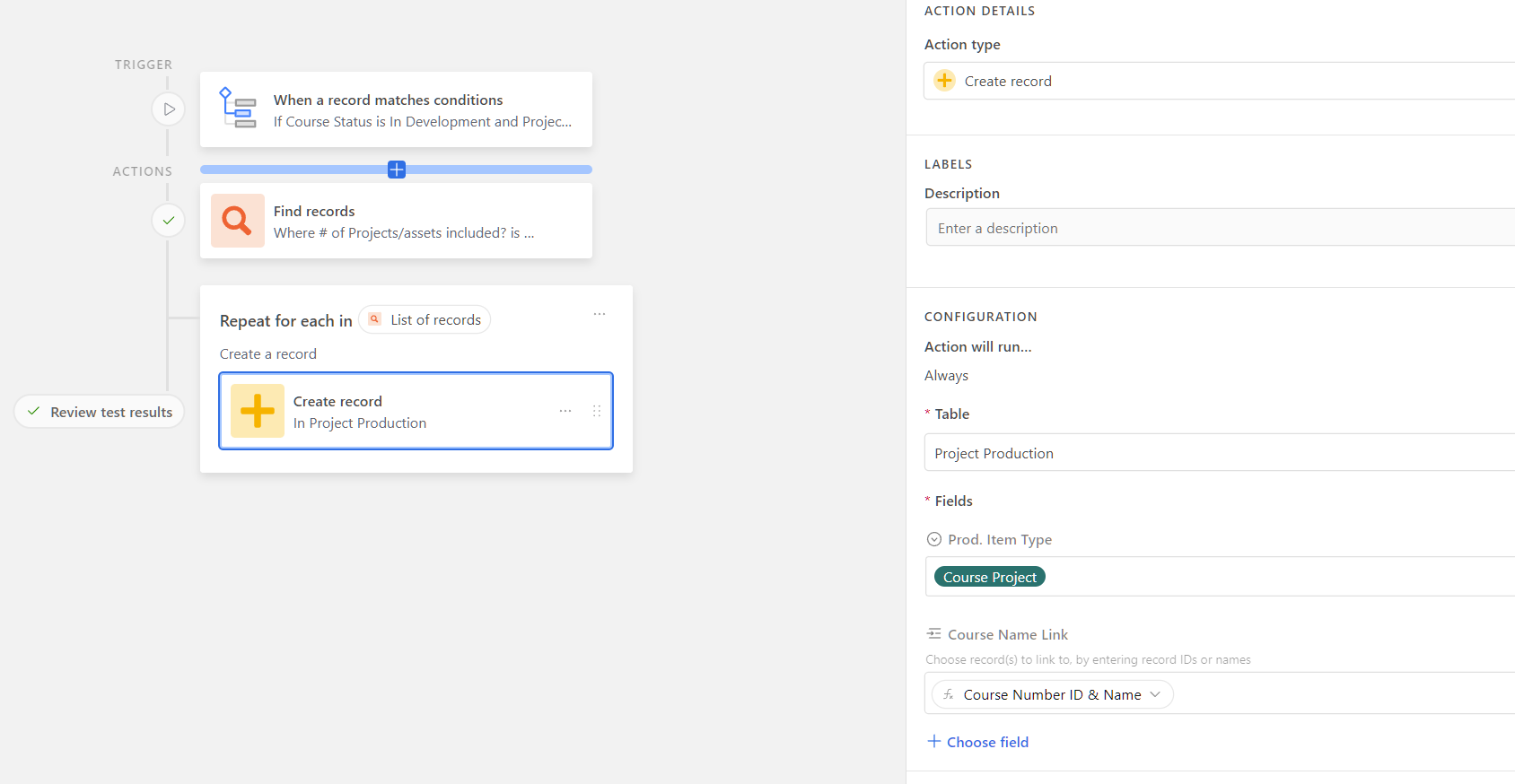

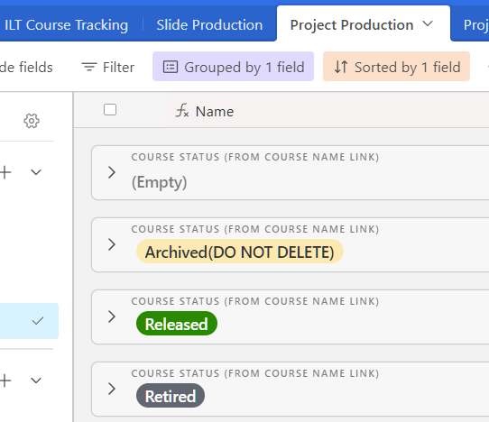

I'm looking to automate a task based on # of projects included in a record.

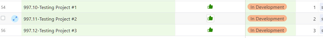

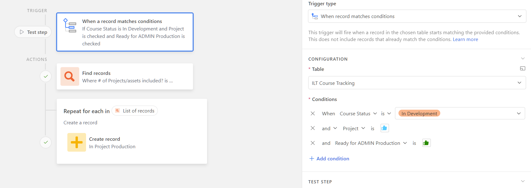

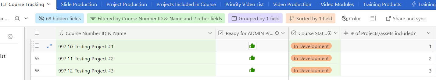

The above is a listing of test courses.  The are marked for the trigger conditions, and should be the only records that are created into the Project Production Table.
I'd had a simple automation that did this perfectly.  However, I'm needing it modified to where it will now create new records based on the # of projects in that field:
Here's the automation setup:

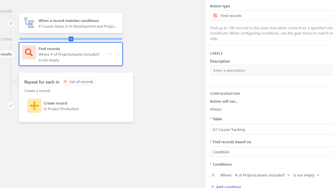

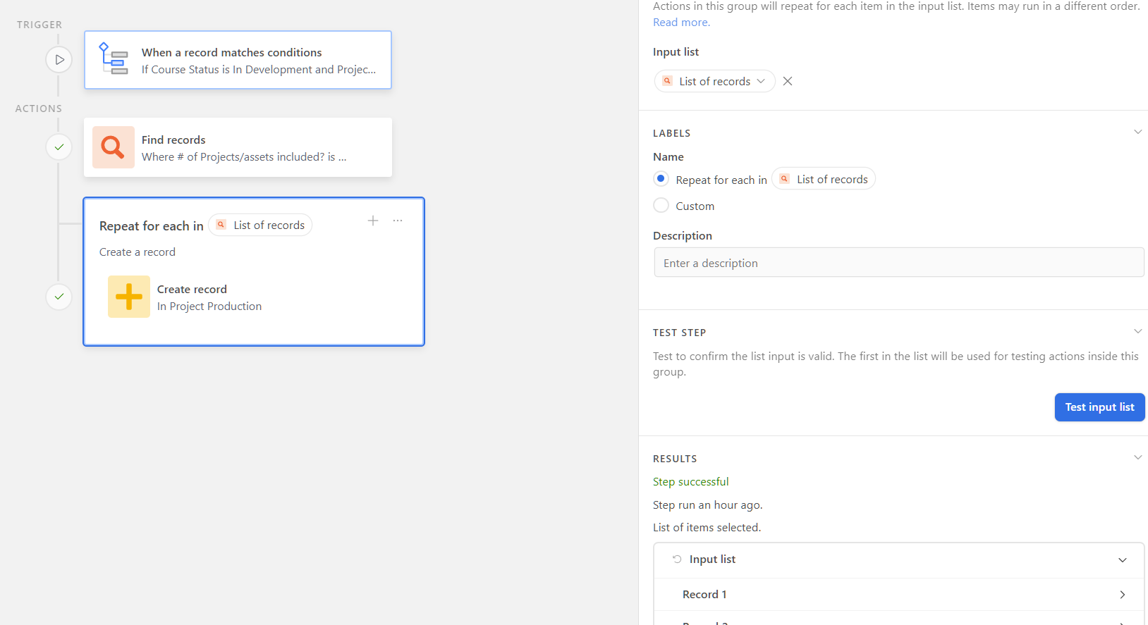

I know I need it to loop a # of times based on that Project's field, but I just can't seem to figure it out in AT.
I feel my settings aren't quite there, obviously.
Also, does the Trigger's conditions affect what records the FIND RECORDS action looks at or is it its own?
Thanks!
