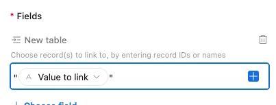

Hello, I'm looking for a method to link records with comma seperator like below:
Ex: CDA, Fresno Foundation should be linked as CDA, Fresno Foundation
But my current job does the linking separately and creates two distinct linked records as CDA Fresno Foundation
Is there a method to accomplish this? Please advise. TIA
In your automation try wrapping the value with quotes:
Once that's done it should do what you need:
Link to base  

@TheTimeSavingCo  That worked like a charm! Thank you!
