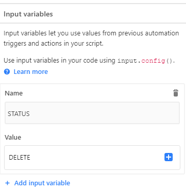

Hi, thank you for your response. How will I do that?
What I did is like this.
  • May 13, 2022

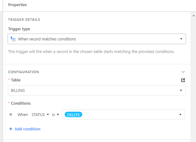

The status of delete needs to go in the automation trigger, not the input variable for the script.
You need to create an input variable named recordId and select the value of the record id of the triggering record. (Use the blue plus sign to select the value.)
  • May 13, 2022
I think I’ve already done that. Can you please check if this correct?
  • May 13, 2022
I got it! It works now life a charm! Thank you @kuovonne
