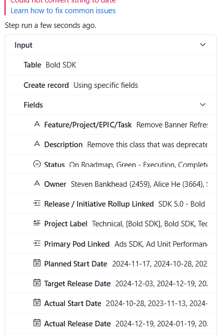

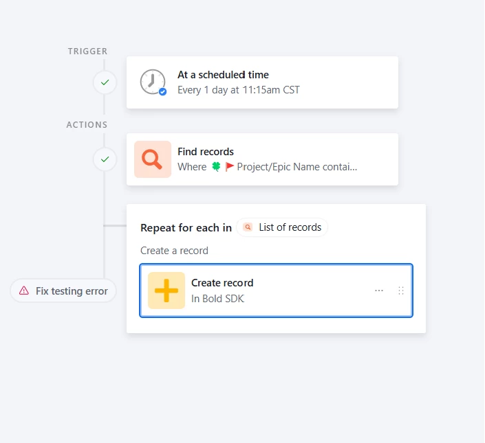

I am trying to create an automation which take entries in one table to create a record in another table. It is currently erroring out on the date field as it seems to have multiple dates in the field (not sure why since I only see one date).  Is there a way to get the latest date or the date of the current value? I have also noticed that there are other fields with multiple entries as the project information is update. Is there any way to just get the latest information? Do I have to write a script? Here are some screen shots

Secondly I think I'd need to see the Find records automation to see what's being pulled in to create your list. Right off the bat unless there's something hiding in that Find automation, you'll end up creating duplicate records every run. You could fix this by adding a checkmark field in your sync table so that after record creation, each record is updated to checked, and then a condition in your Find is "unchecked". I'm also wondering about primary fields in both tables, are they short text fields? Do the short text fields frequently overlap?

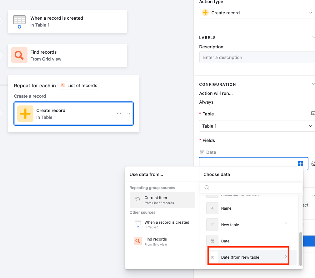

Could you confirm that you're using the values from the 'Current item' like so?  Your screenshot shows the record being created with multiple values so that might be an issue.  If you're already doing that, could you provide more screenshots of your automation setup?

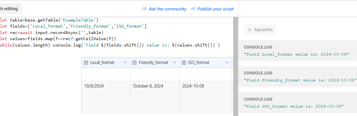

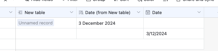

With a lookup field displaying a 'Friendly' date I'm able to put that value into a 'European' format date field with no issues:
