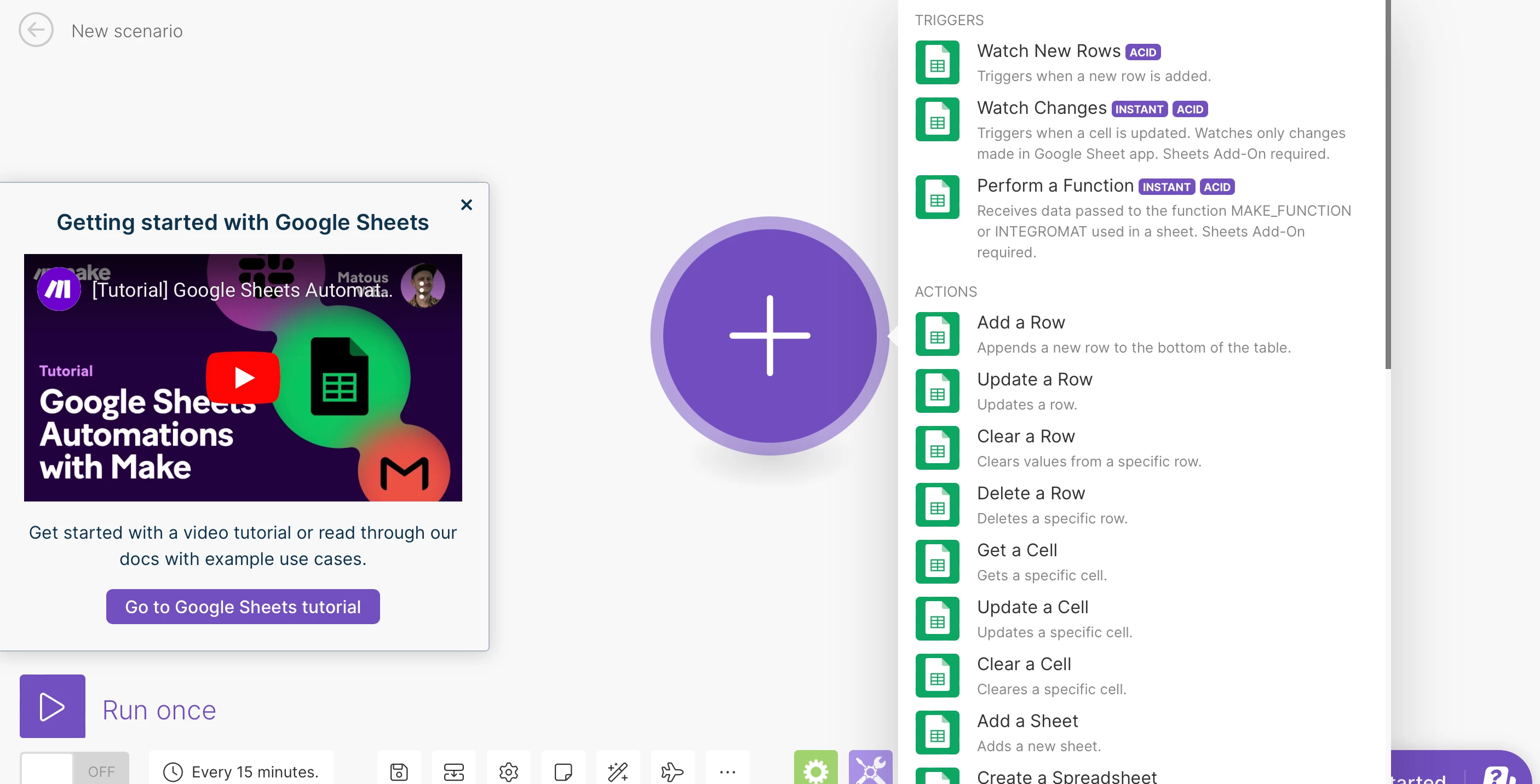

I just tried by signing up. I had a basic question, It says trigger is when I create a row, Does it even have an option for trigger when I create a new spreadsheet?

Yes, you would need to start with a Google Drive module to watch for new files.
  • Jun 15, 2023 10:49 AM UTC
You may also want to just export the final spreadsheet as a CSV file into a specific watch folder in Google Drive, and then use Make’s CSV modules to automatically parse the CSV file into Airtable. That would be an easier setup in Make.
