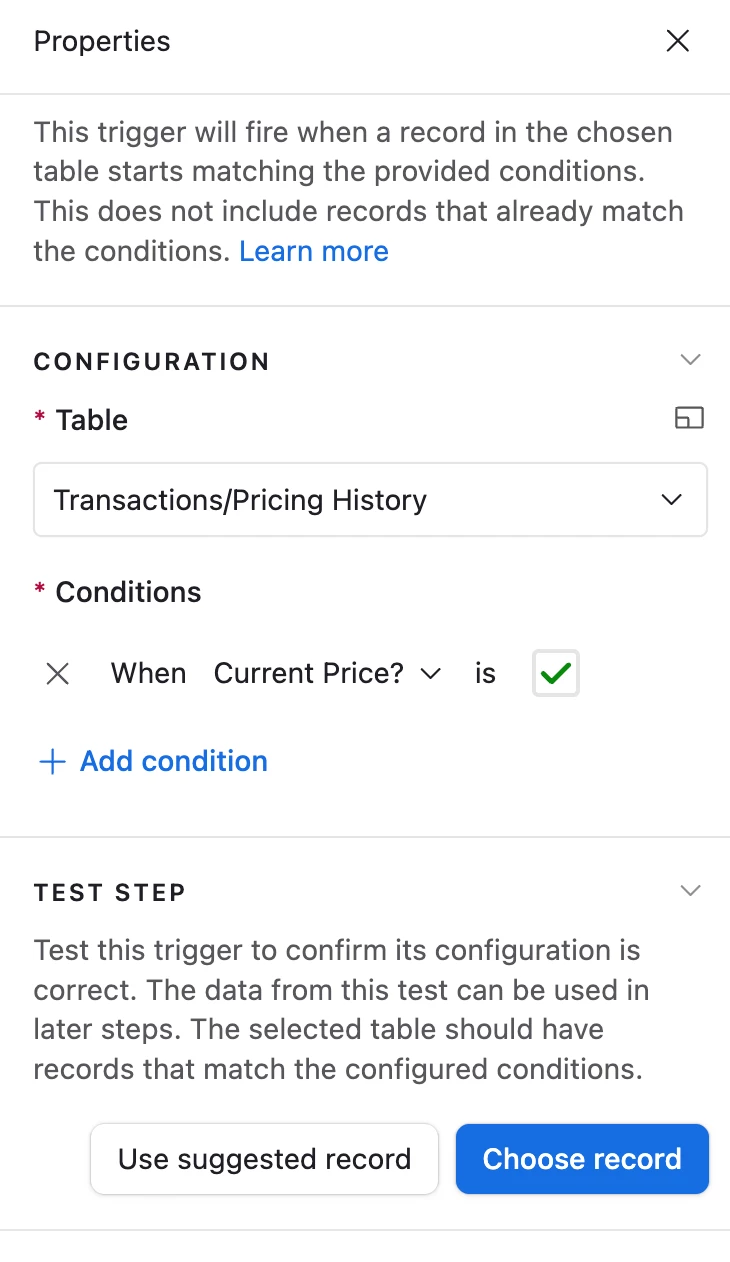

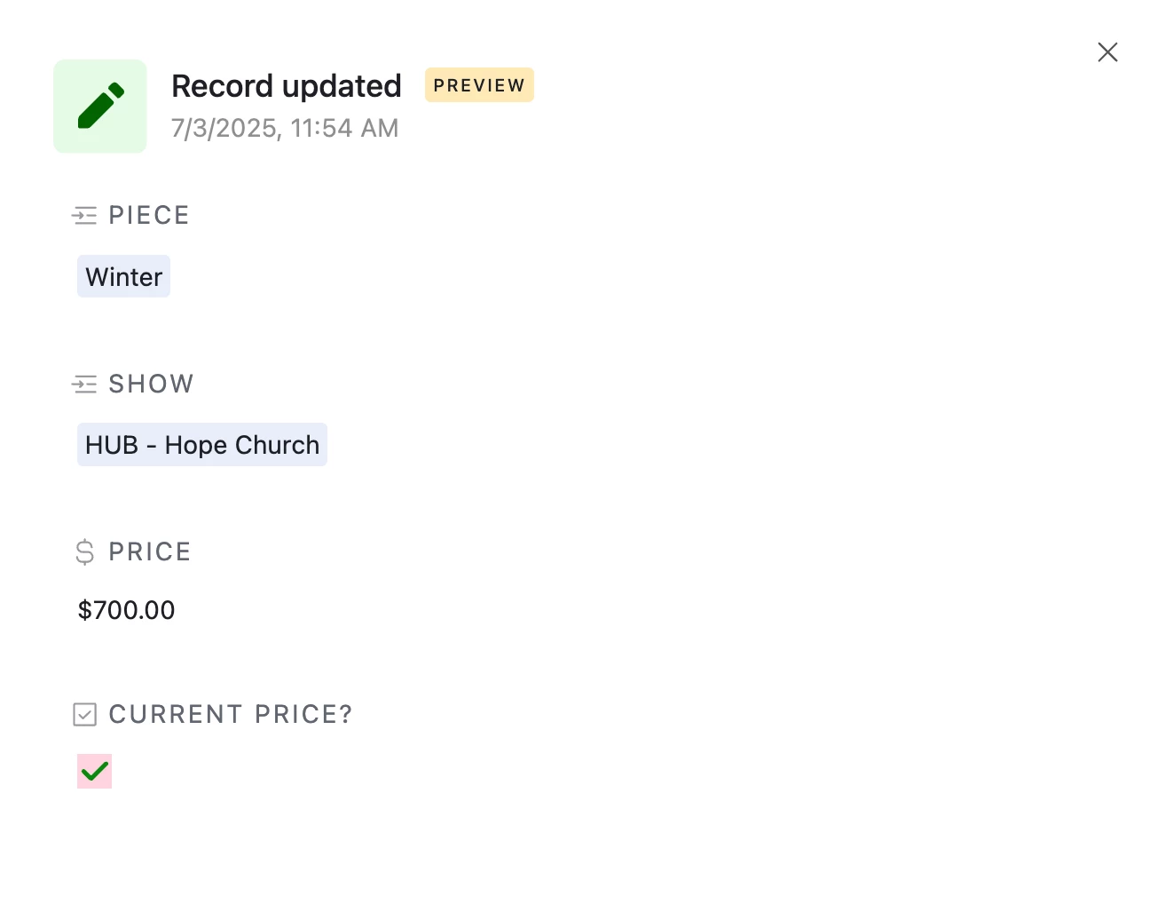

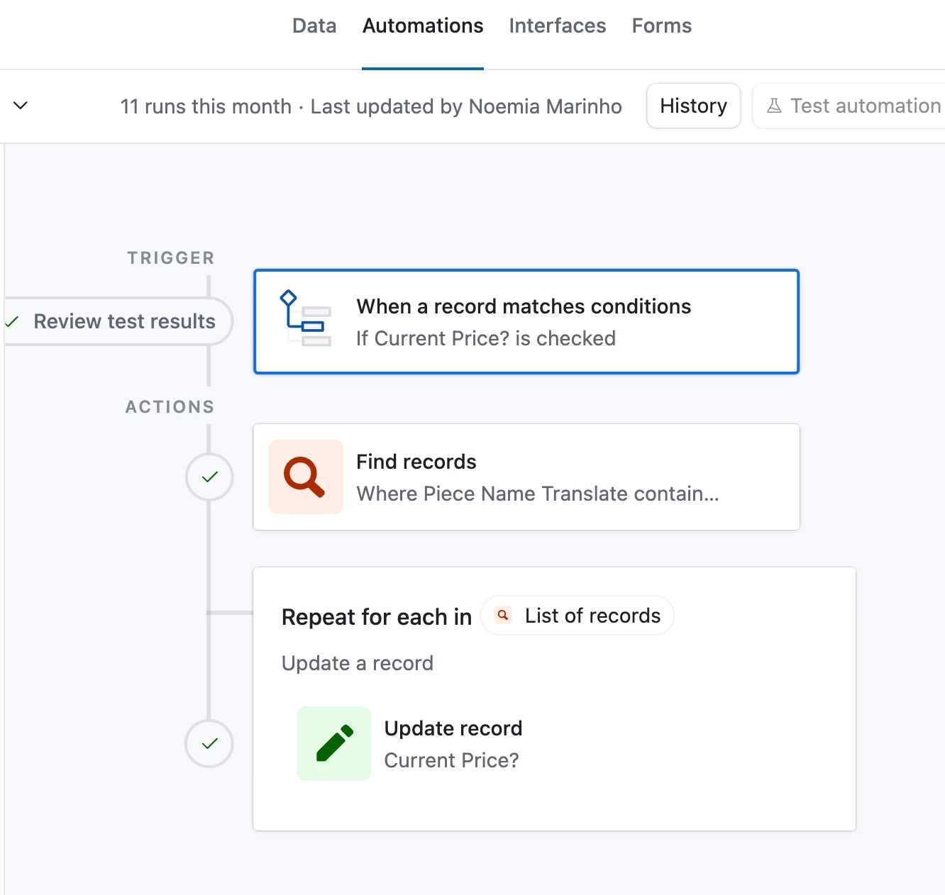

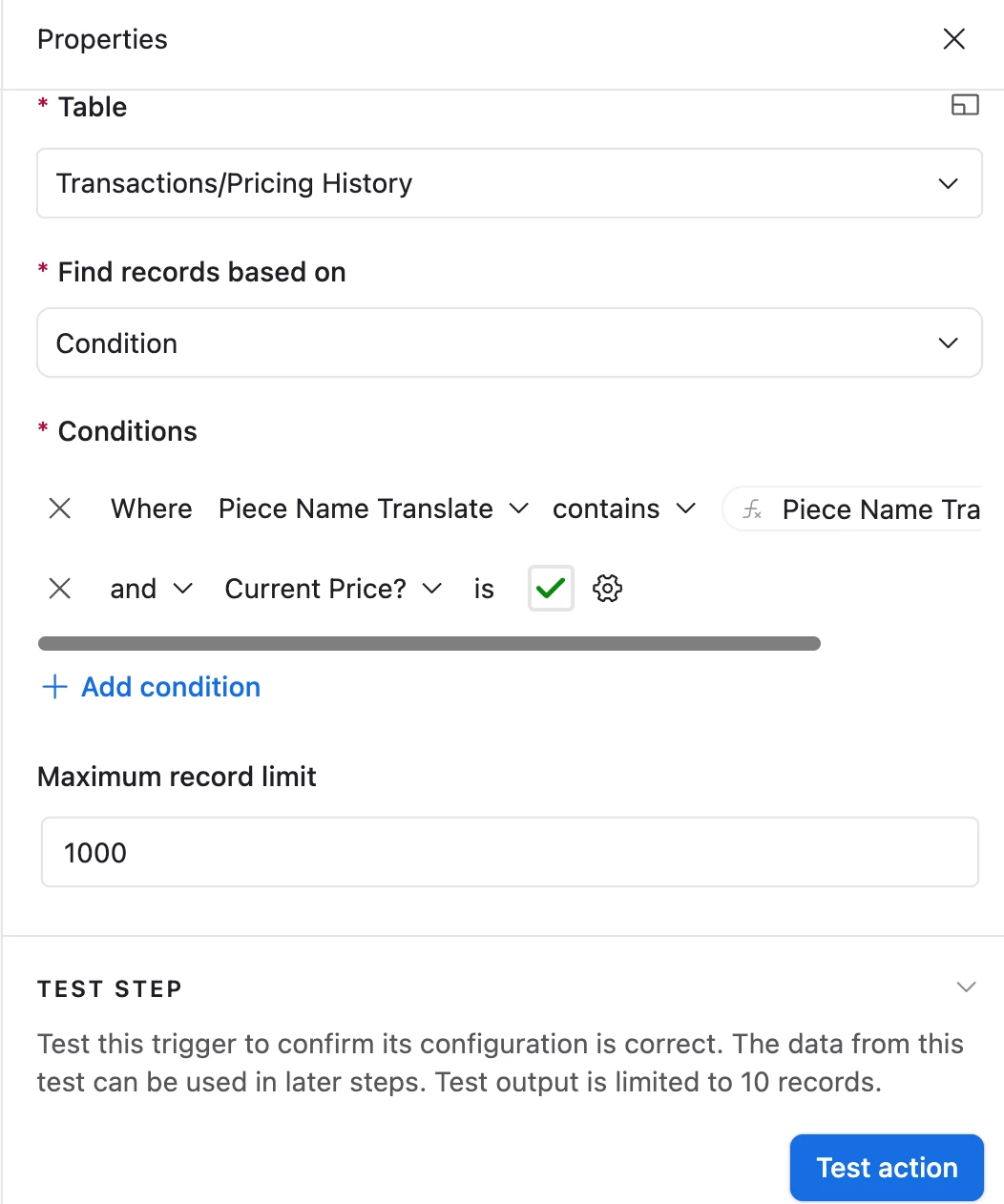

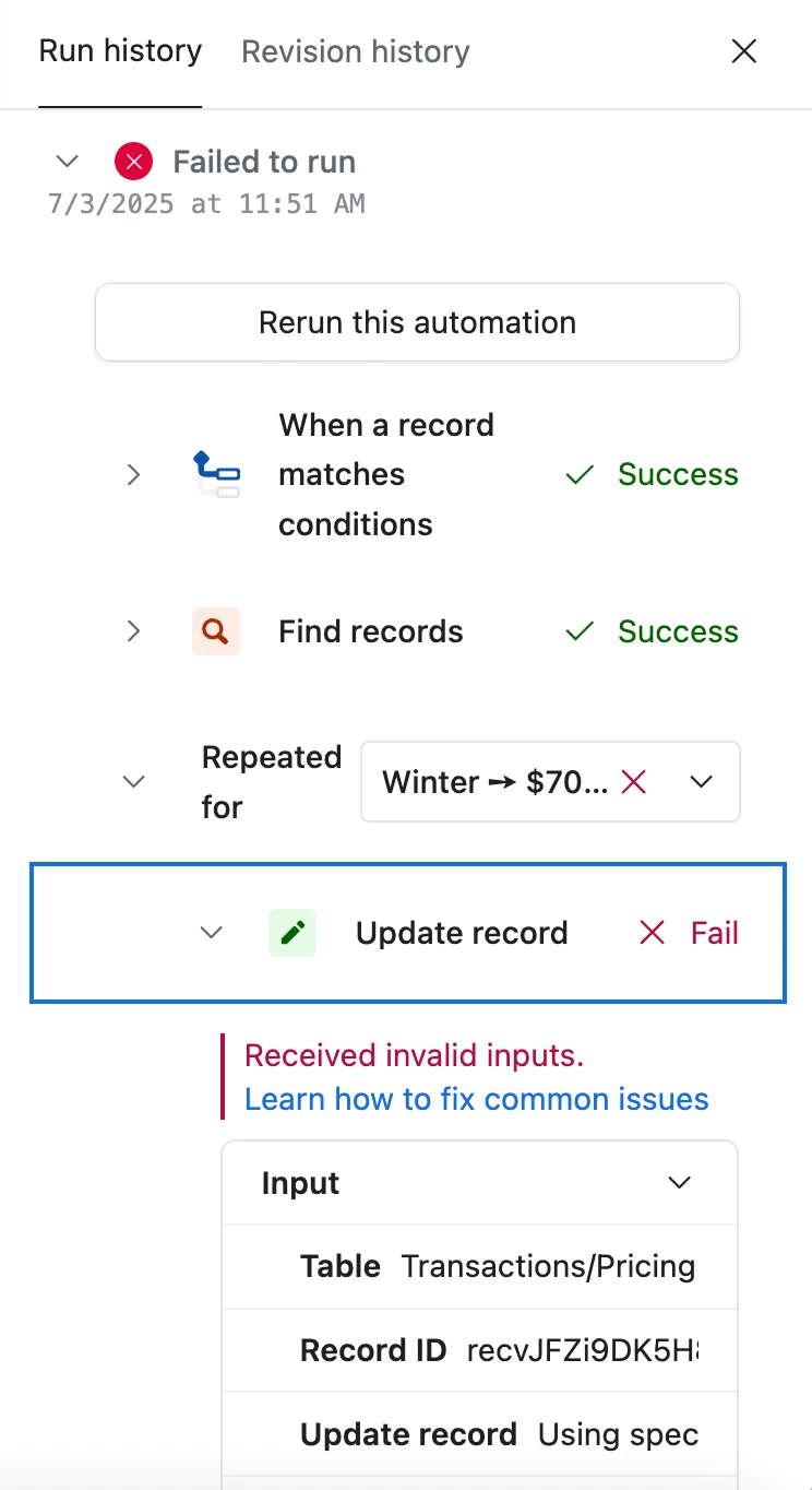

Hi all, did anyone end up figuring out a solution to this? I’m having the same exact problem, I’ve set up my automation correctly (I think), where when I check a box in my field labeled “latest price” it searches for previous instances of that same box checked for the same product, and I want it to then uncheck those other instances. I’ve got the find records piece working, and I’m pretty sure the record ID is correct (it’s the list of found records), but when I generate the preview it just highlights the checked box in red, but doesn’t uncheck it. When I turn it on and manually test it, it throws the “received invalid inputs” error… Any thoughts? Screenshots below:

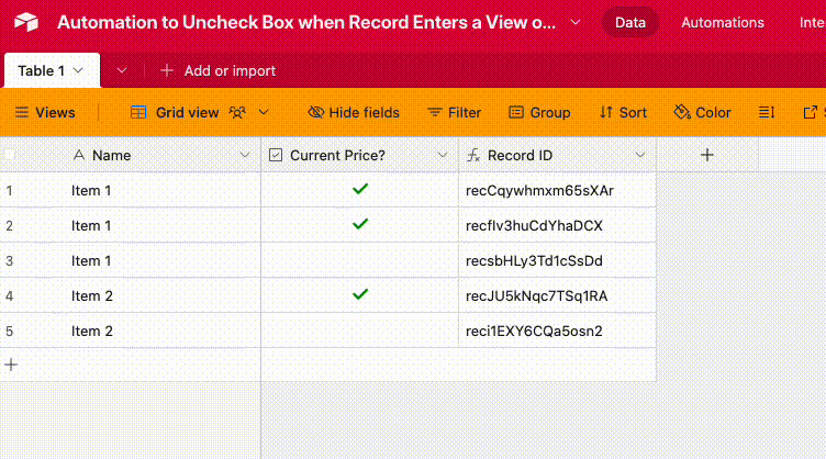

Does this look right?  If so, I’ve set it up here for you to check out

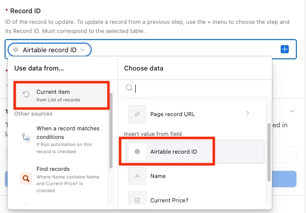

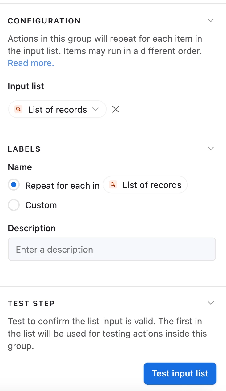

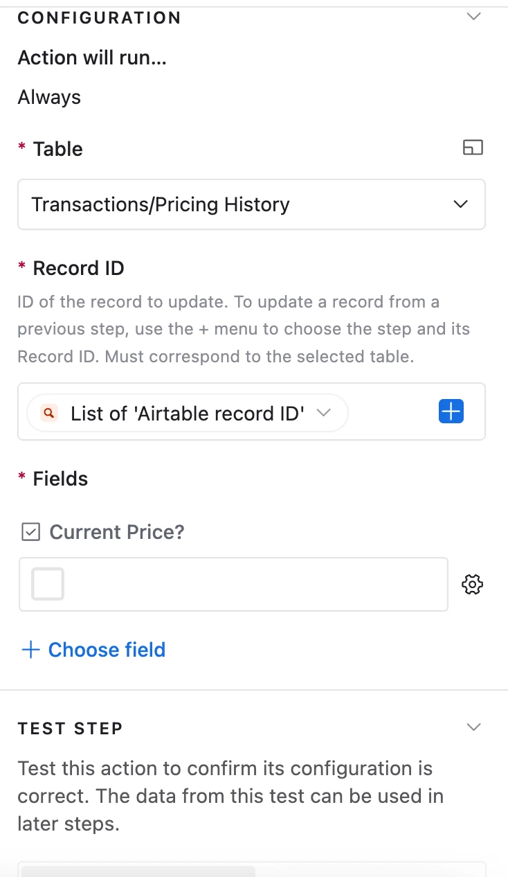

One of the issues you’re facing is the set up of the Record ID field; we need to use the Find Records result as the list in the Repeating Group, and then set up the Record ID like this:
I also added in another thing where it prevents the automation from unchecking the triggering record; not sure if that’s what you want though!
Forum|alt.badge.img+9
  • July 4, 2025
Thank you, ​@TheTimeSavingCo !! This works perfectly! I guess I’d missed that error in setting it up, and I’m glad you added a simple way to keep the automation from unchecking the triggering record, that was going to be my next quest, haha. I’ve just implemented the tweaks and everything is working beautifully. Appreciate the help!
