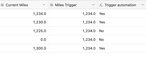

Try creating a formula field that'll check whether the miles value is within 5 miles and then using that formula field as your automation trigger?
IF( {Current Miles} >= ({Miles Trigger} - 5), "Yes", "No" )

Hmm, throw in an AND to check whether it's populated?
IF( AND( {Current Miles} >= ({Miles Trigger} - 5), {Miles Trigger} ), "Yes", "No" )
