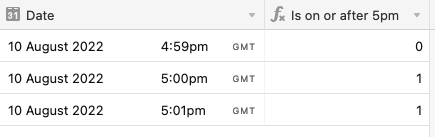

Hi @Strategy_Team, I’ve attached a formula below that will identify whether a date field’s time is past 5 pm. You’ll need to make sure that all your date fields are using GMT though; weirdness will ensue if you don’t
Lemme know if you have any questions about how it works

@Strategy_Team
Ahh fair enough. Yeah, with GMT +1 you’ll need to change that 17 to 16 and it should work fine for you
Timezone stuff always makes me go a bit cross-eyed honestly; I got a headache trying to figure out whether it should be 16 or 18 sigh
I put this together to figure it out, so I figure you might as well have it in case you hit any issues in the future
You’ll be able to get all the formulas after you duplicate the base

@Strategy_Team
