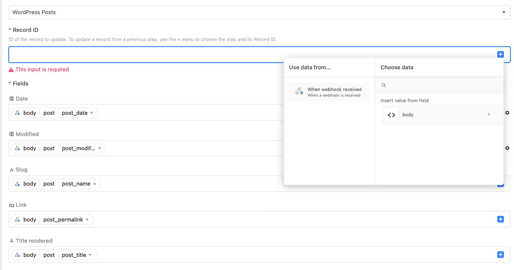

Hi all - I’m trying to run an automation using a 3rd party Webhook. When a new Post is sent live, or updated, in my WordPress site I want to send various bits of info about that Post to AirTable.
Everything works fine when I use ‘Create Record’ (so I know the webhook works) but obviously if I update the Post at any point it just adds it as a duplicate.
So what I want to do is use Update Record instead (I think?). When a new Post is created, add it to AT, if that post is updated, update the record in AT.
However - my understanding from this post Update record action failing (error: received invalid inputs.) - #3 by Brian_Nana-Sinkam, given what @Kamille_Parks says, is that I can’t use a Record ID from my Webhook e.g. Post_GUID. I need to use the AT Record ID. Which I don’t have available it seems.
Is the only way around this to run the script that Kamille posted or am I missing something? Seems like a weird ‘feature’ if AT designed things this way, so I’m hoping I’m misunderstanding something.

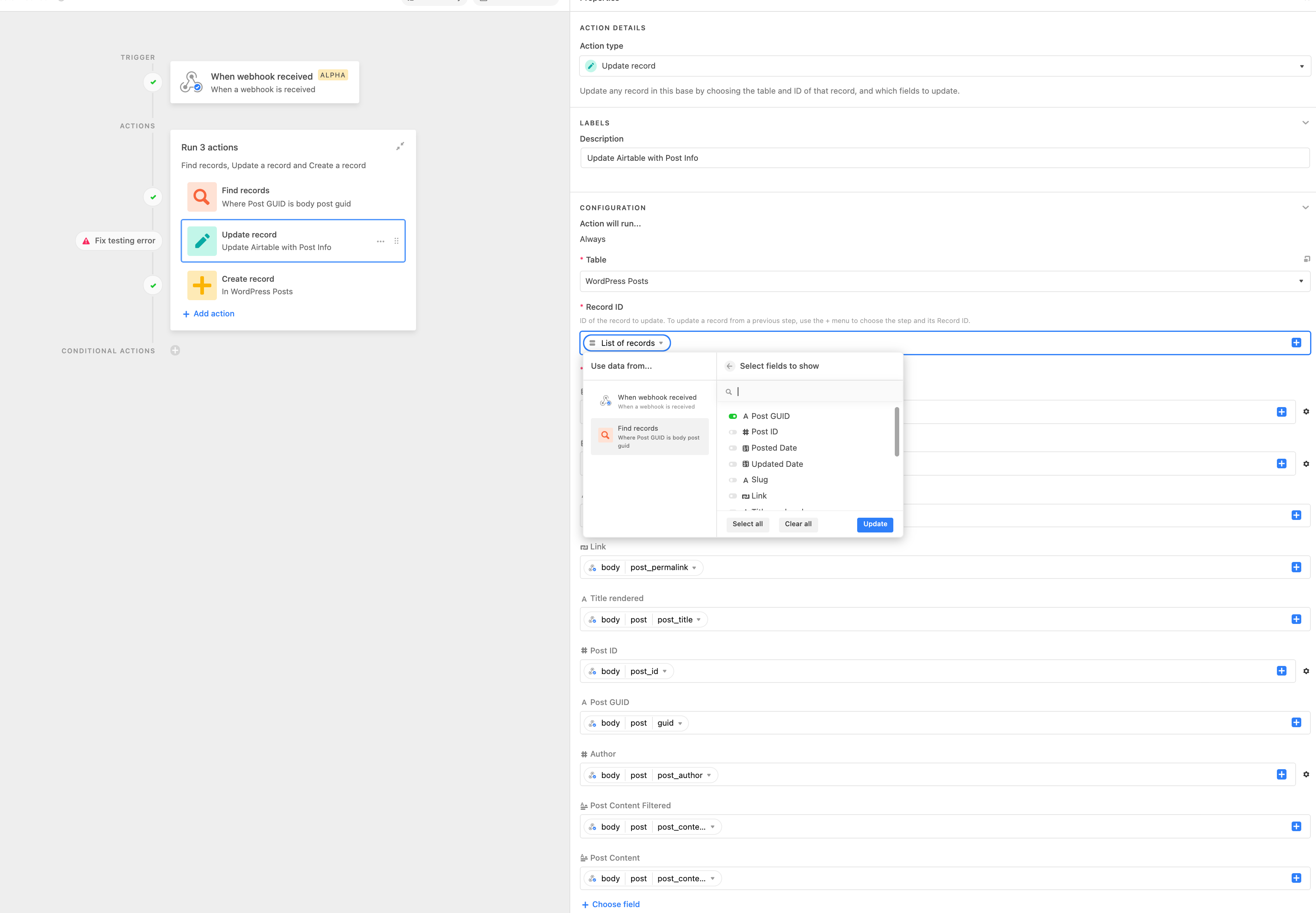

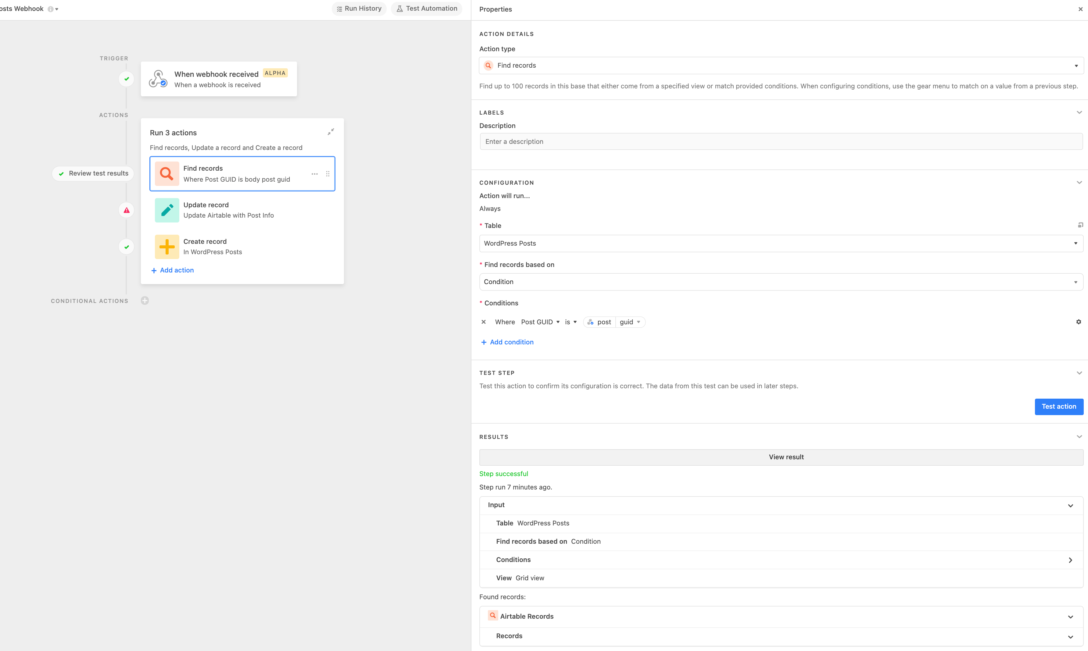

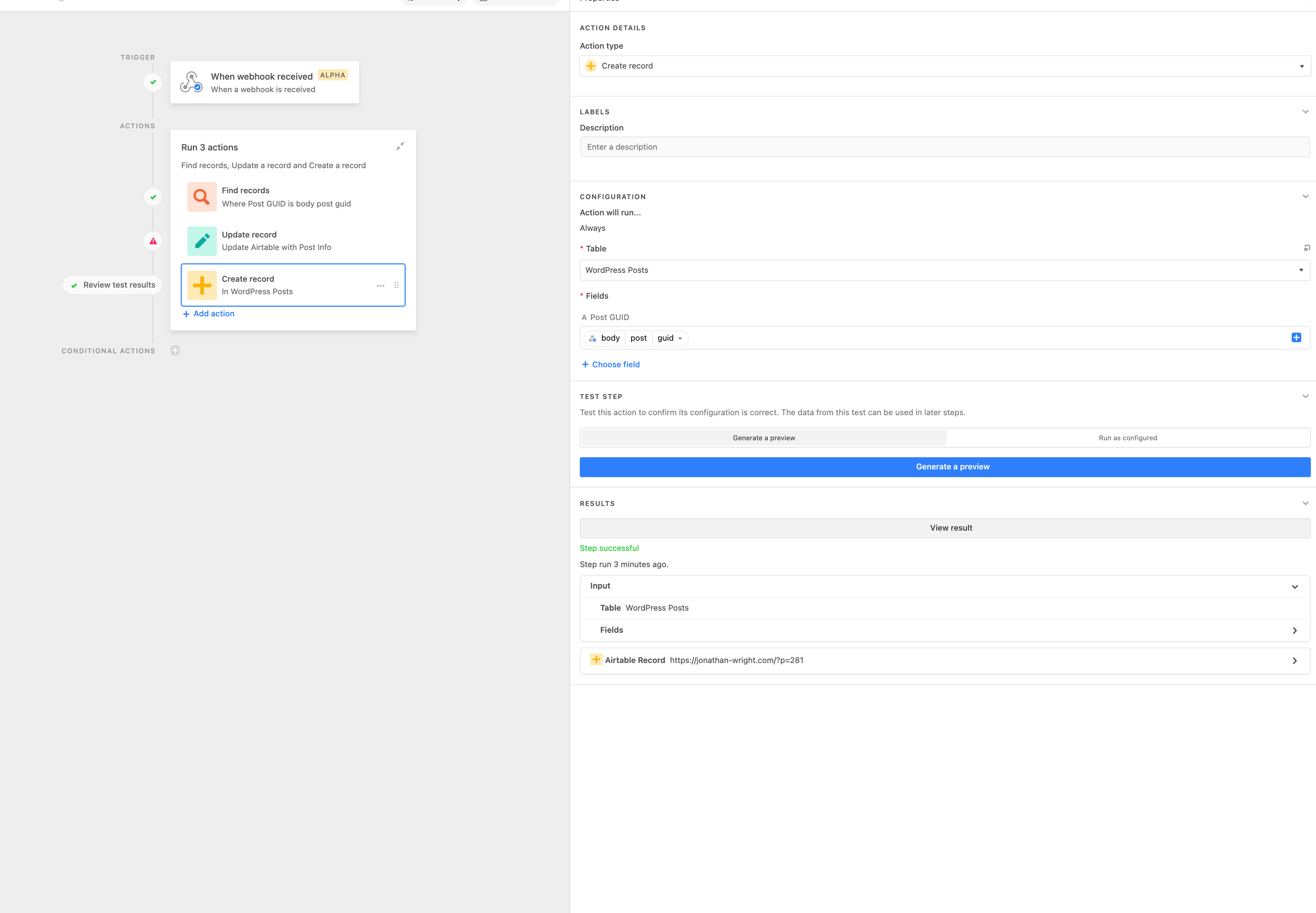

Hi Kamille - Thanks for the response but you have lost me there a bit, so hoping you can clarify.
I have a single webhook that is called on both post creation or post update. In my AT table I have both Post ID & Post GUID, I want to use Post GUID as it will be unique across multiple blogs (Post ID isn’t). My table currently has no data in it, I haven’t pre-populated it with existing posts.
Here are my screenshots of me attempting (badly) to implement what you’re saying:
I think where I’m getting most confused is the ‘conditional actions’ parts of your response. I can only see the option for conditionals on the Find records action type, not the others.

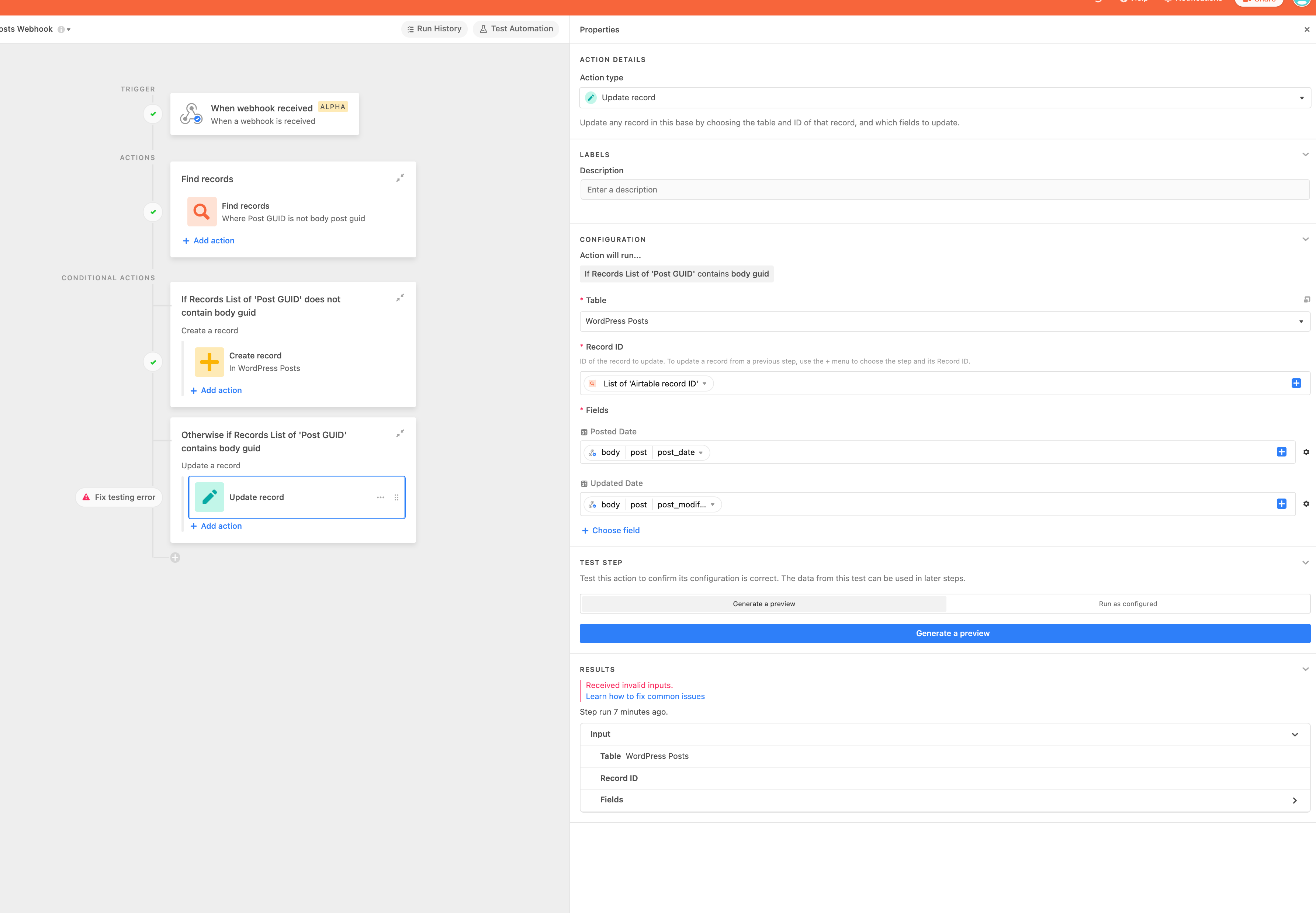

@Kamille_Parks - Sorry, I think I’ve kinda worked out what you mean now (now I’ve spotted the conditional actions section in the UI). This is where I’ve got to. The last step, update record, is still causing me issues though.

It may be the conditions set on the various actions
It looks like your Find Records step is looking for records where {Post GUID} is not the same as the webhook. Shouldn’t that be {Post GUID} = (or contains) webhook GUID?
Your first conditional step’s condition would be “if [Find Records > List Properties > Length] = 0”
Your second conditional step’s condition would be “if [Find Records > List Properties > Length] = 1”

Thanks for all your help Kamille, I think I’ve (you’ve) cracked it.
