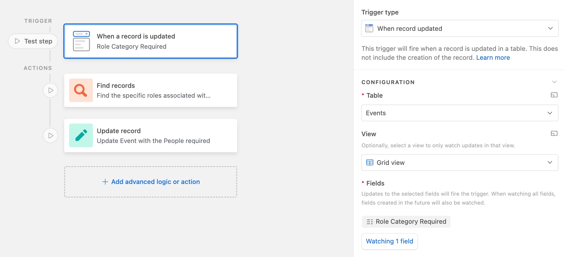

Steps:
  • Enter a role required to be at an event
  • Finds people associated with that role
  • Updates people required at the event
When I delete the role required, the automation seems to run twice and deletes the people required, but then adds everyone associated with that project, and when I check the Run History, it only runs once.
Any idea what's going on?  Thanks in advance

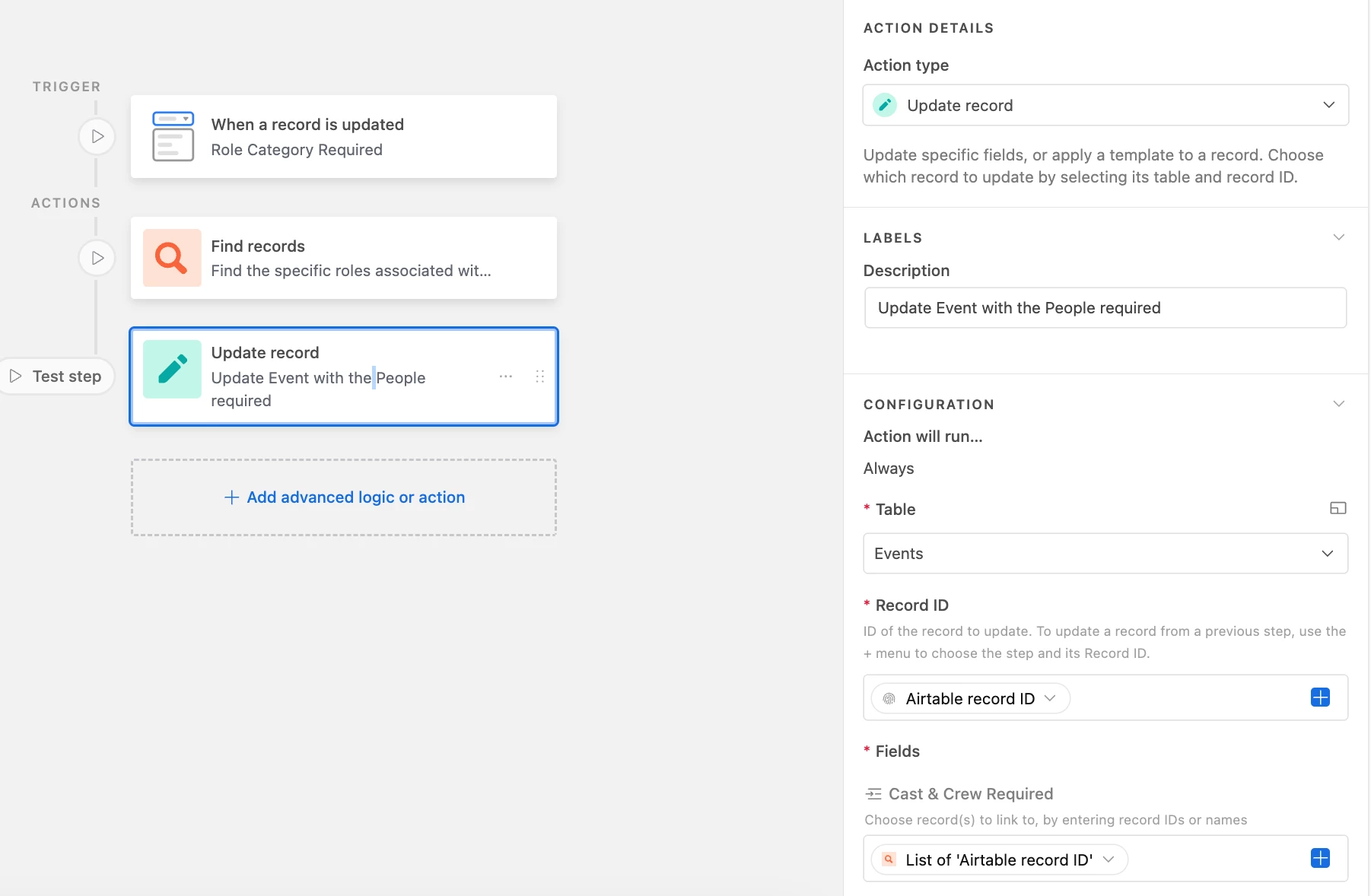

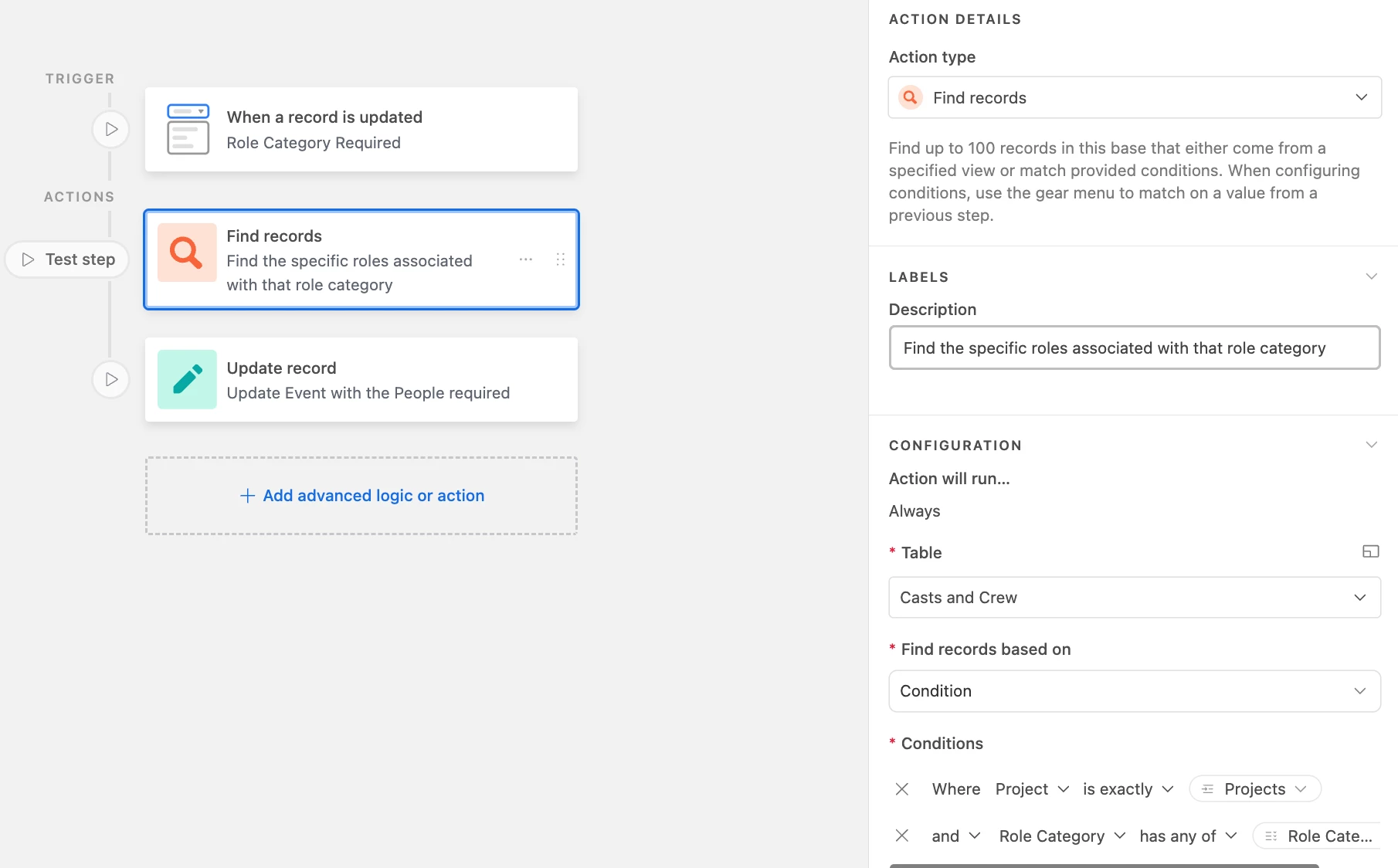

I don't think you can see the Automation, so I added the screenshots here
Thanks for your help.  🙏
Thank you very much for the automation screenshots as well as the link!  I think the issue might be occuring due to the fact that, when we run the "Find Records" step with the "Role Categories Required" field empty, it returns everything in the "Casts and Crew" table
To overcome that I've created a conditional that checks whether it's empty, and if it is it'll just clear out the linked field:
Link to base
Should do what you need now I think!
Link to base
  • Apr 21, 2024 11:32 AM UTC
LOVE IT!!!
I was thinking it was a conditional logic thing, but I couldn't find it.  Thanks so much!  ✌️
