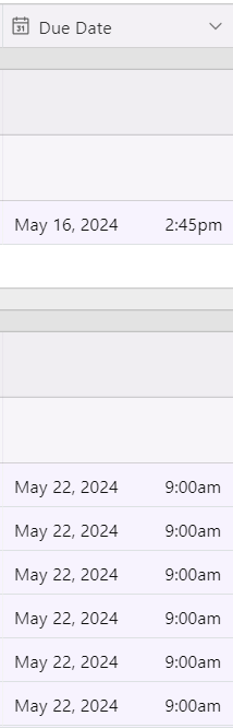

I have a "Send an email" automation set up with the trigger "when {{Date field}} is one week from now."
It's working great, except the emails are going out just after midnight. I'd prefer them to go around 9am. I have added a time to my date field, but that does not seem to work.
Any advice?

I would add a field that is datetime_diff(duedate, now(), 'hours'), then when your hours_till_due  = 168 (hours) send your email.  Then you can send it out at 9AM.  If you change that due time to noon, it would send those out at noon.
Thanks Dan! I thought something like this would work, was just hoping there was a native option using the time within the date field. But this workaround will do!

Since I first responded I learned about IS_after formula.   See if that works for you.
