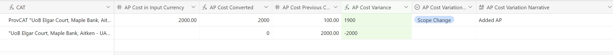

Sorry to add move detail here is an example for just one cost centre in the BoM table:
However, there are 10 cost centres

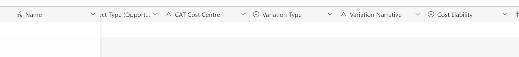

This is "Chargeable Costs" table:

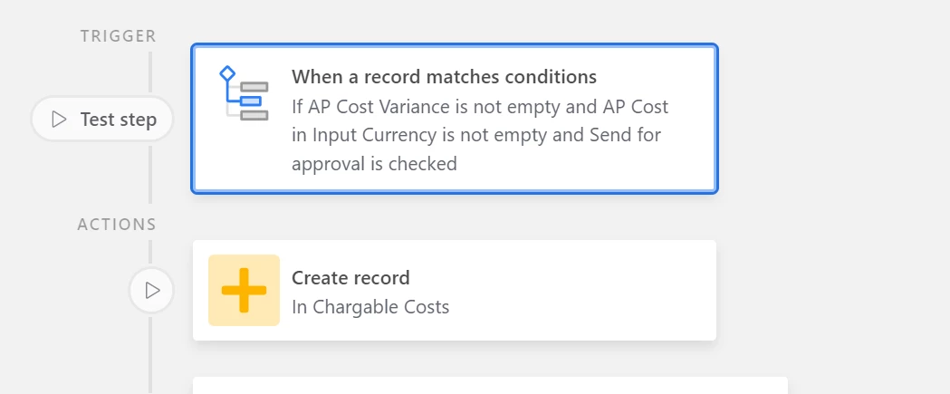

It is easy to write an automation to move one cost centre over - the trigger can be:
What we cannot do is then have one automation repeat this for the other cost centers. Obviously you could do 10 automation but burns though the 50 limit.
